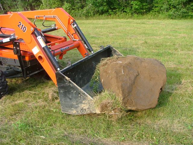

I can tell you, by far the most cost effective investment I have ever made in any attachment has been my tooth bar…..
Attached is one of many “rocks” I have dug out using nothing more than my FEL with the tooth bar.
Gary

/ Tooth Bar or not to tooth bar #9
</font><font color="blue" class="small">( “rocks” )</font>
Right. What do you classify as a boulder? /forums/images/graemlins/grin.gif
And the question of the toothbar, it saves your bucket edge too!
-Mike Z. /forums/images/graemlins/grin.gif

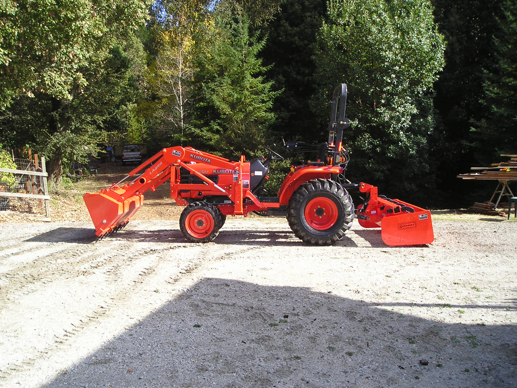

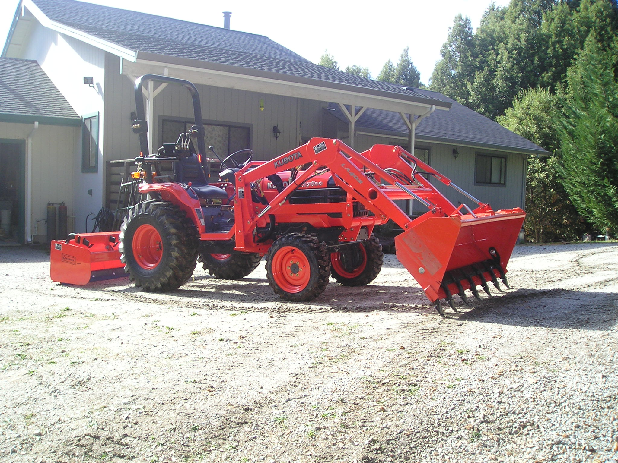

I wouldn't buy a Kubota for boulders....We have solid granite in these parts but most of the big stuff on my property has already been dug out
Here's picture a 60 inch woods toothbar....
Really helpds save the edge of your bucket....Can be taken off in 5 minutes...I keep the wrenches in my toolbox under the seat
