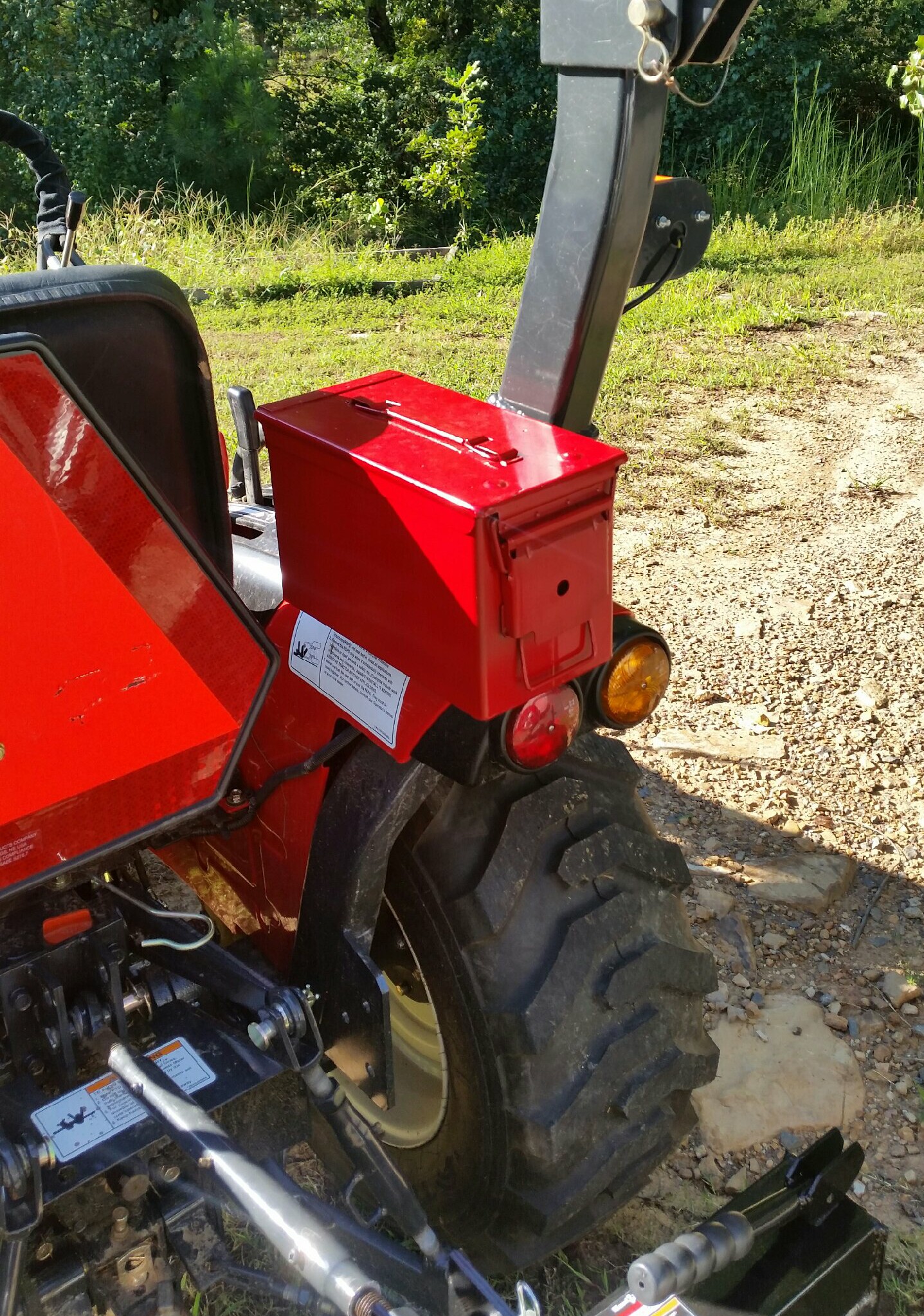

My simple one from mil .50cal can. I put fender washers on the inside, rattles a little, but not bad. Don't hear it over the motor. Would prob put a full length stiffening 1/4"x2" plate in place of the fender washers would help a lot, but it hasn't messed up yet.

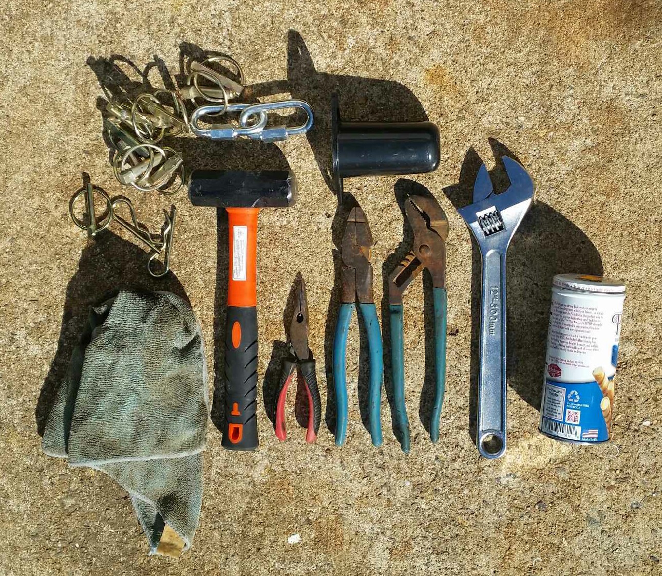

Here's the junk I carry in mine. Small round tin has plug/inflation kit in it. It's "full", but it all fits. I'm not usually very far from my truck, or I'd have put a larger one on as well.
I plan on adding an expanded metal panel across the ROPS, and will have a rear bar to mount a larger box more firmly at that time.

I carry about the same, but I have a large crescent wrench and monkey wrench for connecting up the baler - large bolt. Also a can of WD 40, a small role of bailing wire, role of duct tape, small grease gun, and one 10' 5/16 chain. I probably carry too much stuff and should leave some on the tool shelf, but with my senior moments, I would get out to the equipment yard and forget to tool up and need to walk back to the shop. Probably do this twice as I always forget to get one item. :confused3::confused2::laughing:
