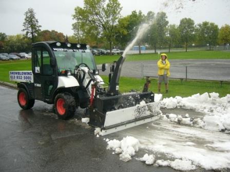

I have a 72" to which i added a pull blade and extra hydraulics. I do notice the extra weight of snow but it is not enough to make a difference.
