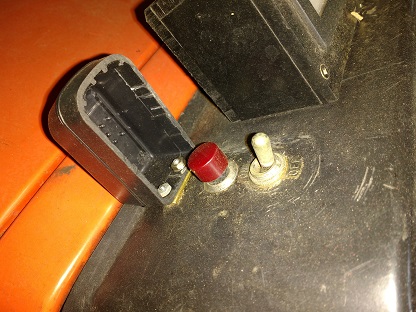

After having watched farmers in my area lose a couple of days in critical haying season over these safety switches not working (it usually happens on weekends) and experiencing a few episodes myself on a BX23, I installed this. The red push button switch will start the engine regardless of safety switches, and the toggle, if switched forward will not allow the safety features to kill the engine.
Safety police, fire away. I'm 70, have farmed all my life with tractors that had no safety switches whatsoever, and I am living still. If manufacturers want to install these things, then make **** good and sure that they are the last thing to fail.
The wiring for these bypasses will be different for each model tractor, so you will need a schematic. Also, do this at your own risk.
