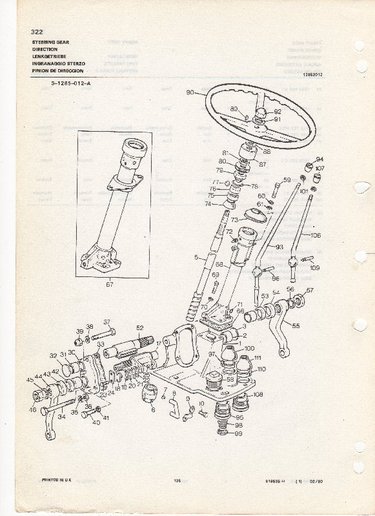

I have a 1955 TO35 which has started leaking steering gear oil out the top of the steering housing(tube) under the steering wheel. It does not have power steering. I had to destroy the steering wheel to get it off. Was going to replace the top seal. Went to the MF dealer and they don't have the seal in stock. Someone there suggested replacing the steering lube with zero viscosity corn head grease. I plan on tryin this but don't see where to drain the old lube and where to refill. I have a service book I got at TSC. It speaks of rebuilding the steering gear and refilling it, but doesn't show where or how. Can anyone help me on this?

i've rebuilt alot of steering boxes on alot of different tractors..... but havn't had my hands on a fergy past the ones that have steering like a 9n/2n. if hte 35 has a seperate box like an 8n, then you may have to pull whatever it has for a sector cover off to clean it out.
post a diagram of the steering box and I can give you pointers.. many times those dual sector steering boxes just use some sort of worm gear setup and a couple thrust bearings.. some bushings and sector seals. not much to them... I've rebuilt dozens on ford tractors...
/ TO35 steering leakage #3
Unfortunately, there isn't a plug to drain out the old lube, you have to take the steering box apart and remove the old lube, the hard way. Cornhead grease will work just fine. Your steering box should resemble mine, shown below.

Thanks for the replys. I did find the fill plug on top of the steering housing. I have used a hand pump with a small tube to pull on about 8 oz of steering lube. Will continue to try and get more out. After I do this I plan on pumping in the corn head grease with a grease gun. Do you think this will work. Do think I can get enough of the old lube out this way?

/ TO35 steering leakage #5
the heavier grease will make the lighter gear oil float and be pushed out as you fill with grease.
oil out the top tells me the box may have been full or had water in it displacing the oil..

So- my TO 35 has been steering fine until now - the cooler weather (0degF) has limited my steering to right turn only. I also noticed oil leakage from steering column. I found, upon studying the parts diagram, that the ball nut travels downward on left turns. I surmised that there may be water displacing oil in the closed gear case, & upon freezing- limited the turns to the position it was parked when warm, then only to the right from there. Not finding a drain hole, I used the cast boss on the LH side of the gearbox, down low, but still above the mounting flange, Drilled a hole into the gearbox with an "R" drill, immediately tapping 1/8" pipe threads, allowing the water, then oil to flush the cuttings out of the hole. I let it drain overnight, then forced EP023 grease into the hole & put a pipe plug in before much grease forced itself back out. A couple of things worth noting- I don't think the case drained completely because I probed the hole with a pick and could angle downward with the tip in the hole, also, I did not know the fill capacity, so I used the capacity of my grease gun shaped suction gun, to deliver the contents into the hole. So far none has run out of the top, but until I remove the battery box it will have to suffice. Did take pix so if anyone wants to emulate the fast fix, then I suppose I could post them.
