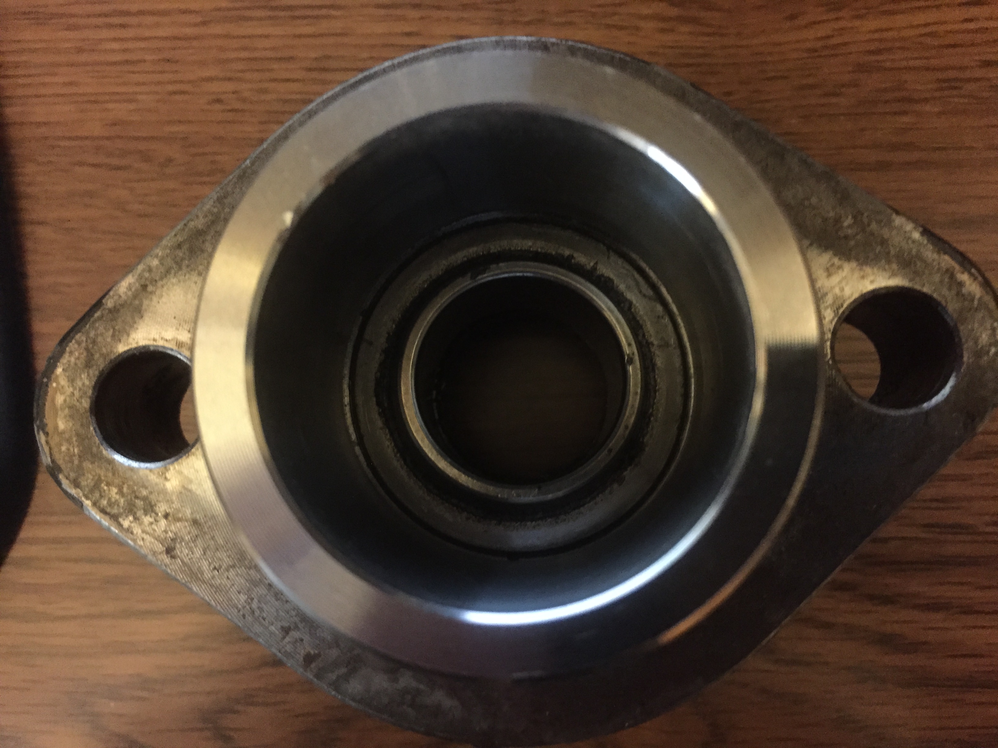

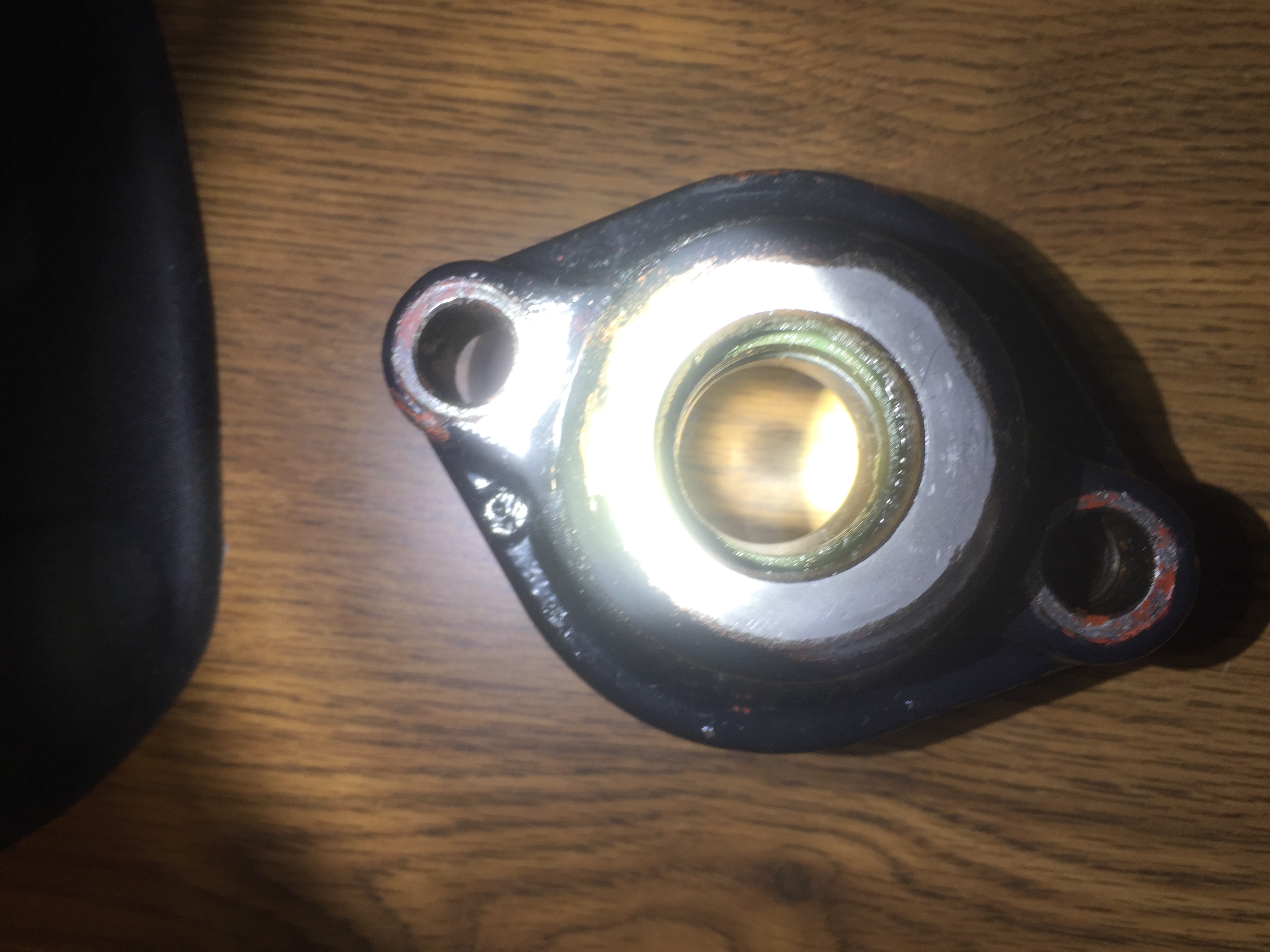

   / TN75 Hydraulic Leak at 3pt and resevoir #30
Well I attempted to replace them this weekend. The Circlip (keeper ring) was no problem, it took about a minute to remove them then I got to the bushings. Those things are in there. We tried several things. Pounding, putting them in vice to push them out and couldn't get them to budge. Beginning to think they are welded in but know that's not the case. Maybe I need to get more physical with them but I've been a little cautious not to bust the support. I guess sledge hammer is next. Any other suggestions before I get so physical? image1.JPGimage2.JPG
