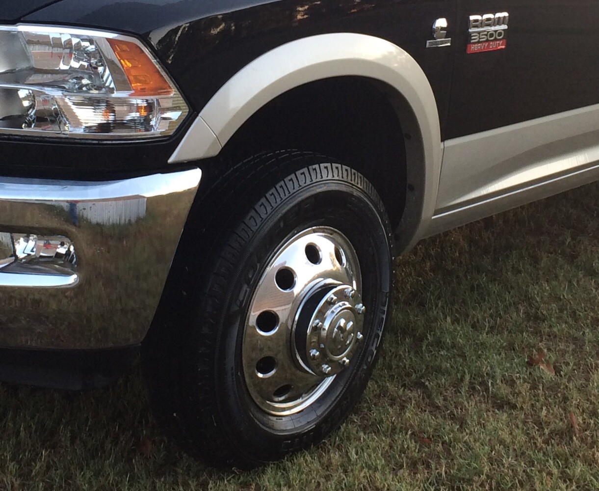

I'm running the Cooper HT3 on my dually now.Not much difference in the all-Terrans to the highway few little grooves not much good in the off-road area. image.jpg
I run the Firestone Tforce ATs last and don't recommend them...

I have the Firestone Transforce ATs on my Dodge 2500. I think they were put on the truck before I bought it. 24,000 easy miles and still a fair quantity of tread. We occasionally get 4 round bales (1,000 pounds each or less) on the equipment trailer and 2 in the bed of the truck. The hay guy is only 5 miles away. Square bales can be 40 miles away. Anyhow I have no other tires to compare to. Sample=1, not lots of value in that small sample set.
