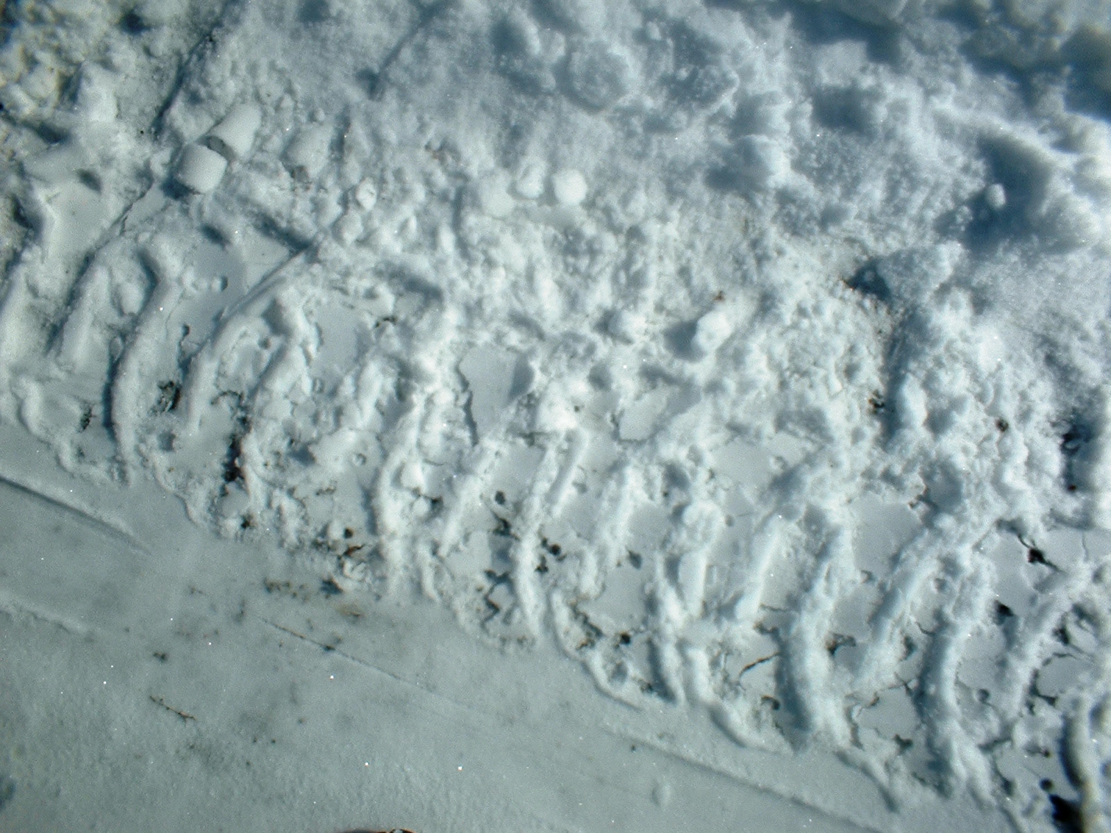

I have about 4km of roadway that I keep open all winter in my resort. Because we are located on a hillside overlooking Doe Lake, some of my roadway is up a 10% grade. Prior to installing studs, I would have to race up the hillside and blow down grade, now I can blow any depth of snow backwards uphill with no slip...in fact, I also blow some areas across grade with no side slip! The studs I used are 1/4" ice heads with a threaded shank of 1/2". I have taken some photos and posted them on the gallery. The R-4 tires will show virtually no wear when the studs are removed in Spring, they are inexpensive and are "set and forget" each fall. So far I found no downside to installation and use! i also photographed a track in the snow showing the stud imprint going uphill with no slip.

I've posted some pictures on the members gallery, I don't know how to attach them here...I will say that my roadway heading uphill has a steep side slope at the ditch and, before installing the studs I would risk sliding over the side which would cause the tractor to flip:( The fender clearance on my new M59 is very tight whereas my old 35hp Massey Ferguson could accept chains without a problem of interference whether they were tensioned or not...the studs just offer an inexpensive solution and I can attest they work incredibly well under all the conditions I have put them under:thumbsup:

If your tractor can accommodate chains, it's probably the best first choice.....they are fairly easy to install and remove, offer great traction, loud when driving with possible frame slap, and become cost effective given the length of time used over a period of years.....
that being said, my M-59's fender clearance would not allow for chains without causing damage to the body or frame.....studs are cheaper, amazingly effective, quiet on roads with little damage to surfaces driven on.... I placed 3 studs per lug on R-4s.... you will lose some with wheel spin through the winter..... there hasn't been a downside in my opinion
