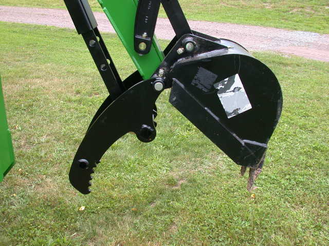

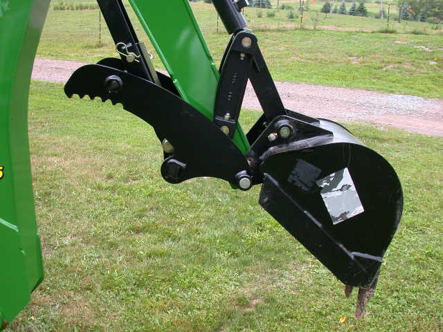

Here's another thing I do, I leave the loader and BH on and I move them into positions where all the pistons are contracted. (the BH is straight up in the air and the loader is on the ground with the bucket facing down. I figure this pushes all the old oil back into the tractor and is better than leaving them off where it is impossible to get all the cylinders completely contracted.

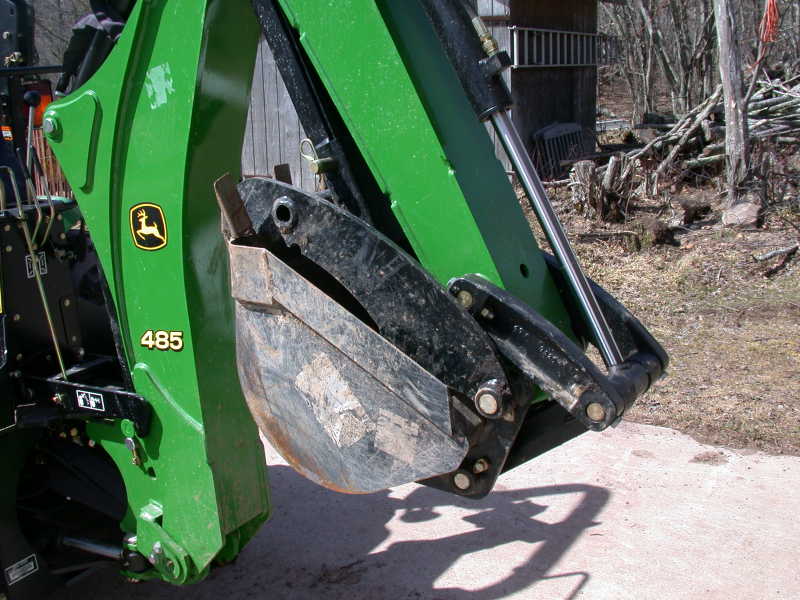

Here's some shots of the thumb the first one is in the max out position and the next is most retracted:
Rob

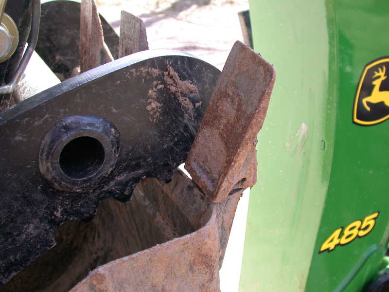

/ Tips for 3x20's 50 hour change #4
Rob, thanks so much I'm actually looking for pics of the bucket curled tight to the thumb. Both with the thumb retracted and fully extended. I'm trying to fab the arm for the factory thumb with my 448. And pics would be super helpful. Good idea on keeping the filter. I think I had metal shavings in all my fluids initially. The filter I held off changing was the inline hydro filter and I really wish I hadn't waited so long. I was having this intermintant cavitation and it turned out to be the inline filter had the end break off and block the suction side of the filter. The odd thing was when I picked up the replacement it was a bit smaller. I asked the dealer about the size difference and he told me they had issues with the manufacture of the original style. I think it was around $50 but I would have like to avoid the cavitation and possible pump damage by replacing the filter sooner.

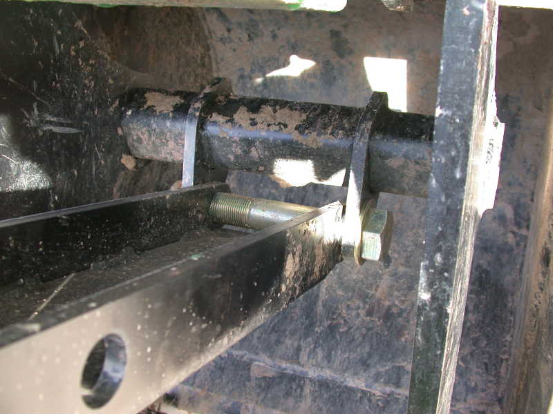

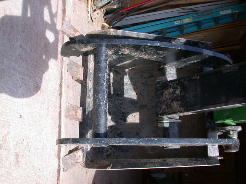

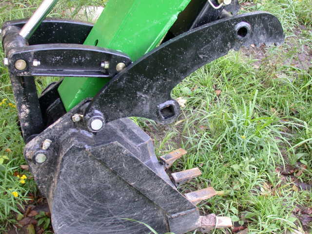

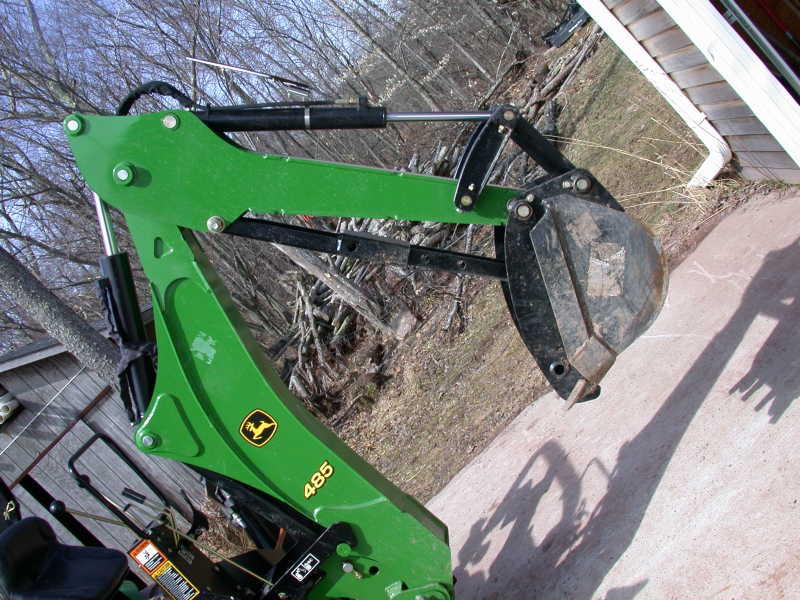

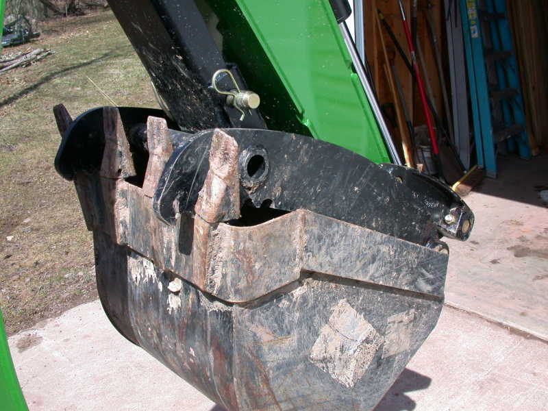

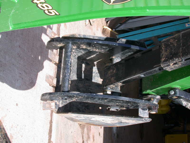

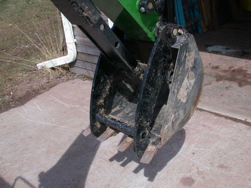

Matt,
Here's some photos, let me know if you need more.
Rob

/ Tips for 3x20's 50 hour change #7
Rob, thank you so much for all the pics. It has been super helpful. Oddly enough none of my local dealers are stocking BH's anymore an one didn't even know of the thumb option. Did you get any pic of the new light install you mentioned in the other post? I've been wanting to add them to the rops but since I almost never use my tractor at night I've back burnered it.
