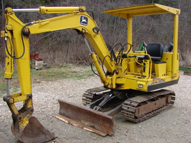

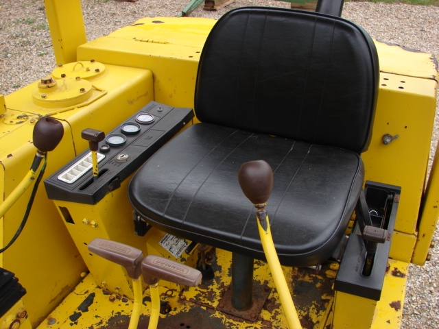

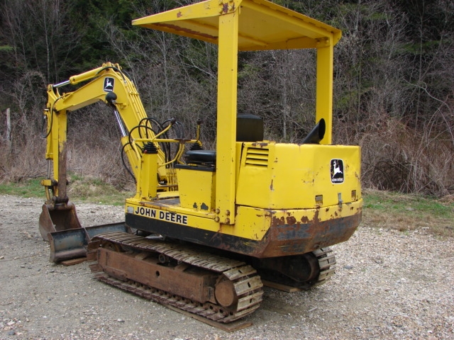

Thinking of buying a mini to use around the house. I need to install some french drains, reditch old ditches, and pick some stones from the field and carry to the hedgerow. I will also be installing some small culverts in logging roads and transplanting about 50 6' pines for landscape purposes. It is the equivalent of a Yanmar YB301, it has a new hour meter so exact hours are unkown but assumed to be "a lot". Here are some pictures

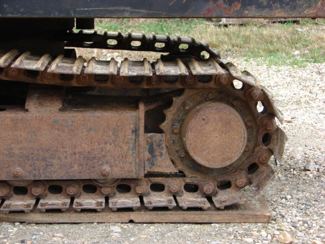

Looked at the closeup of the sprocket--
That machine is well worn and will want to shed the tracks.
Check the chain roller bushings and you'll probably find that they are very oval shaped matching the worn sprockets.
Pads look fair suggesting that the machine did not see much stone work but sprocket deffinately show mileage.
I have operated that model and it works nicely but track/sprocket is pricy.
Might still be a good buy (depending on price), but be prepared to loose a track from time to time.
You would need to avoid sharp pivoting turns and know how to get the tracks back on should you drop one.

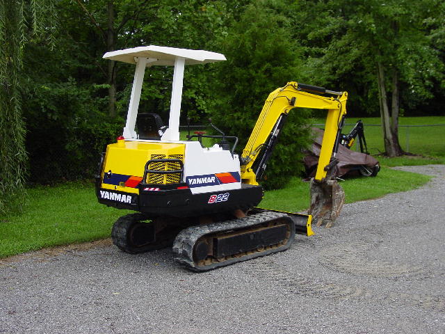

Just as a reference, I sold my Yanmar B-22 4-5 years ago for $10,000. It had good or better sprockets, good rubber tracks, new pins and bushings and a fresh paint job. Less than 1200 hrs. It was several years newer model.
