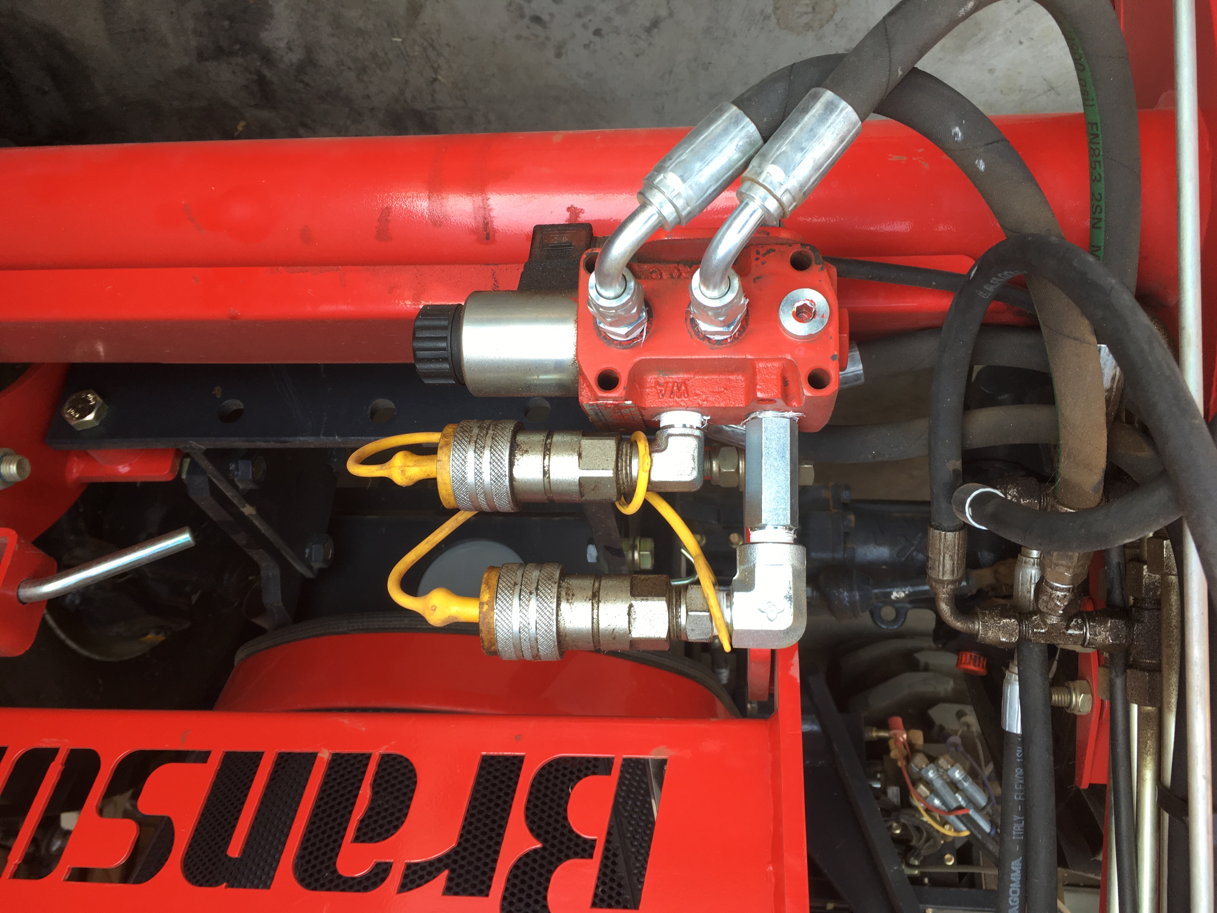

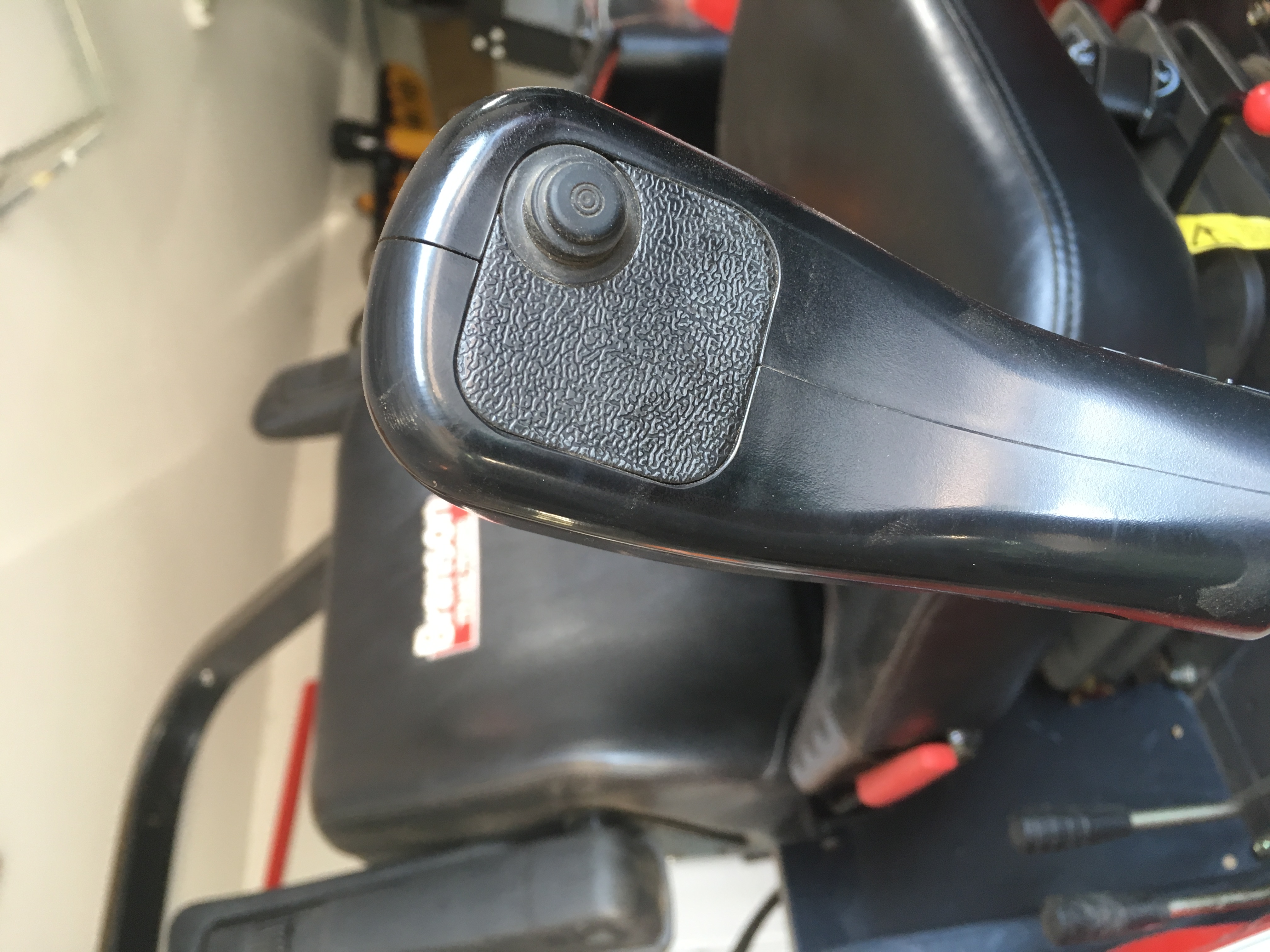

The branson factory 3td function diverter kit includes a new FEL control with momentary button on the backside. When the button is depressed, the bucket curl function now becomes the 3rd function for grapple etc. I've found no issues with it whilst working with brush, trees, and even a carport demo project. IMG_2711.JPGIMG_2712.JPG

My only concern was not going with a full 3rd function but the diverter has never inhibited me in any way that I could tell, The momentary switch makes it so quick to change between functions and the cycle times are very fast.

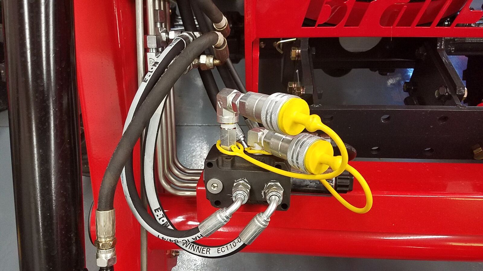

Thank you for the photo Warsign. That looks good. How have you used it? Do you have any regrets over a traditional valve?

I have yet to buy a grapple, so I don't have any input as far as functionality. It is certainly on my list of items to get. The price point of $625 US installed was an easy sale, regardless.
