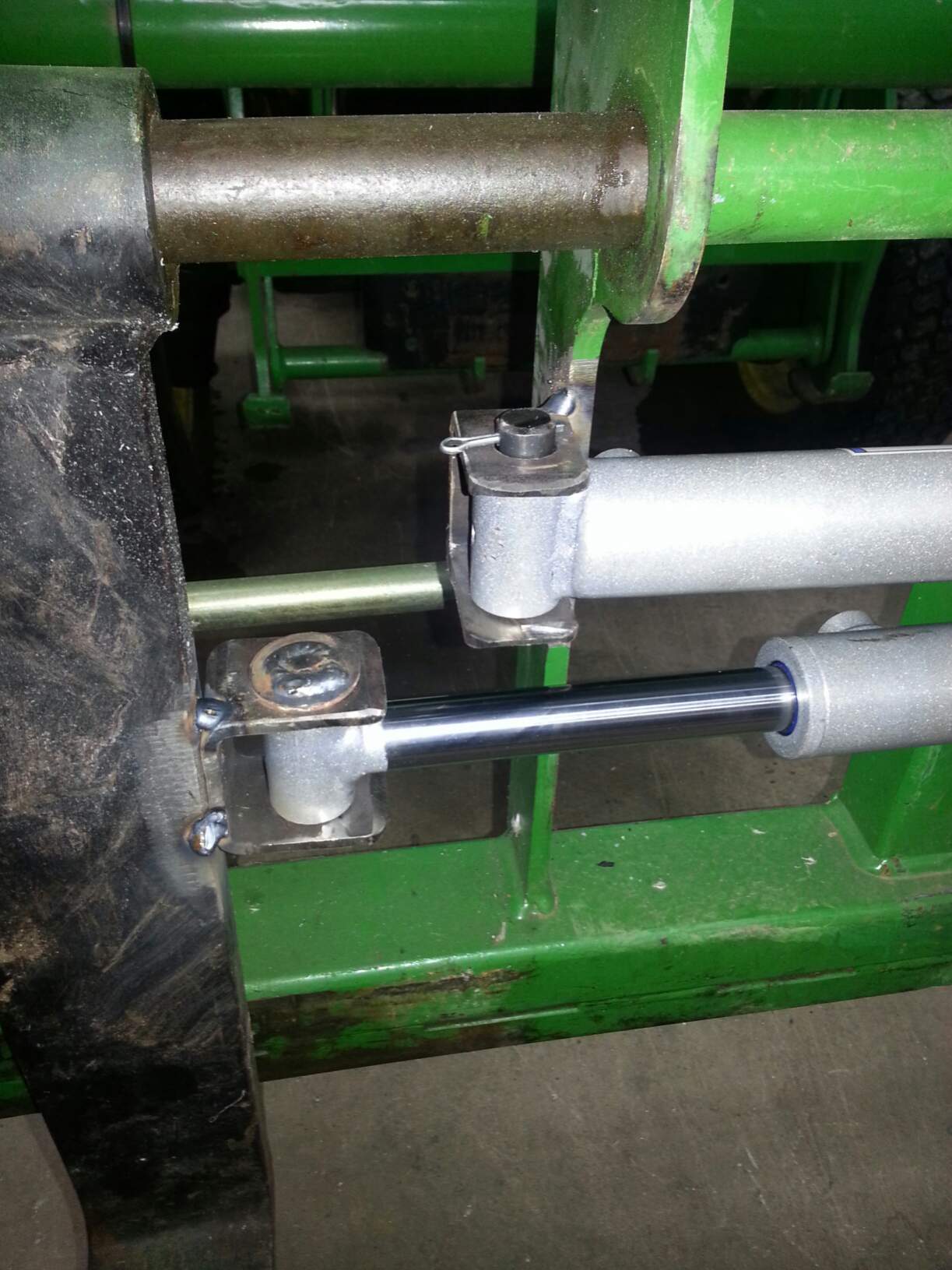

Has anybody added hydraulic sliding tines to there forks? I remember seeing a post (can't locate it now) of someone trying to control there bucket attaching pins for a quick attach? I have seen the common body 2 piston cylinders but price wise and to get the travel I require I am thinking of 2 separate cylinders. Any experience or ideas are welcome?
   / thinking of hydraulic sliding tines on forks? #3
If you use 2 cylinders on 2 circuits you can slide forks left & right as well as width. If everything is on 1 circuit I'd expect that a sticky fork or what not could make the whole thing slide one way or the other on its own when you adjusted width.

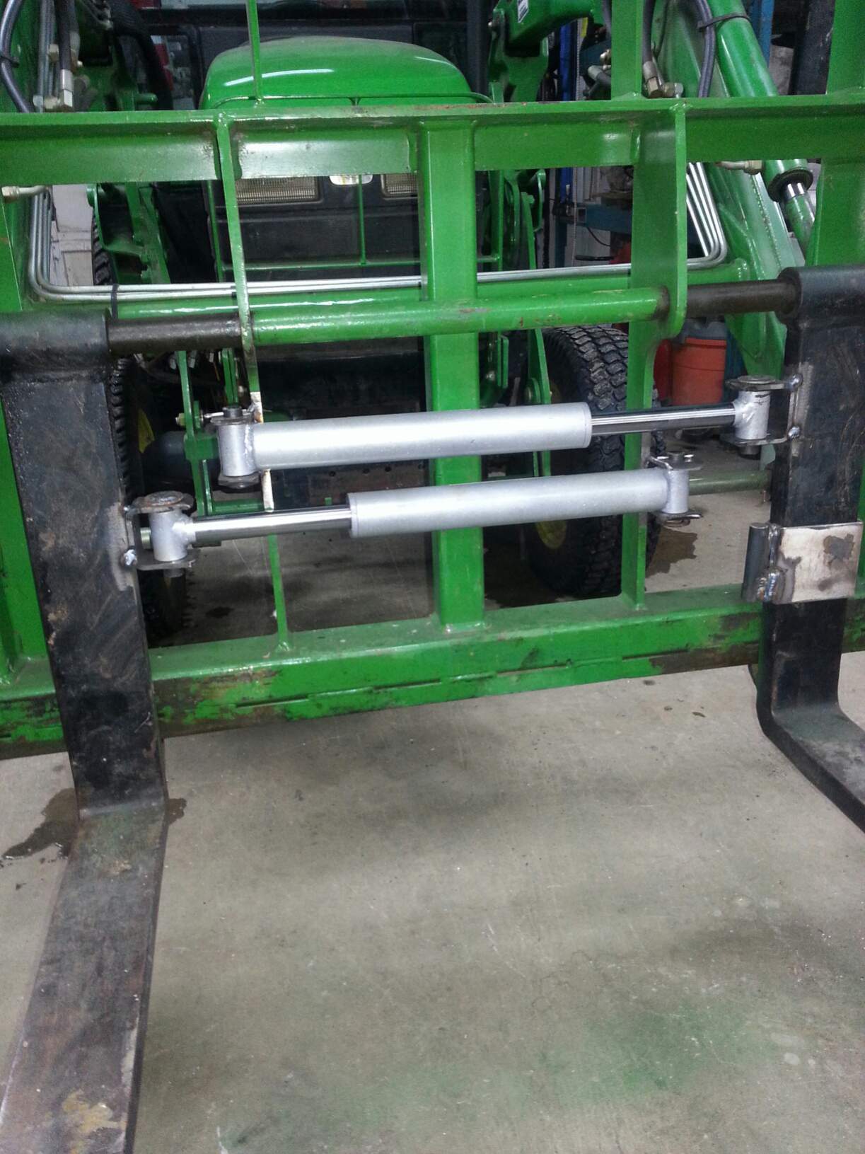

Well I bought a couple cylinders out of the sale bin with a 10" stroke 60 bucks each. I have the brackets made up and tack welded on, everything works and lines up good so I will try to get all plumbed up Sat. morning. Yes I welded directly to the tines, no safety police please.:confused2: hydro forks 2.jpghydro forks 3.jpg
Looks good. :thumbsup:

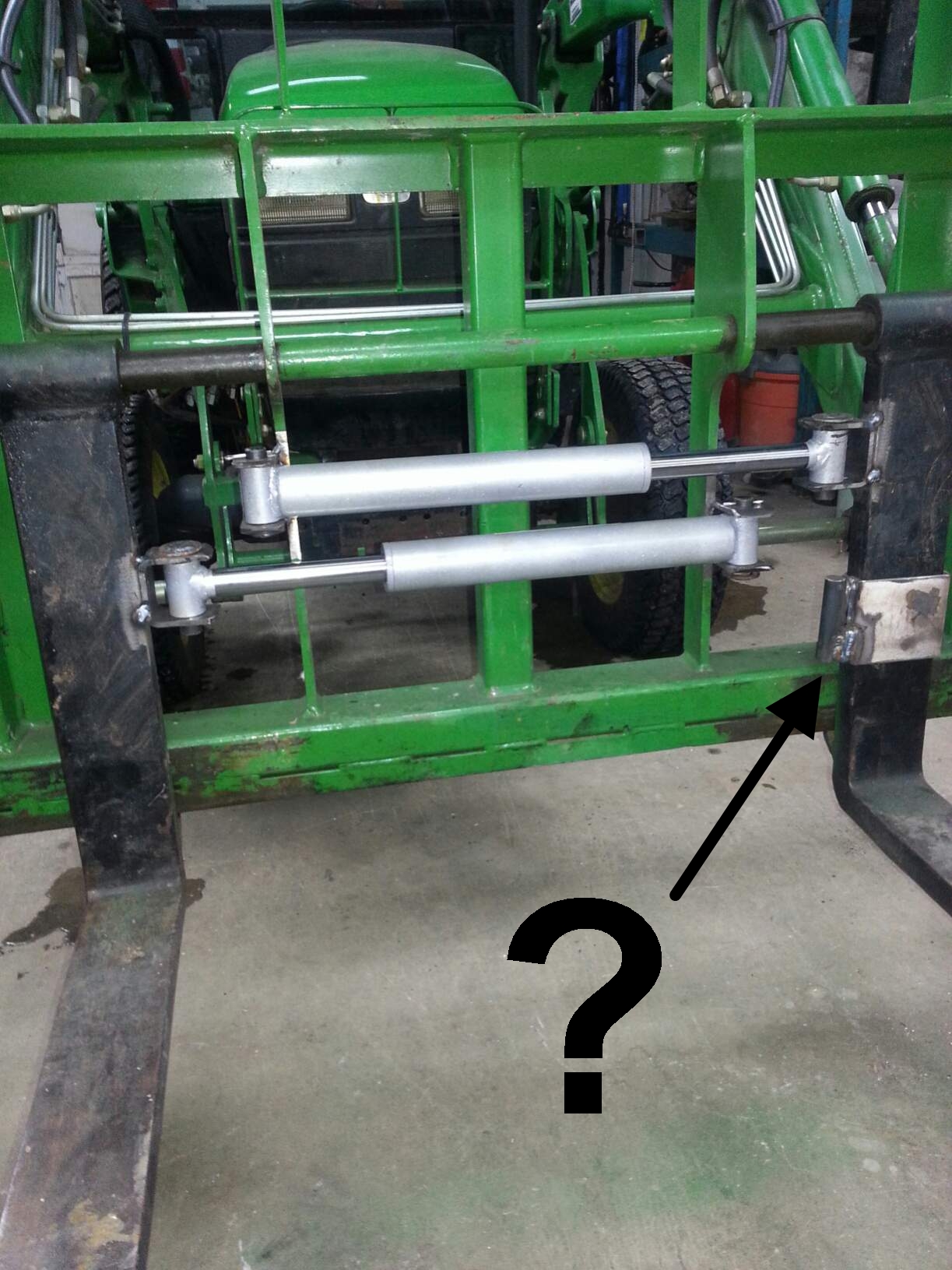

What is this on the left fork?
