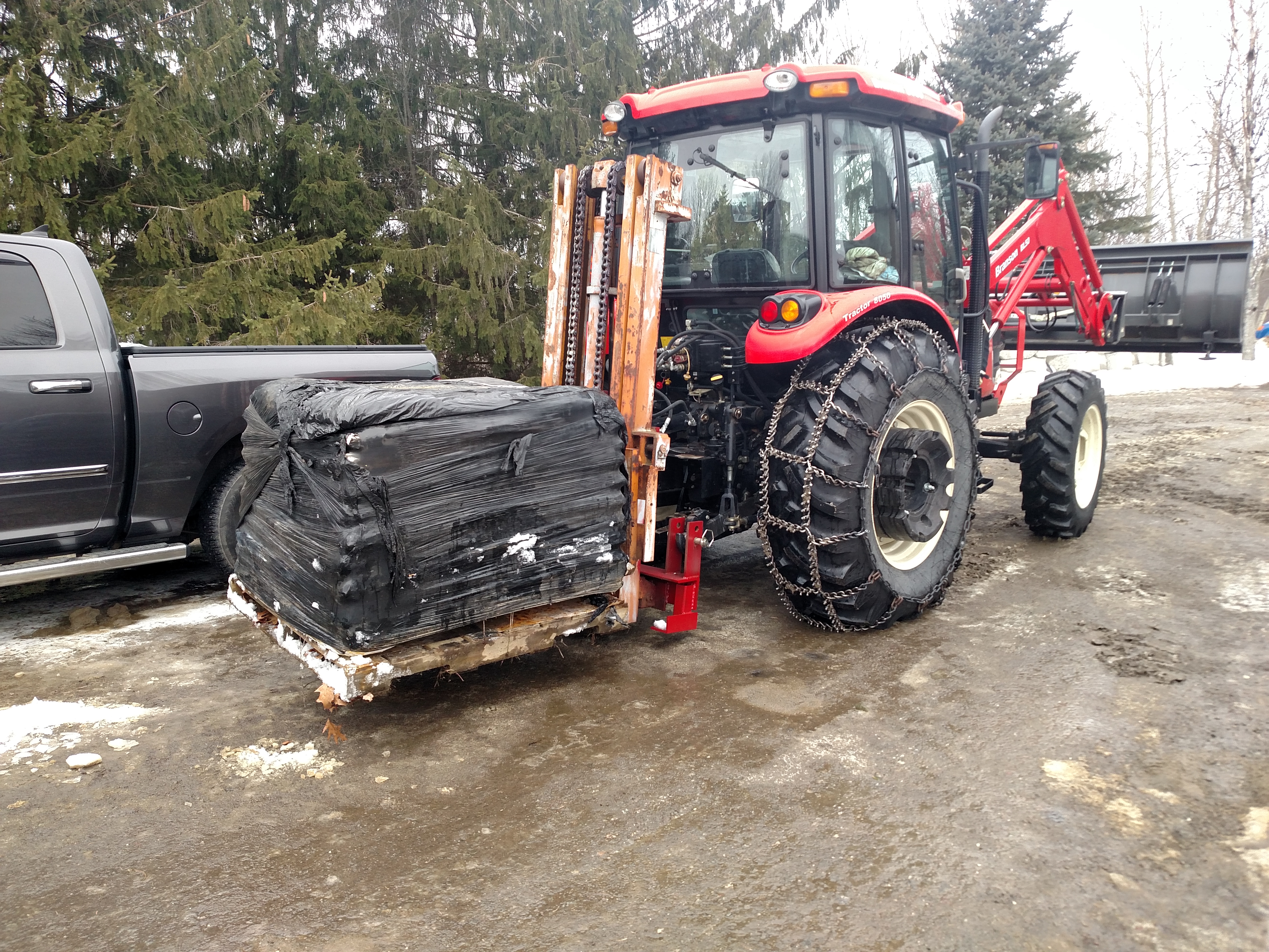

You could also go with a 3 point mounted fork lift tool.
ForkLifts
Or you can do it yourself;

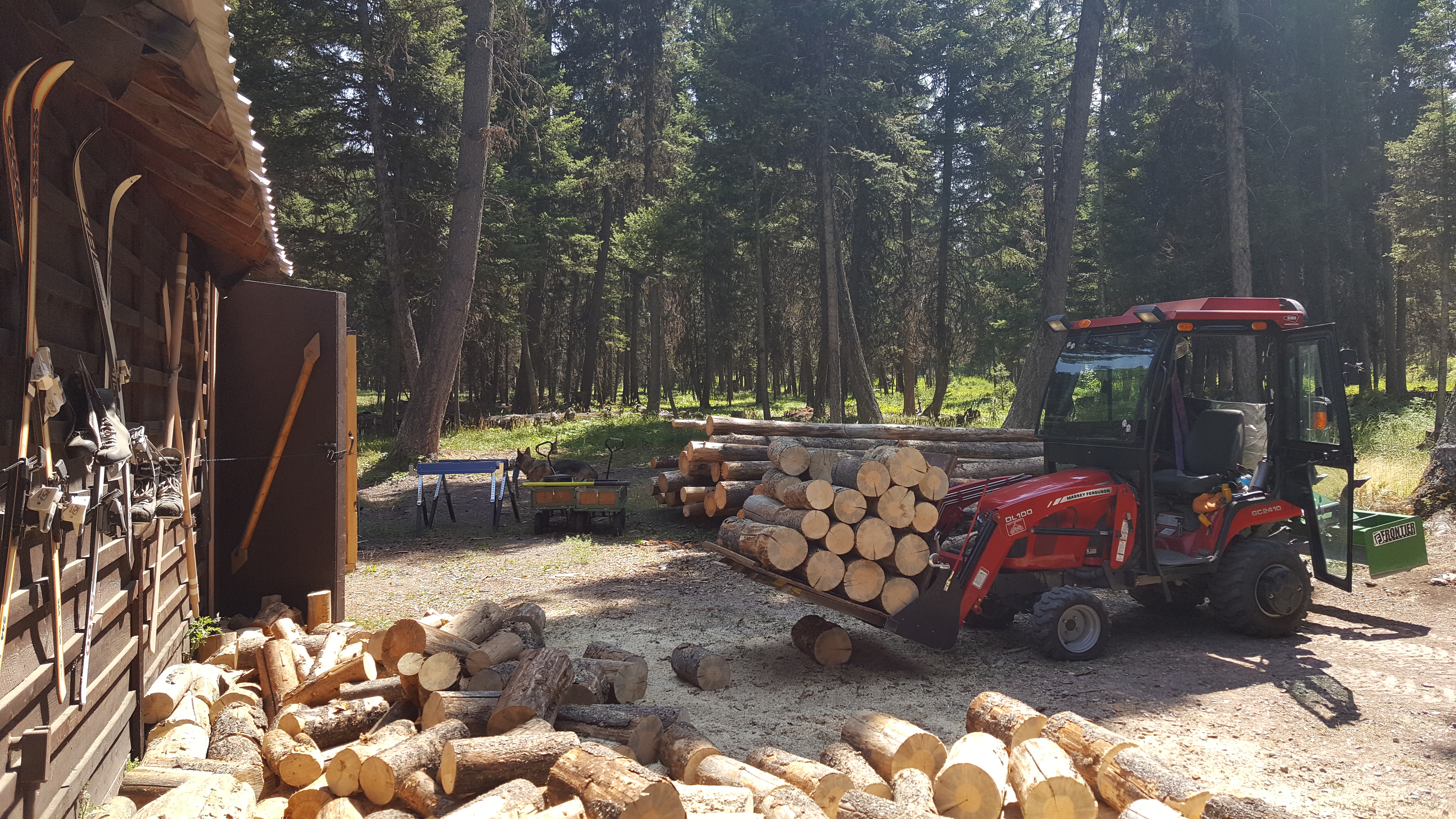

I see you have other changes you'd like to make, so if you want to just keep the MF and address them you may look into a Sim's Indy Cab with a heater, and a MF 2360 Snowblower, and either a quick attach front bucket system or add some forks to your existing bucket.
Here's a pic of what I use for firewood rounds to be put into the woodshed. I built it out of 1/8" x 1" x 3" square tube steel ( 5 of these extent out from the bucket about 40" + - with an angled frame sitting on the inside bottom of the bucket) and it attaches to the inside sides of the bucket (drilled and tapped) with 6 machine screws / grade 8 / 1/4" - 20 x 1/2" long. I have loaded up with some green firewood before that the MF did not have enough power to lift the bucket off the ground and so far never had any connection hardware fail or shear (still knocking on the wood).
With this set of "brush forks" (original purpose of the build), I can also pick up pallets of split wood if needed.
I know that lots of members here have more then 1 tractor and if I had more land, maybe I would be thinking that way also.
For me from the start for a tractor search over ten years ago, because of my physical limitations, the choice was always a fully heated cab and a front mounted snowblower...
Good luck with your search, KC

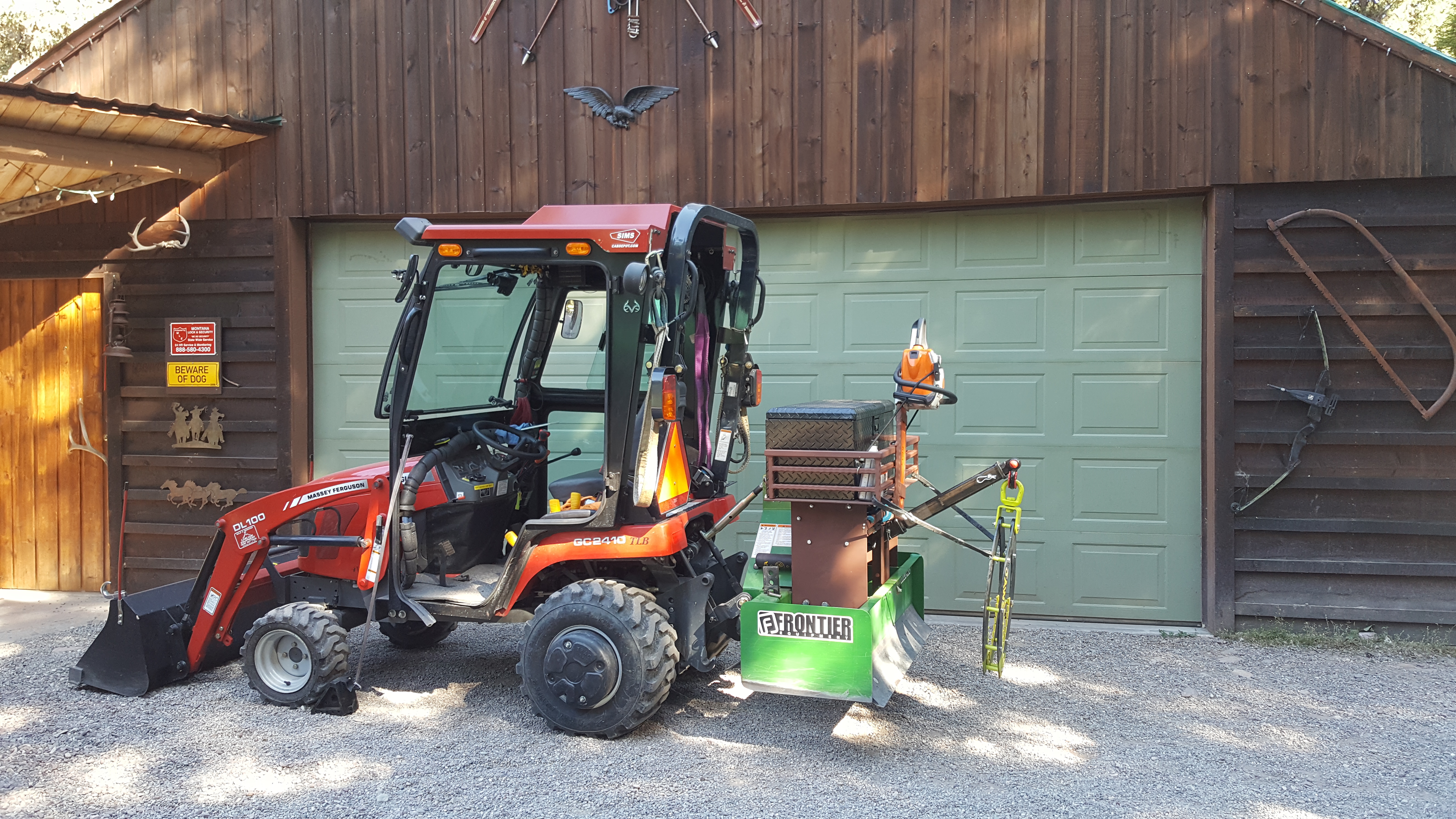

It's a "Sims Cab Depot" cab, model is a "Indy Cab", It has two soft removable panels below the front windshield on both sides, and a soft removable clear panel at the rear (hard fixed panel would be in the way for using the backhoe). I really like it and in the summer I have just started removing the door for easier access.
I do believe Curtis still makes a cab for the MF GC2410 and since I have purchased my Sim's cab over 10 years ago, maybe there might be others that make a hard sided cab for the MF.
Here's a pic of what I usually will have installed on the MF in the summer.
KC

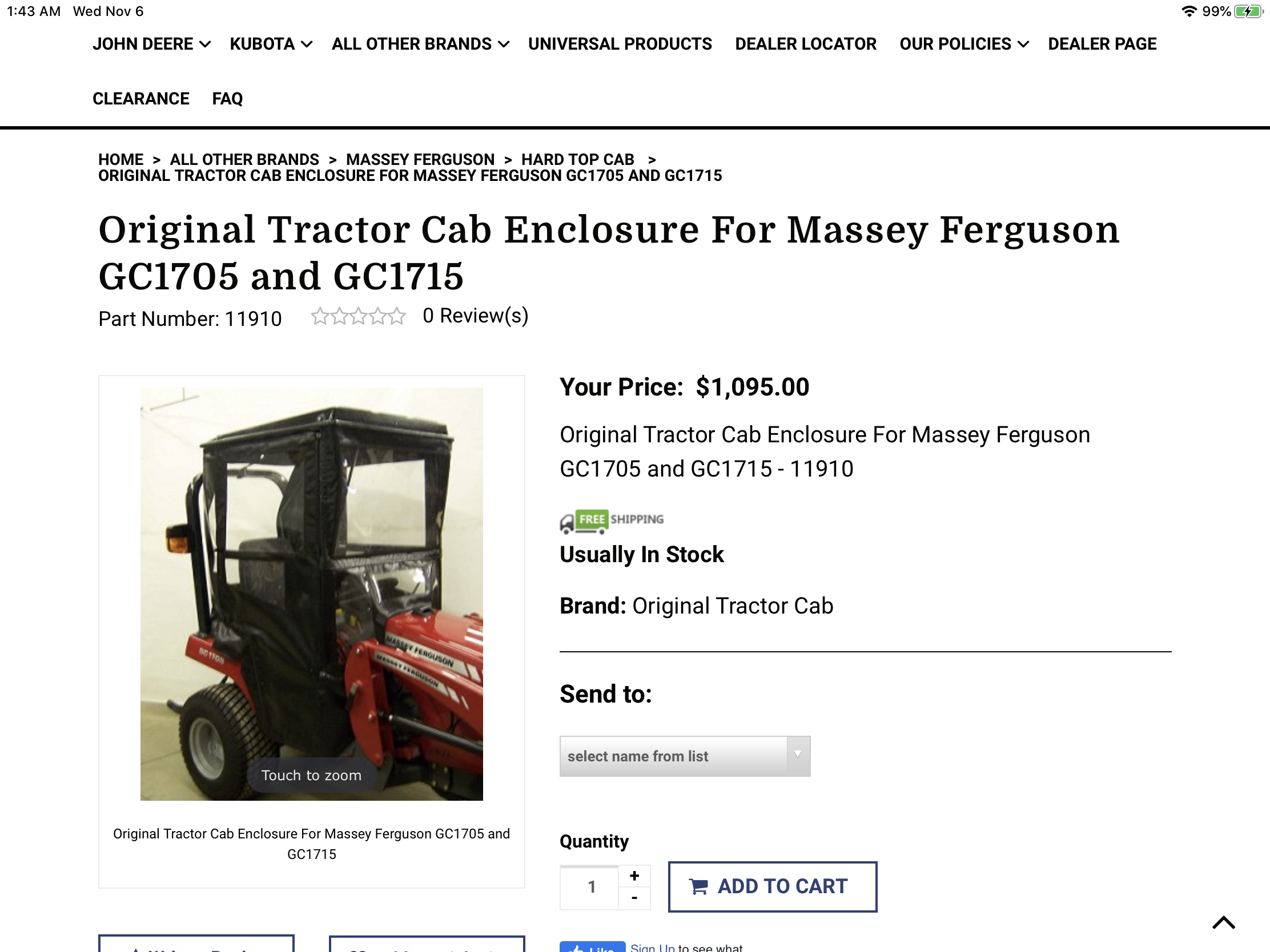

This is the one I have been looking at.
