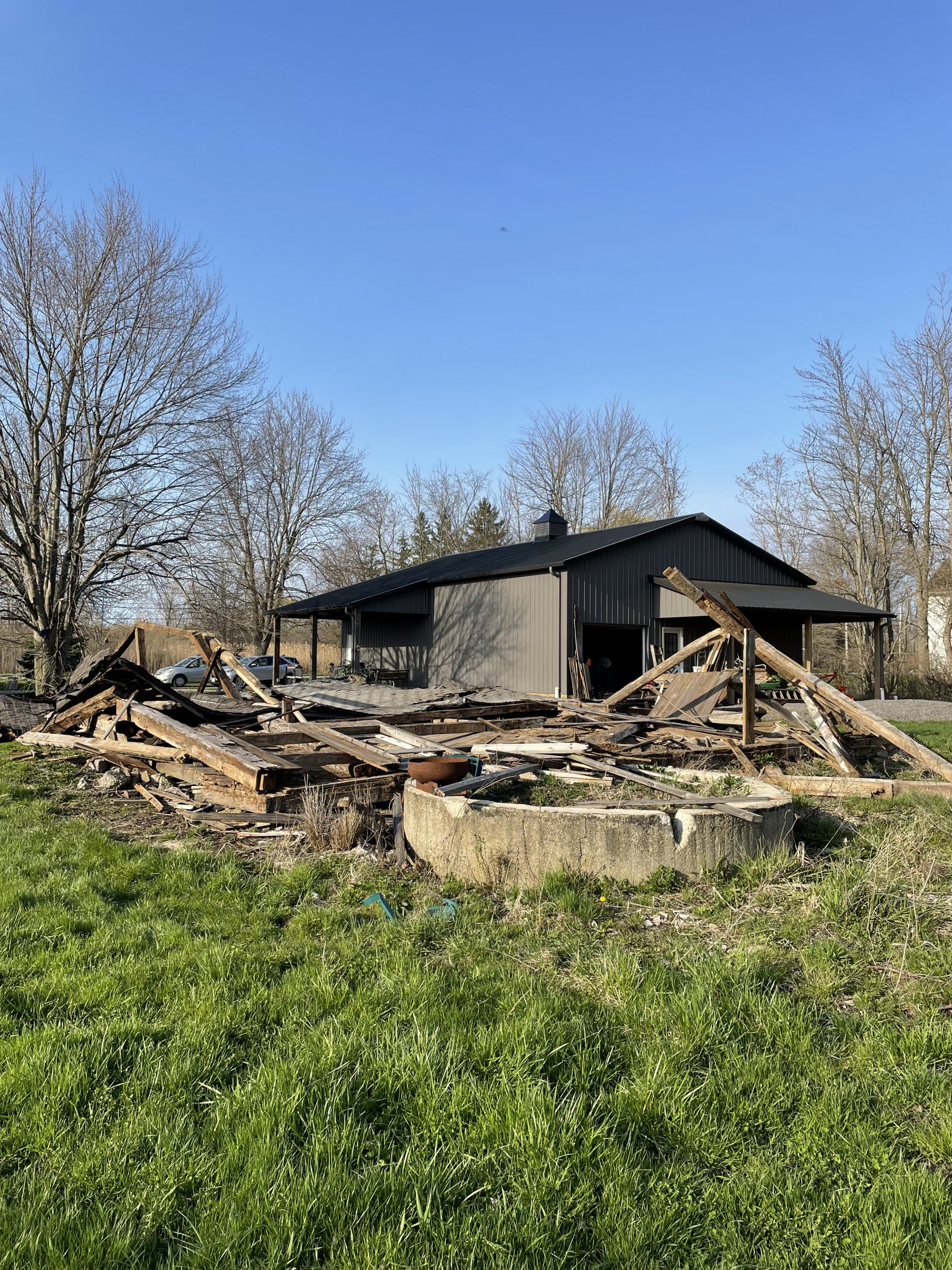

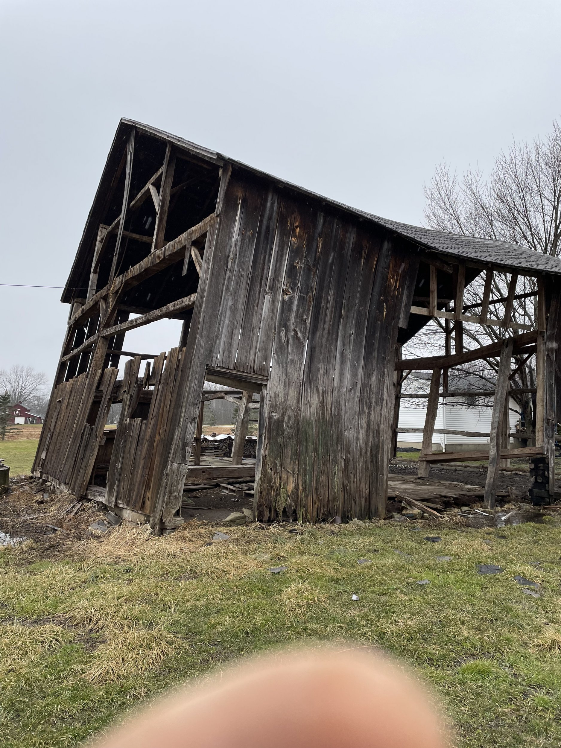

It was kind of sad pulling down the last of the old barns yesterday. I still have lots of cleanup to do, but the skyline of our farm is different this morning.
I am going to save as much of the 9” square and 6” square hand-hewn posts and beams as I can, cutting them into 10 ft lengths and stacking them under the back porch of my new pole barn, until a “need” arises.
I am also going to save what’s recoverable from the sawed oak rafters and 1” thick x 12” wide American chestnut roofing boards, that is now under several layers of shingles. It’s much safer working on that, now that it’s down on the ground.

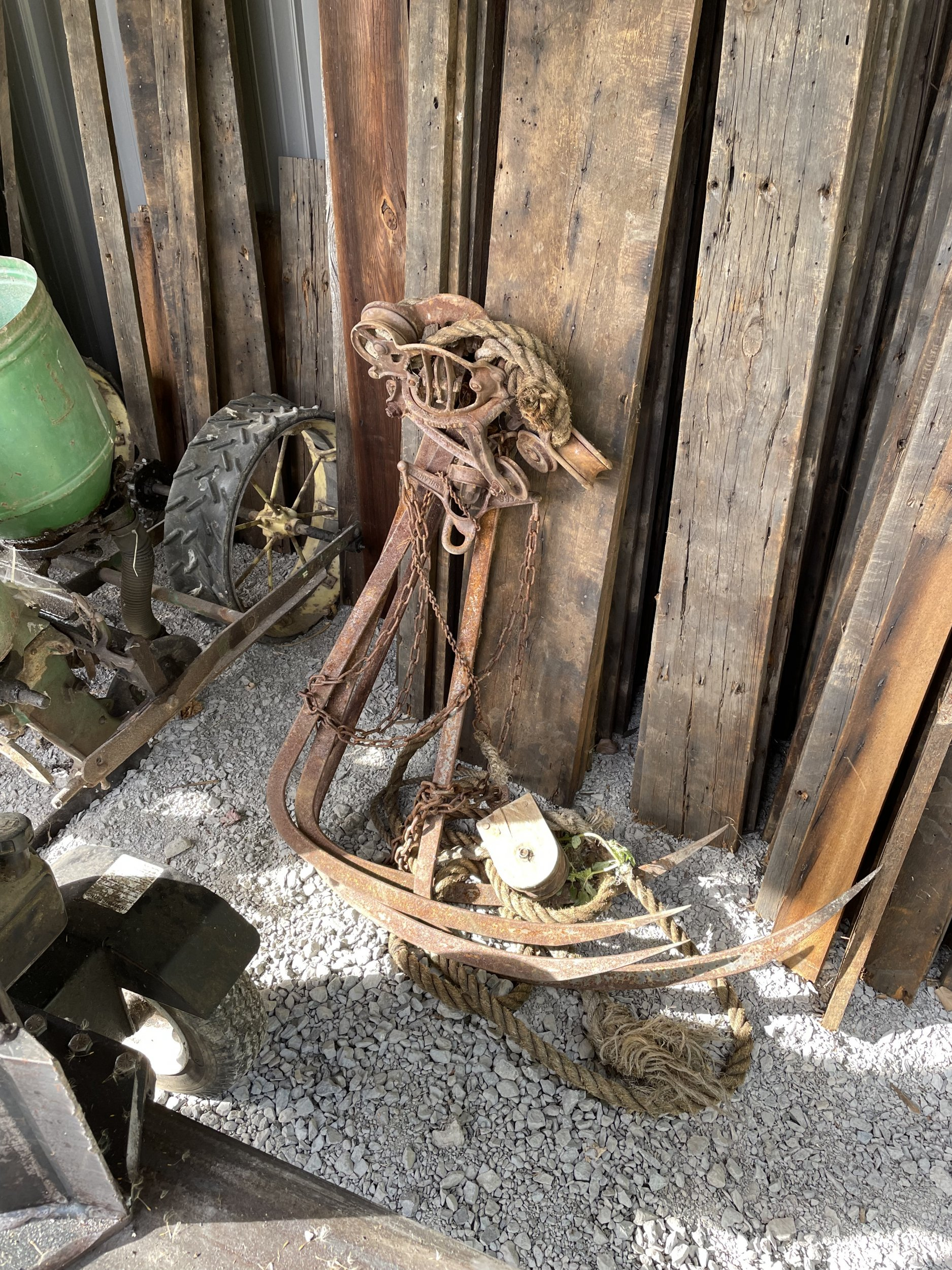

Two other things I want to recover, are what’s left of the “83” siding board, and the hay forks, and trolley that were up under the peak. They were way too high for me to try and get while it was standing.

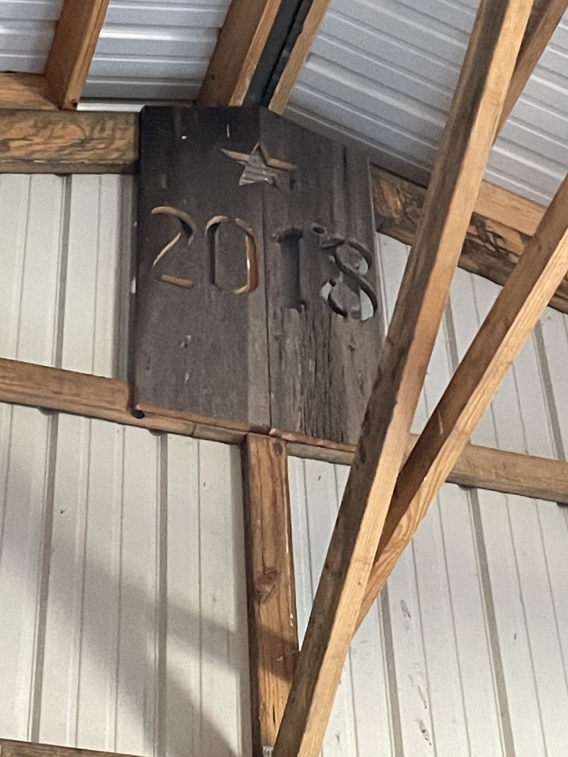

I did manage to pull down the “18” board from the top of a 24 ft extension ladder, but the “83” broke across the center of the “3”, when I tried pulling that one down. My new pole barn went up on the site of great grandpa’s first old barn, in 2018. I used that “18” board, and matched the text size and style with a jigsaw on another, to mark the year inside the new barn.

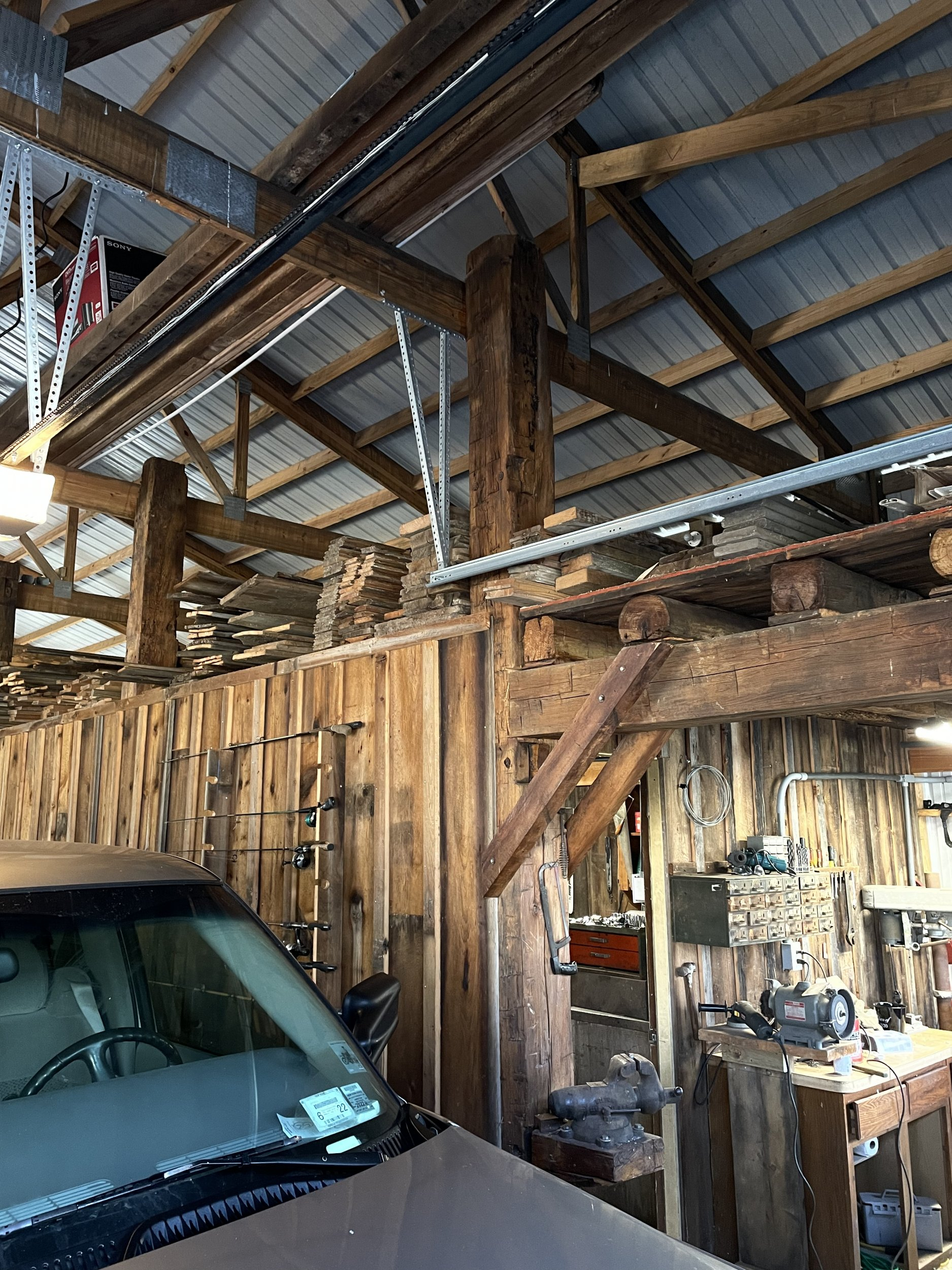

I used hand-hewn posts & beams and sawed rafters, siding and roofing, from the first old barn that I dismantled, to make a loft and workshops inside the new steel barn. I will use some of that stuff from the last one, to enclose the back porch and make a new firewood shed on the back.
I pulled it down using a 1/2” wire rope and a snatch block, attached to my largest tractor. I put it in the lowest gear. I wonder how long it took the pilgrims to raise that old barn frame. It came down in under a minute with my tractor in the lowest creeper gear. The snatch block cut my speed in half but doubled my pull force.

The lofts were not really made for the added weight of baled hay and the floor beams got busted up in several locations. The barns got crooked and that contributed to their eventual demise.

My only worry, pulling this last barn down, was that it would hit our house (missed that by 8 feet), or my new pole barn (fell within an inch and a half of that). I hope to have everything cleaned up so I can seed grass around mid August.

Great for you to have roots on that farm that go back 4 generations. As I read your post, I was thinking "Gee, he should have saved it." but when I saw the pictures - too far gone to save.

This is the loft and workshops in the new barn. Note that I spaced the loft floor beams at half the distance that they were in the old barns. I learned my lesson there and am not going to have hay bales (or lumber) crush this one.

I made the new pole barn 36 ft wide x 50 ft long with 12 ft walls and (2) 25 ft x 10 ft porches. The loft and shops inside (timber framed from materials recovered from the first old one that I took down) is 12 ft wide X 30 ft long.

Yesterday, I even recovered the hay grapple hooks and trolley. I was pleased to see that the trolley did not get damaged in the fall when I pulled the barn frame down. I think I might rig up a section of the rail between trusses of my new barn. That way, I can use my great great grandfathers old grapple to move loose hay up into the loft from a wagon, if I ever decided to raise livestock.
