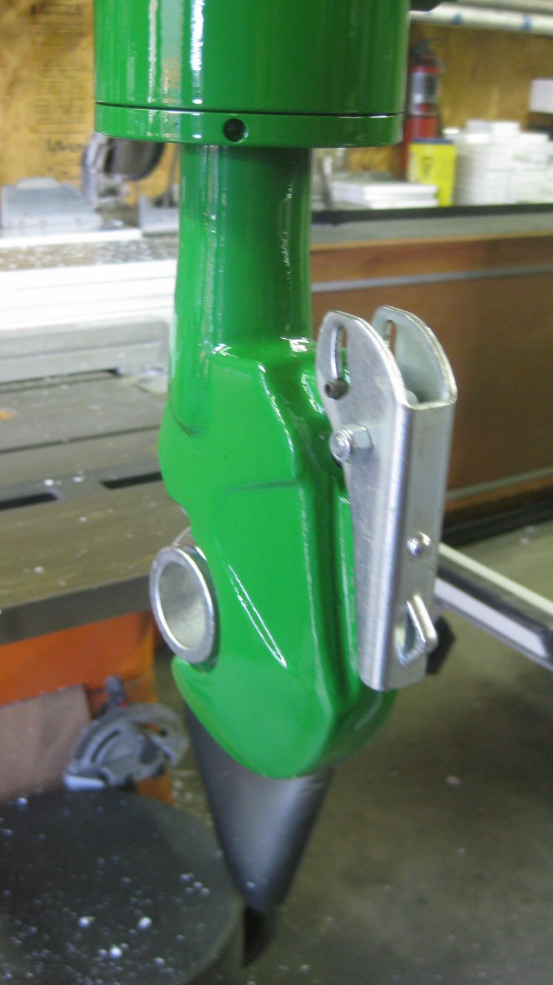

Sounds like you need one of these on the end of your top link. :rolleyes:

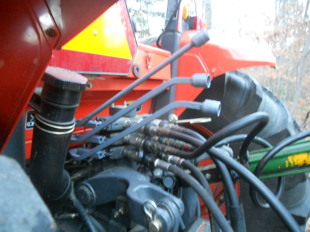

A (related) little easy modification that is nice with a hyd. toplink and is a big aid in attachment hook up is a little lever so that you can actuate your rear remote's from the ground (behind the tractor). I did this to all 3 valves to operate the log winch from the back, it might not be as big of an issue with a smaller tractor that you can reach over the fender to operate the rear remotes. It was pretty simple to do, at least with Kubota's valve arrangement. Yes, those are old sockets for handles:laughing:

Man thats slicker than pig poo.:thumbsup:

Wow!! Real Yankee ingenuity. I will definitely look at something like that.

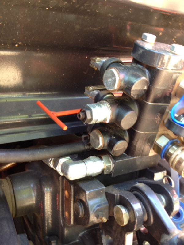

I did the same thing too, I need to go a head and do the remaining two remotes now.
