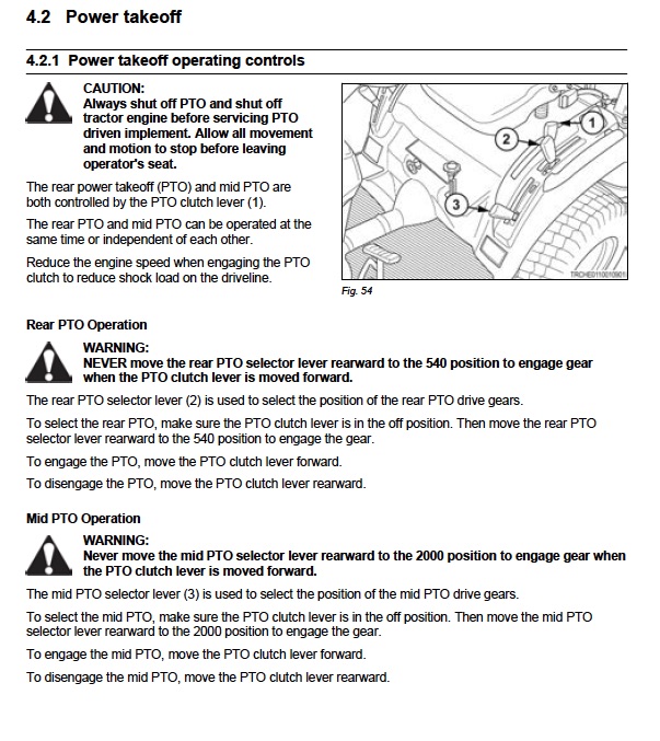

Thanks for the feedback. So you're saying since is it HST and not gear there is no internal clutch to release when you engage the PTO correct? So you installed an external slip clutch on your rotarty mower/bush hog?
So did this help with the issue?
Correct there is no clutch on the hydro. Honestly I have not installed the external clutch but it can not help but to be better. I really like my 1705 and even though I'd call the PTO thing an issue you can live with it. I also have a post hole auger and I do not get the harsh engagement with that piece of equipment.
   / Test Drive Massey Ferguson GC1723E/GC1725M #7
Its recommended that you engage your PTO at low engine RPM's and then raise the throttle once engaged to reduce/minimize system shock & #/stress vs engaging with the engine throttle up high.
   / Test Drive Massey Ferguson GC1723E/GC1725M #8
I haven't hard very harsh engagement on my Hardee 52LT when the slip clutch was seized solid, either. When I added a new slipper and adjusted it, it engages smooth as silk. I barely feel it on the tractor before throttling up.
There is a clutch. There is a central engagement for supplying power and independent engagements that control either PTO output separately.
