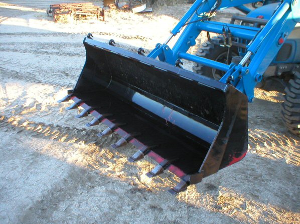

Ready to buy 4 in 1. Already have GP bucket. One bucket has to have teeth.
Can't decide which one, but I'm leaning towards the GP bucket think it's less apt to bend in rough digging and less expensive to repair if it does.
Thoughts? Opinions? Previous experiences?

I agree with your logic. Put it on the standard bucket.
   / teeth on 4in1 or GP bucket #3

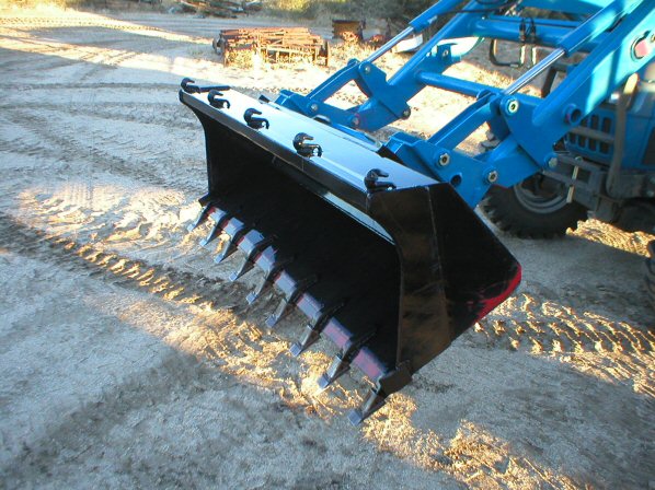

Put them on your gp bucket, but reinforce that bucket before you go digging.

I converted my tractor to quick attach and bought a 4n1 bucket with teeth. I have the original bucket and an adapter to weld to it to make it quick attach also. I have not found a reason to use the old smooth bucket yet.
I would put the teeth on the bucket you will use the most. Make sure you buy a 4n1 that is strong enough for your tractor and your tasks and I don't think you will need to worry about hurting it when you dig. My 4n1 is built better and stronger than my smooth bucket anyway.
Looking back, I don't know how I got along without teeth on the bucket. In addition to digging, it is a great place to attach a chain and lets my carry more firewood per load.
Hope that helps.

I have a similar problem in that I have a 4-n-1 now, and would really like a bucket with teeth. I keep waffling between getting a GP bucket with teeth, or getting a toothbar for my 4-n-1.
I have just about talked myself into getting the toothbar for the 4-n-1.
There has been only one job (carrying a bucket of wet concrete) where a GP bucket would have been better than the 4-n-1. But, there have been dozens of times when I was happy to have the 4-n-1. And, the big issue is that a lot of times I didn't know ahead of time that I would need the 4-n-1 capability when I started the job.
What you will find is that once you get used to the 4-n-1 you will want to have it on almost 100% of the time.
The only problem with that is if your loader is not strong enough and the extra weight of the 4-n-1 limits your ability to lift & carry a full bucket. My loader is strong enough that I can lift any load that will fit in the bucket, so there is almost no reason to ever put a GP bucket on the loader.
Dave, you might also consider welding shanks right on your bucket, rather
than using a toothbar. If you add a toothbar, you have to drill holes, which
is tough.
It seems to me that the reason NOT to have teeth on a bkt is so you can
scrape a smooth surface when you need to. But a 4-in-1 can do that with
the dozer function, so adding teeth to the other edge of a 4-in-1 is a big
plus, with few trade-offs.
I will bet that once you have a 4-in-1 bkt, you will never put that GP bkt
back on. Same with a toothbar.
