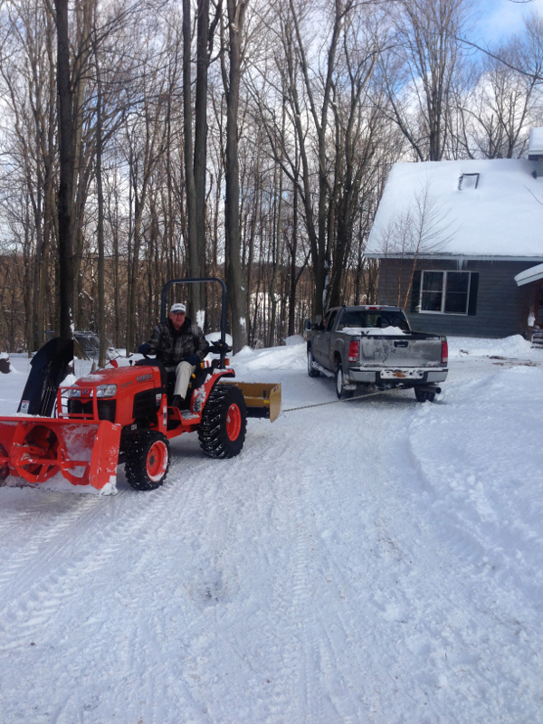

We purchased a used B3300SU last summer and have not been able to use it until today - after around 30" of snow in CT.
What is the proper technique in this situation (I know - don't let it get that deep).
Any help will be appreciated. My Mother-in-law is 95, has COPD and is legally blind. We were caught off guard do to Mom's health and go all of our cars snow in. No one is available for plowing but we need to clear the driveway because Mom goes t the emergency room ever week or so and we need to be able to get her there.

I've got a B3200, so basically the same tractor. I took the backhoe off for the winter and replaced it with a ballast box.
This was my first storm with the tractor. I kind of made it up as I went along, learning in the process. I could push about 20 feet at a time before the snow piled up so high that the tires started to spin. At that point I got a bucketfull of snow, backed up and dumped it on the side of the driveway. I finally figured out to cut back and area, actually a couple of them, along the side of the driveway to dump the snow in. I pushed back the sides lifting the loader at the same time then dumped the snow in the bucket over the top.
I found that on long flat stretches I seemed to make out better when I put the transmission in H instead of M. I could build up more speed and the tractor could push the snow farther. If I was just moving shorter distances I would leave the transmission in M. I ran at about 2000rpm which seemed to give it plenty of power. The only time it bogged down was when I had the loader buried in a 5 or 6 foot high mound of snow. Then all I had to do was lift it and dump it over the top of the mound.
I just took my time and kept pushing, lifting and dumping until I got it done. I got about 4 hours seat time between my driveway and the neighbor's driveway so I'm not complaining!
I don't know if my technique was the proper one or recommended one, but it worked.

Trial and error for me but got it done. I pushed a bunch areas back to dump snow then moved when needed. I tried to go on and angle from the center of driveway out so I could push and lift more then one scoop at a time. A rear blade would have been nice for final cleanup.
Float works ok for pavement but I found feathering bucket worked better.
Tractor WAY better then plow truck for this storm. I had 4' drifts across driveway. Plow wouldn't budge.

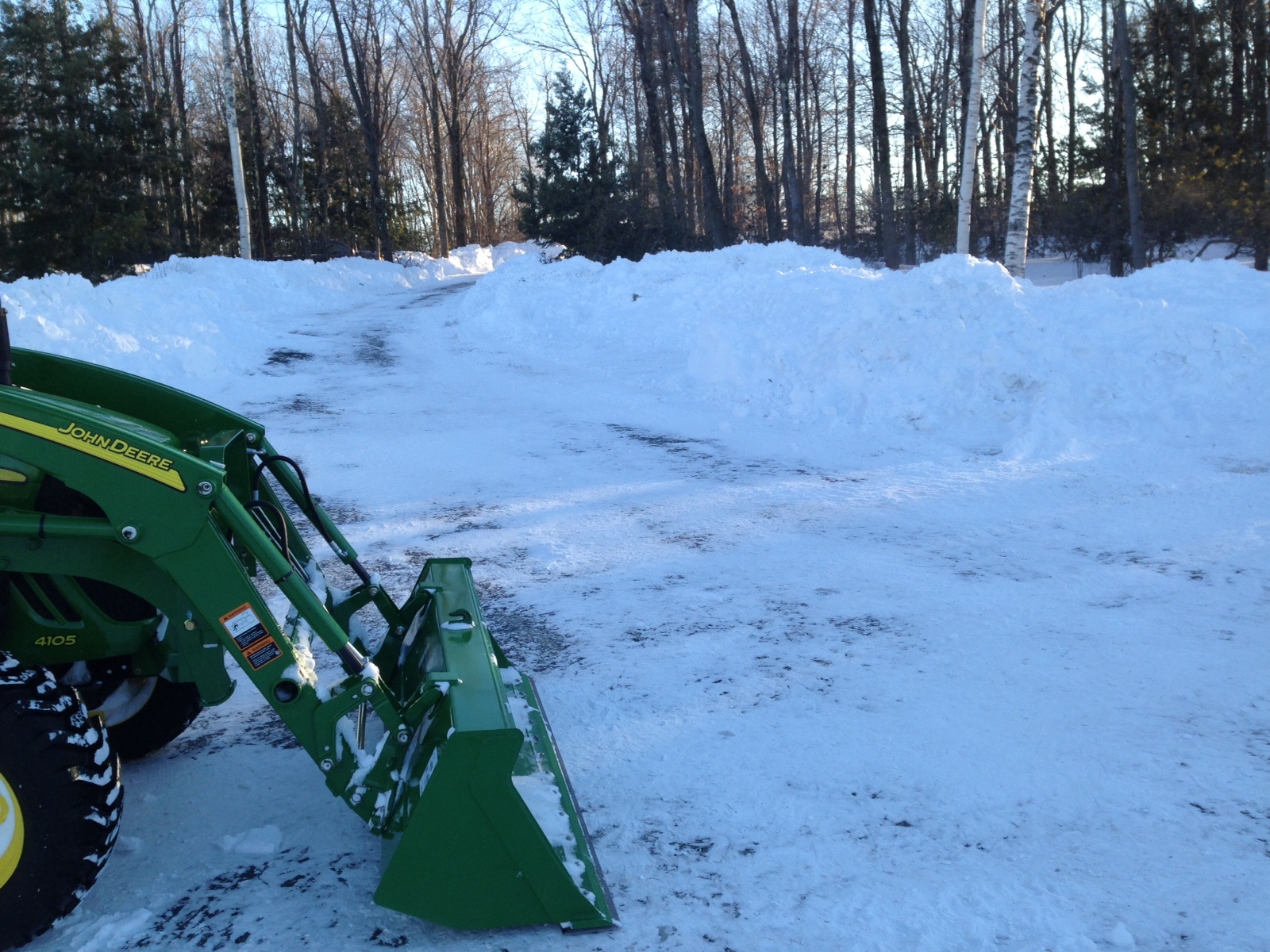

   / Technique to clear 30" of snow w. Kubota B3300SU #9
So far, loaded R4s with the ballast of the box blade on my B3200 and I haven't run into a traction problem yet. My surface beneath the snow is gravel/ dirt.
