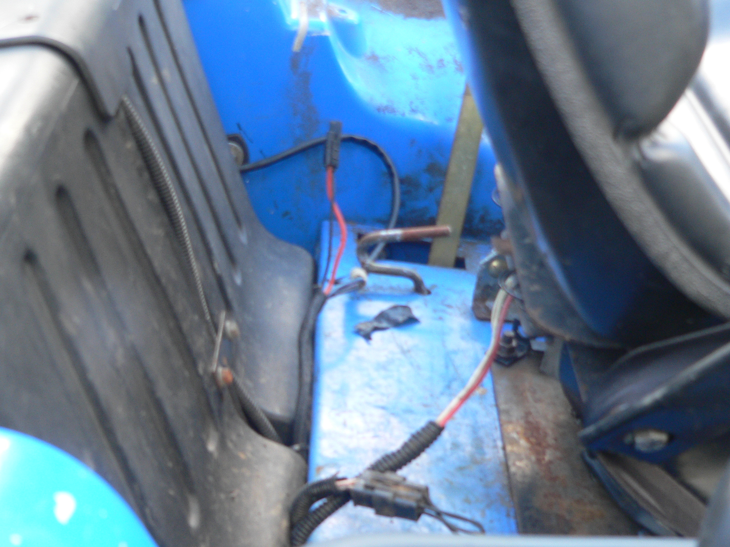

I'm do not have the diagnostic skills of Jinman (Our shared NH service manager called him for help a few times) but I know where I'd start. I'd jump the seat switch first and rule it out as the cause. Then I'd check that all of the safety switches are traveling far enough and then check all of the associated wiring. The PTO linkage on mine tends to vibrate into gear while running. I use this "feature" as a a sort of anti-theft device. The ignition switch is also known to be a no-start, shut off problem. There is a little black box hanging under the dash that I remember Jinman having me check for a no-start. What the box is I can't remember.

Yep, operator safety module. That sounds right. The fuse box being upside down is a concern, but it may have been like that since new. Both boxes on my T320 are like that and backwards from the diagram. Maybe they're not though, since the only way to read them is with my head in the cab upside down.
Just throwing things out there, but have you replaced the big honking main fuse on the side of the engine? I'd remove the frame ground from the battery and clean that too. Mine looked fine, but when I removed the bolt it was rusted almost in half.
   / TC40D fuel problem #24
Due to the issues with all the safety switches I installed a relay to actually start the tractor. This way the safety switches are still active . even though they don't pass enough power to engage the starter, they will trip the relay.

Despite having checked - or so I thought - that the tractor wasn't in gear, it was!! :eek: :eek:

Anyway that pretty much convinced him that there's a blockage in the tank.
Later today I'll take my compressor up and blow back into the tank with the airline. Hopefully that'll sort it once and for all.
Many thanks to everyone who tried to help.
   / TC40D fuel problem #28
If there is gunk in the tank just blowing the line clear will not cure the problem. You will have to remove the tank, drain and clean it. Otherwise, the gunk will find it's way back into the fuel lines.

As I said earlier I'd take a photo of the, erm, 're-wiring' so you could see what I'm faced with. Don't know what went on with the previous owner but this is what I've got now:
   / TC40D fuel problem #30
That looks like a bypassed safety switch
