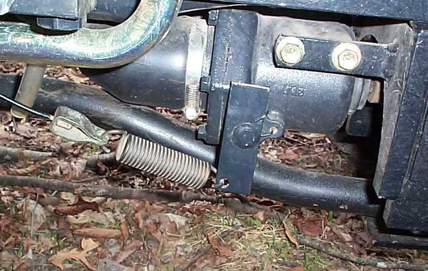

I checked the linkage, which consists of a cable running from the lever to the front drivetrain area. The cable is attached to a spring, which in turn is connected to a rectangular plate.
When I move the FWD lever, the cable moves and tensions the spring, but the rectangular plate doesn't move. So, it looks like moving the FWD lever isn't "telling" the drivetrain to do anything.
I've attached photos of the linkage in both the auto FWD (spring relaxed) and full time FWD (spring tensioned). Can someone explain what's supposed to happen here?

Here's the second photo - full time FWD lever position, spring tensioned, no change in position of the rectangular plate attached to the drivetrain.

I just went out and check my TC29D for the same thing. And I get the same results as you do. The rectangular plate doesn't really move. I can only see a difference in the tension on the spring. But I can tell a difference whether or not if it is in 4 wheel. One would think the plate should move. Any NH techs around to comment.

Went back out and lifted my front wheels off the ground. My wheels will spin opposite of each other whether it is in 4 wheel or not. I also drove my tractor a bit putting in 4 wheel and out. I can tell it is going in and out as I put it in and out. Also my rectangular plate does not move. So I am not sure if that plate just looks for tension on it to determine 4 wheel or not.

Both of your pictures appear to give the same lever position on the sensitrak transmission. Which is locked in 4WD.
On our TC-40D when I place the 4WD lever in the locked position it places the lever on the sensitrak transmission in almost a dead vertical position (retracted). Just like your pictures.
When the 4WD lever is moved to the auto position the lever on the sensitrak transmission moves forward to about the 5 o'clock position. (extended)
Look to see if your cable is free and check the lever in the extended position to see if there is some binding there. It may just be dirt creating a problem. Get some WD-40 in there. We are assuming that you are checking the fluid level of the sensitrak transmission at recommended intervals.
