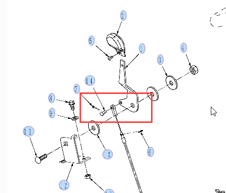

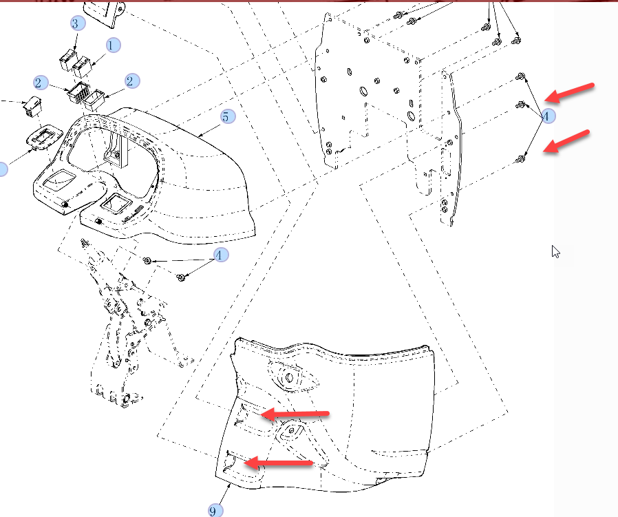

Working in the cold sucks. Doesn't look like there is any adjustment on the cable. There is a rivet #14 with a cotter pin #7 that connects the throttle cable to the handle. Part #6 is a snap ring on the cable. Removing the lower panel is fairly easy - 4 bolts, 2 across the front that holds the 2 lower panels together, and 2 on the firewall. From there you can access the throttle handle and cable.
When you move the throttle handle is the injector pump linkage moving? You should be able to see the end of the cable where it meets the injector pump linkage.

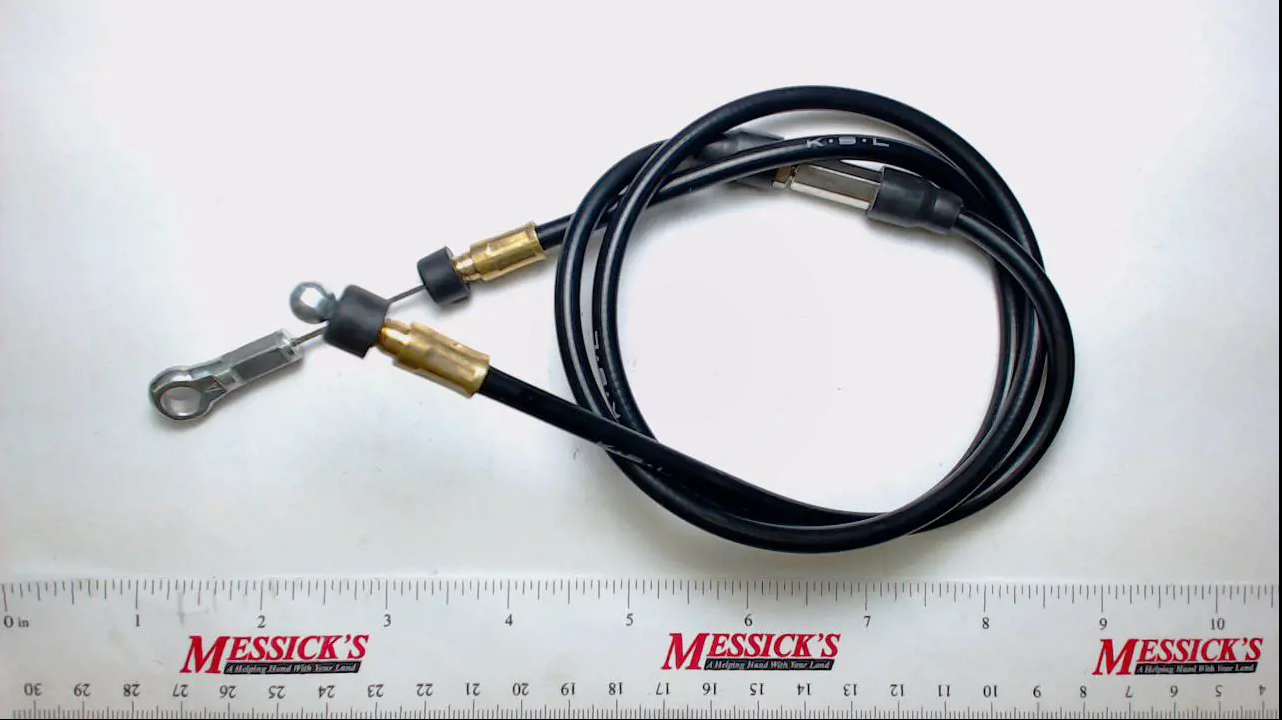

View attachment 4456724 View attachment 4456720
Yep, cable broke right where it is crimped in the endpiece below the throttle lever. Not too bad, once I get the part.
