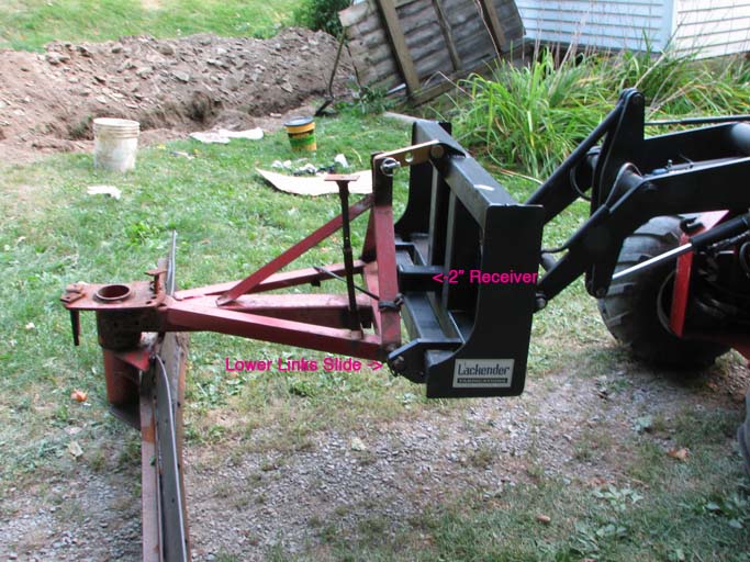

No sideways pictures with the bucket (the attachment plate needs to be rewelded - at the current angle of attachment, i can not dump fully). I only get about 90 degrees of angle rotation on the FEL - i will measure it sometime.
Here is a picture of my dirt blade attached.
Ken

Ken,
I notice that the bottom leg of your rollover assembly is longer than the top part. This will give you a mechanical advantage, but the linkage to bucket hook up seems wrong. I have a variable tilt leg going to my bucket, and the reason for this is that certain attachments, have different spacing on the upper and lower lugs for the 3 pt hook-up. I have even used one of those adjustable 3pt top links for the tilt leg, but I would not trust it to much. I think I would try and find the correct length for the bucket to rotate to the degree that you want. I have made several different length for different things, I know the one leg will not work good for everything.
That is a nice 3pt adapter you have. Is your blade difficult to push fwd, or do you always drag it in reverse?
