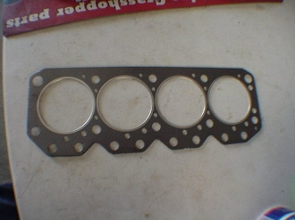

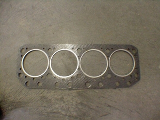

It would be very helpful if you could post pics of "Style A". The difference could be as little as material, or change in fire ring depth, changes in coolant passages. Really hard to say without seeing.
Here is a link to style A:
485-01002 Style A
Here is a link to style B:
485-01002 Style B
Style B has about twice as many passages for coolant.
I now notice that Style A says it's for TY485 and Style B says it's for Yang Dong 485. If the manual that came with my tractor is to be trusted I have the Yang Dong.
   / "Style A" vs. "Style B" head gasket #6
Excellent. Now post a pic of yours, if you can, to complete the trilogy. (No Rich, there aren't four parts to this trilogy. :laughing:)
Offhand, I'd say they are for completely different engines.
   / "Style A" vs. "Style B" head gasket #7
Offhand or not, bob's correct. Style A is for JIANGSU-JIANGHUAI engine TY485. Style B is for YANG DONG engine Y485. The 485 part is a generic Chinese designator; 4 cylinders of 85mm bore each. The engine data plate will specify which one you have.
I have one of each, they look just like the pictures. The style B came inside the engine, the style A came with the gasket kit. I'm now glad I ordered the Style B and didn't try to make do with what I had.
