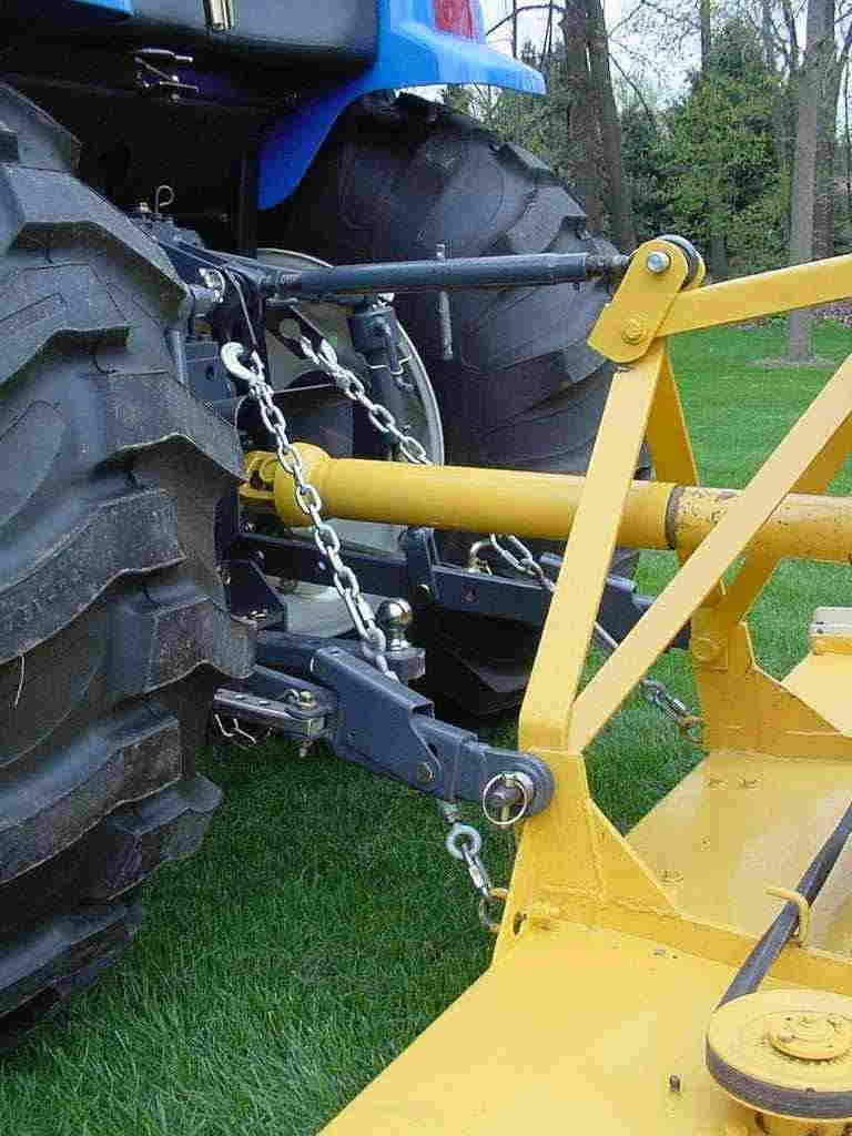

Does anyone have any solutions (preferrably pics) for placing 3ph stabilizer chains on a Kubota B7800 to limit the drop on brush cutter. Seems pretty cluttered back there to get chains down to the lift arms or back to the cutter.

Check this link. I think it has the info you need.
Check chains
That link contains this photo (see attachment) which shows the slick way to attach these chains.
