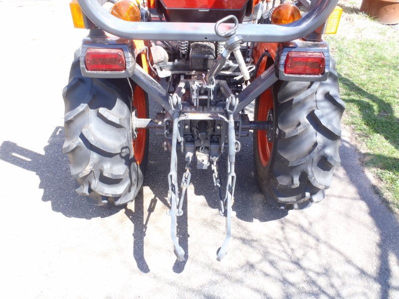

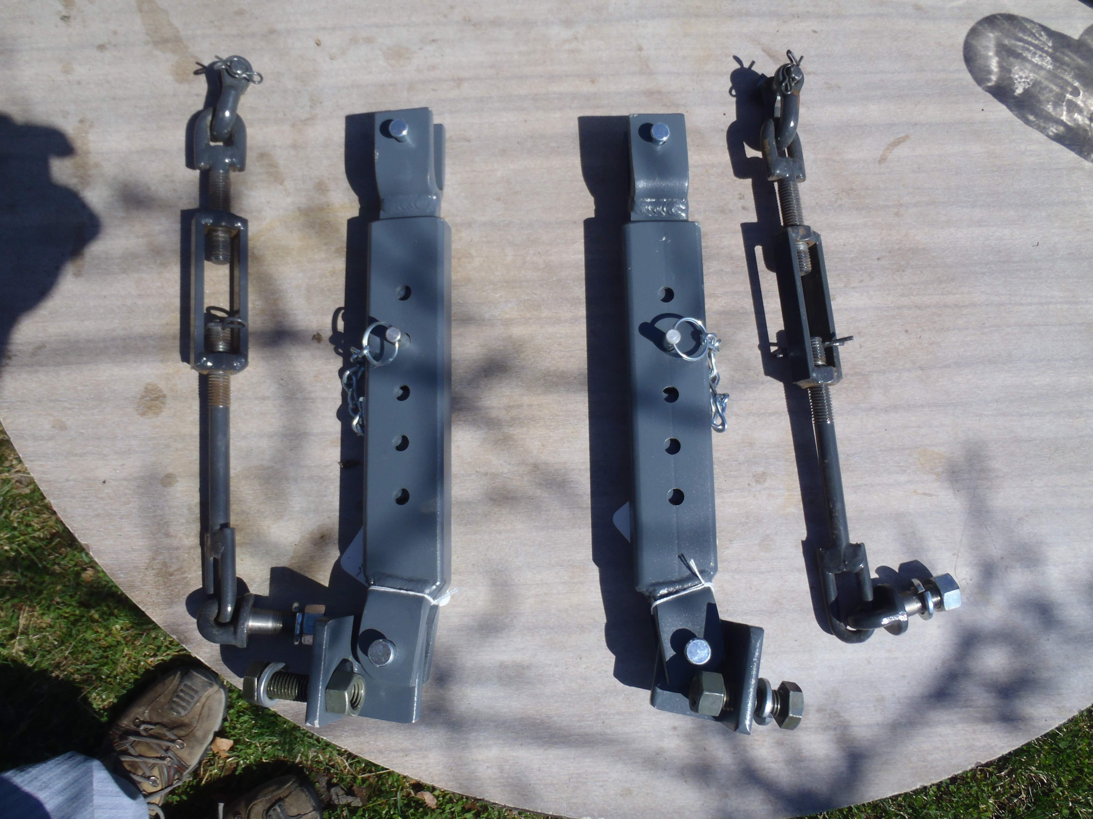

Just installed the Stabilworks on our B2320 and they work great. Much faster hitching up attachments, now. Here's a visual comparison of the turnbuckles that I took off to the Stabilworks. See if you can guess which one is less likely to bend:

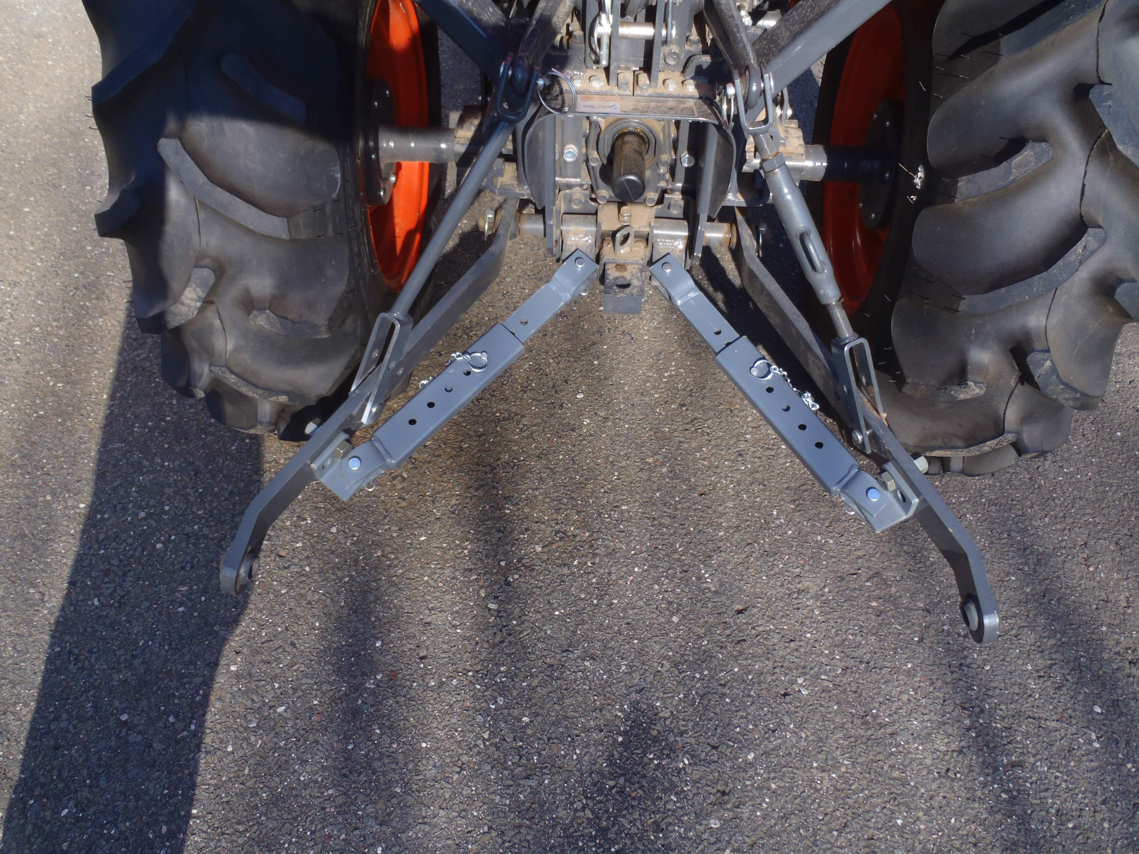

One of the advantages of the pinned Stabilworks is that your arms don't collapse together when you remove the attachment like they will with the turnbuckles:
With the Stabilworks they stay put, making backing up & hitching the next attachment much faster:
