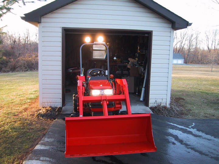

Hey guys. I have wired my 2 off road lights (which I use to illuminate the area while I'm removing snow and mowing at night). They draw 7 amps each (14 amps total). The wire under the seat is the wire the dealer pointed out to me to use. I made a nice connection and FUSED the line right there with a 20 amp fuse. Then I mounted a switch box on the lower section of the ROPS to control the lights (2 switches). The lights are mounted on the top of my ROPS.
It all worked very well for me. Don't know what the warranty ramifications are but that line is to be used as an Accessory line.

I just looked at the electrical schematic for the BX. These wires are labeled as "working lights" on the schematic and it appears that they are on their own 20 amp circuit breaker.
I use these wires to run a sprayer. I put mating connectors on the wires from the sprayer and just plug-in when I want to use it. I also included a properly sized inline fuse (I think 10 or 15 amp) in the wires from the sprayer.
