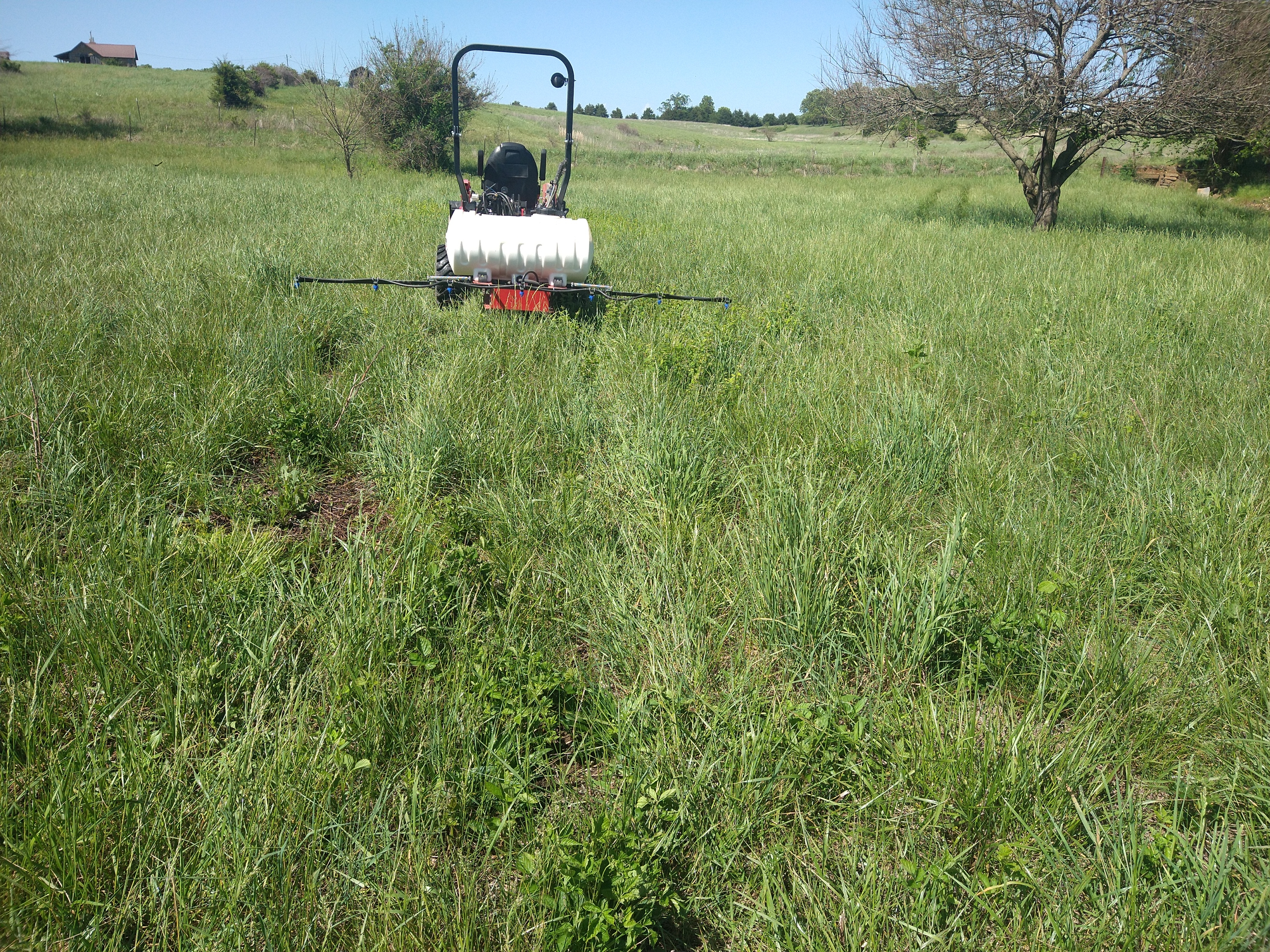

Although you are doing more serious spraying than I do, here is one recommendation. A sprayer mounted ON the tractor makes it very nimble. There's never a problem with short tongues, jackknifing, etc. So far the best for me is the one on the forks. No looking back to watch the liquid level or coverage pattern.

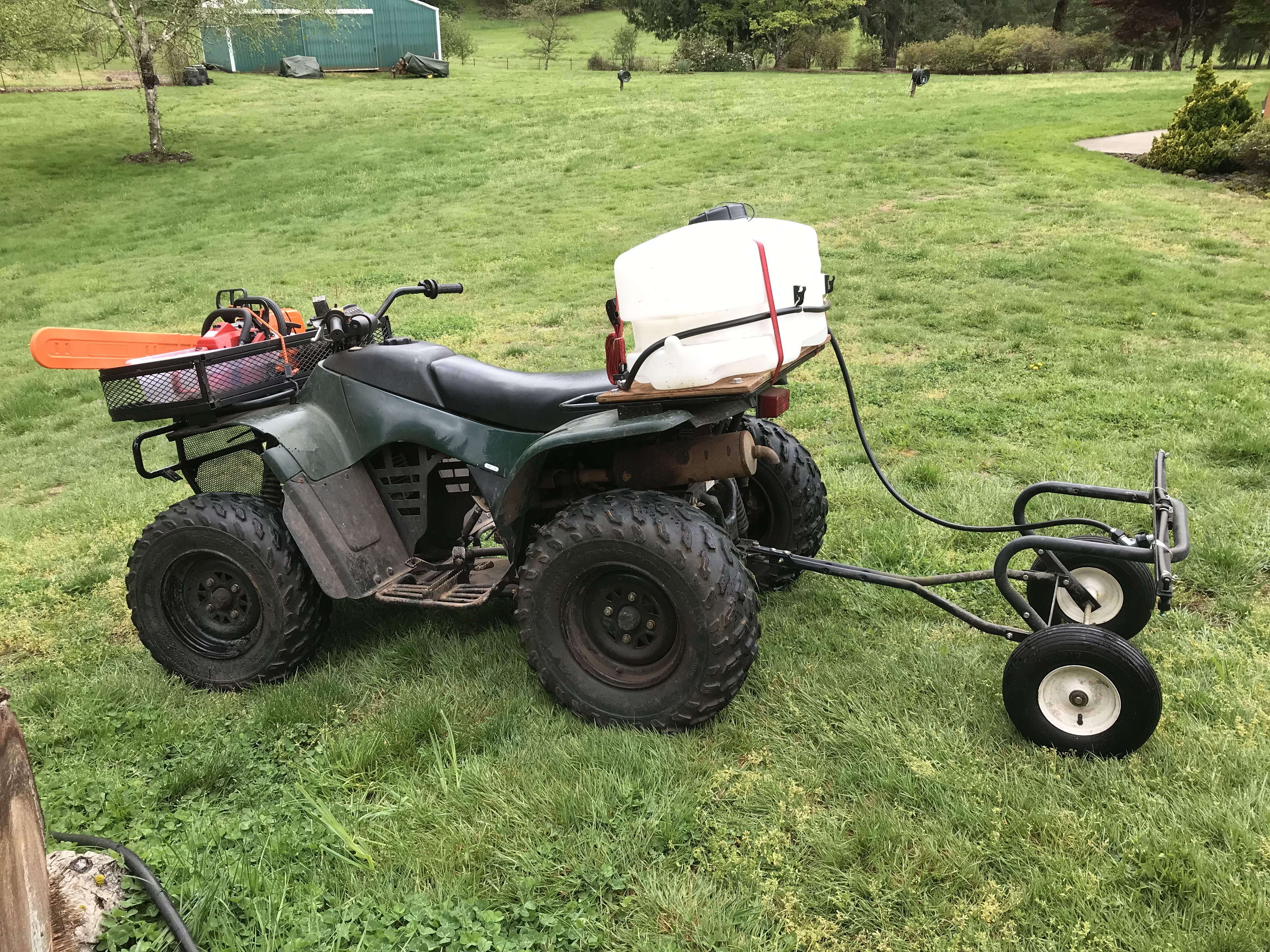

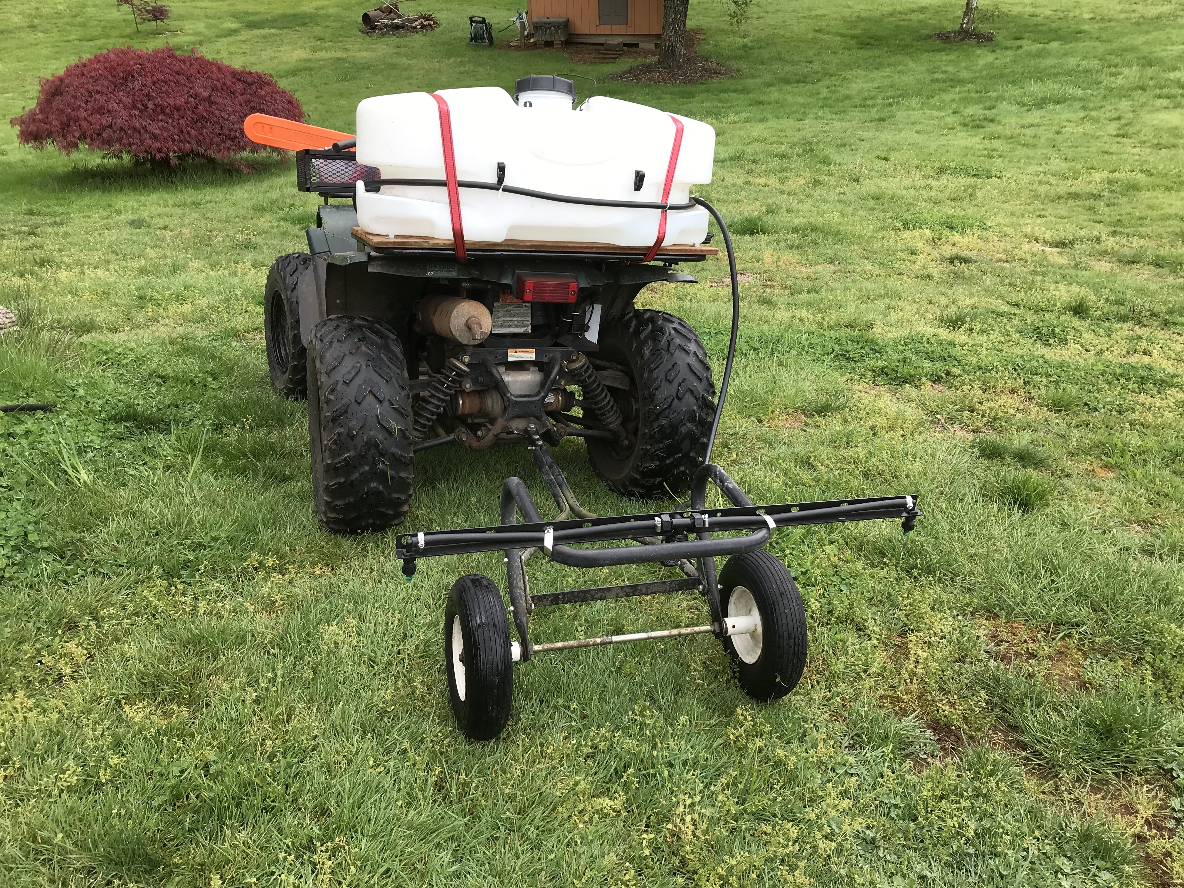

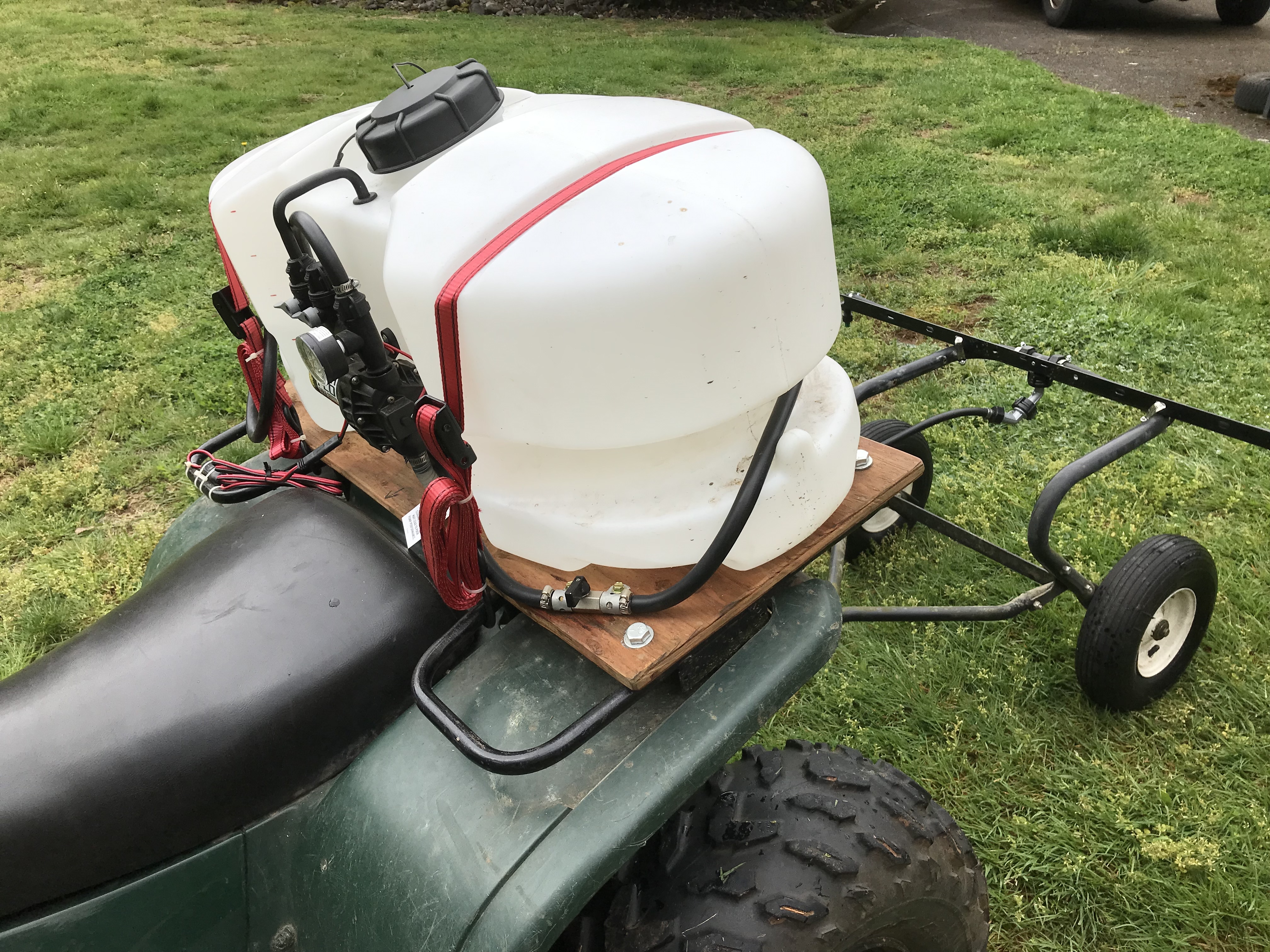

As a homeowner with few acres to maintain I obviously do spraying on a lot smaller scale.
Here is my FIMCO 25 gallon sprayer with Chapin spray boom DIY setup on set of wheels which is towed behind old ATV.
Used it two days ago with only one active spray nozzle to spray blackberries etc. along a fairly long fence-line.
With two nozzles it can spray 7' width according to Chapin and is working very well for our needs.
The wheels etc. are what's left of busted fertilizer spreader.

Gotta say, that’s unique. Never saw anyone have a tow caddy for just the boom!!
