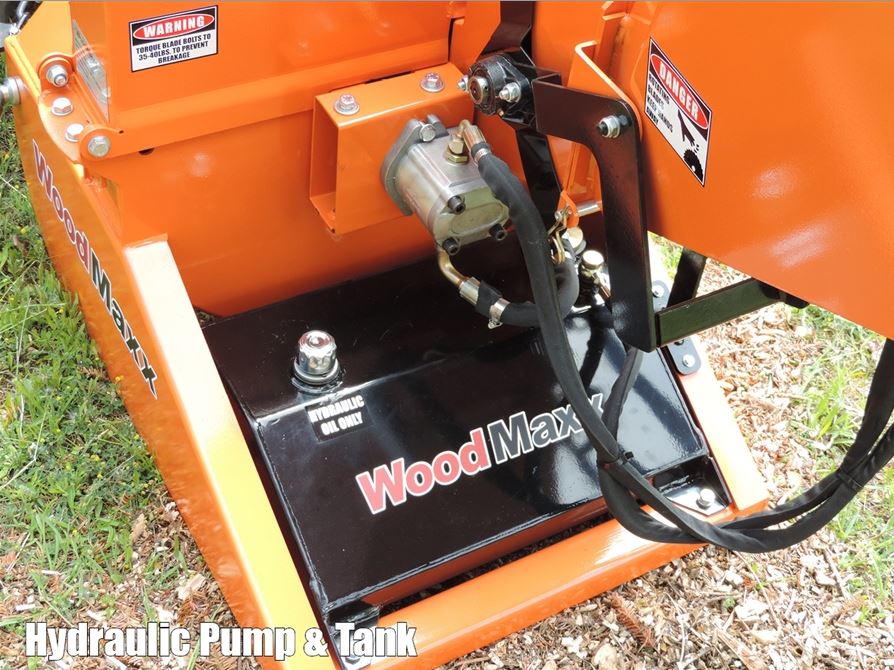

   / Splitter question #6
The tank on my hydraulic infeed chipper is below the pump. See pic... tank is black and pump is just above it:
   / Splitter question #7
Not surprised that it worked OK for you with the small tank. The main concern with hydro fluid reservoirs is making sure that you have enough hydro oil in "reserve" to keep it at a usable temperature -- if there's enough to fill it, it will run, just without enough in reserve tank, the same oil keeps getting recycled and it never has a chance to cool down. More fluid doesn't make it work "better" just "cooler" in this particular case.
Similar to what rswyan said, I've heard reservoir size should be 2-3 times pump gpm unless there is a dedicated heat exchanger. BUT, I don't think splitters run the same way as other hydro-powered equipment -- slower stroke, fewer strokes per minute, etc., so overheating may not be that big of a problem for splitters -- I just don't know.
However, if you have to fix it anyway, I'd increase the size.
