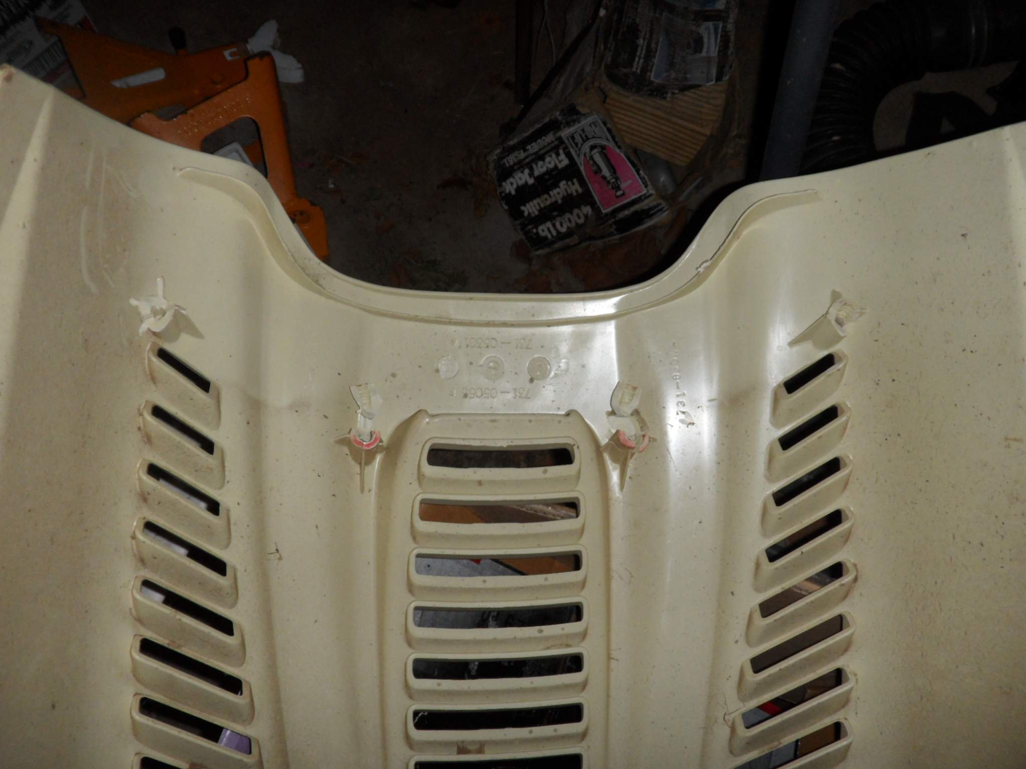

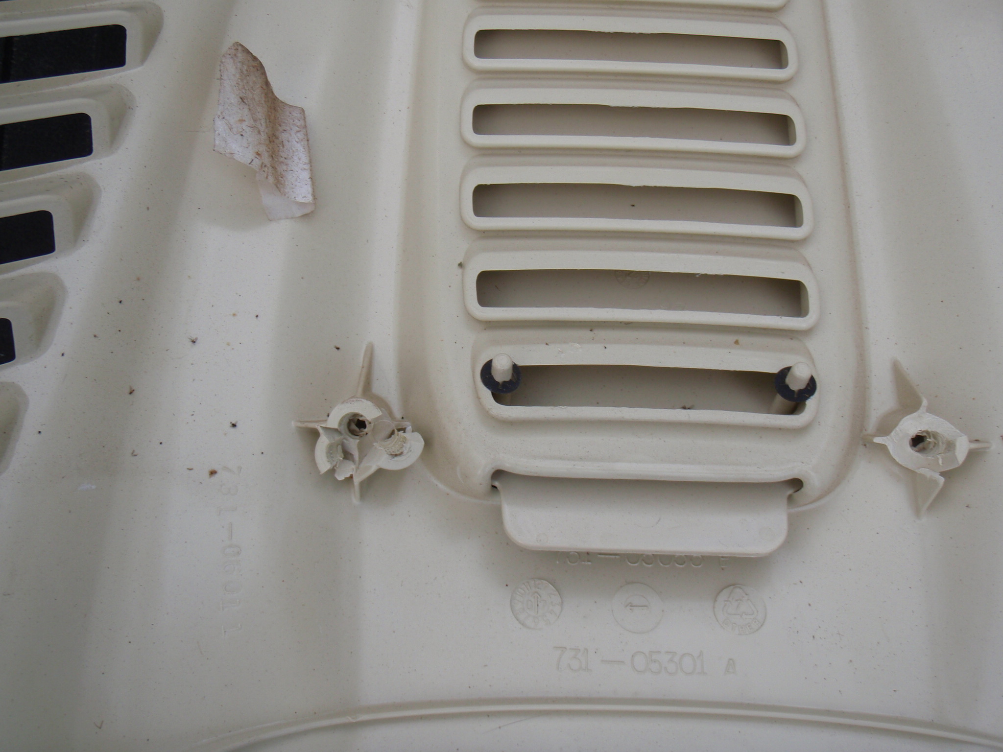

I went into the garage today and noticed that I'm going to be on hood #3 as well.
Mine is a 2008 GT2554 that I bought new. The first hood let go at the hinge within 20 hours of use. The dealer said it was from overtightening at the factory. Okay, fine. Two weeks later I got my Cub back from the dealer and finished the mowing season. The second hood made it through 2009.
Last year we moved across the state and the Cub didn't have more than 10 hours mowing time the whole season. It was last used about September and then parked in the garage. I went out today and noticed it had popped up at the back. The studs molded into the hood had split and the brass nut insert had simply pulled out.
I had intended to pull the gas struts off the hinge mechanism to try to prevent this from happening, but didn't get around to it.
I don't think this was a entirely a heat related issue as much as it is due to the constant stress of from the gas struts pushing against the closed hood hinge. Heat may have been a catalyst, weakening the plastic to the point the hinge tears the mounting studs apart.
Ultimately, the hood is an extremely poor design. The hood and several other issues will make me think twice about any future Cub Cadet products.
My warranty is about to expire, so hopefully I can get a new hood. First, I'm going to remove the gas struts; then I'm going to try to make a lightweight frame out of steel tubing or aluminum angle that connects the hinge to the latch to remove any stress from the actual hood itself. Essentially, the hood would simply sit on the frame and not have any actual load placed on it...
The photos are of the first and second hood (003 and 1461, respectively) broken at the hinge location. The second hood, installed by the dealer, did not have the plastic block off plate over the center louvers.

Make sure to ask for the hood reinforcement kit that Cub came out with. If I get a chance I'll try to find the number for you.

Update to 5/30/2011 post.
I called the Cub Cadet dealer where I purchased my GT2554. The service department would warranty a new hood (and decals). They also said there was a hood brace kit that was released in the summer of 2010, which they would install. I now have to take it from Southwest Oklahoma to Northeast Oklahoma.
Interestingly, the fellow I spoke to in the service department noted that the week prior he had a customer that brought in two GT2500's; both of their hoods had broke.
The hood brace kit is supposed to do the trick. Maybe I won't have to make my own after all...
