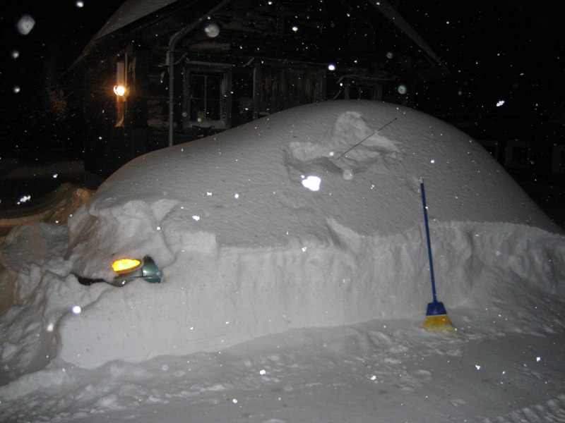

Once again just a friendly suggestion, 84 inch on a 45 hp tractor is a bad idea sure it will run it but you'll probably be going slow in anything over 8 inches of heavy wet snow. When you buy a snow blower you have to look at PTO horsepower not engine horsepower my old TC 40 had 40 at the engine and only 34 at PTO, I couldn't imagine it running an 84 inch unit. My new tractor 60 HP and 51 at the PTO and I wouldn't want less on this 84 inch unit. I had a 72 inch front Mount snowblower and it was just perfect for the TC 40 even with Valentine's Day 06 storm 47 inches. Basically what you'll sacrifice in inches of width you'll make up in speed and not overloading the tractor. New Holland claims TC 40 can run and 84 inch after two sales my dealer won't do it again, he even had a gentleman with the TC 48 complain the tractor was bogging down with 7 foot unit once again just my opinion, and you know what they say about opinions :) take care
P.S. just the famous photo of Valentine's Day storm 72 inch snowblower used, it beat digging by hand and shovel LOL
