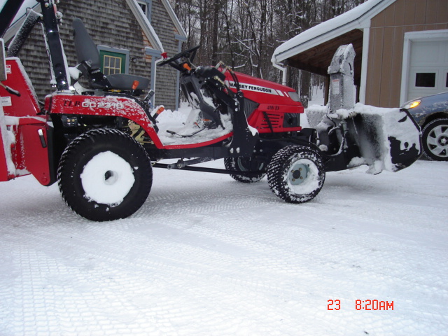

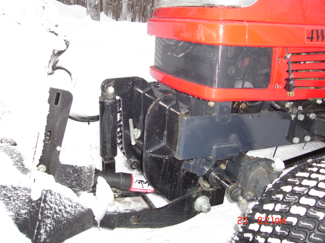

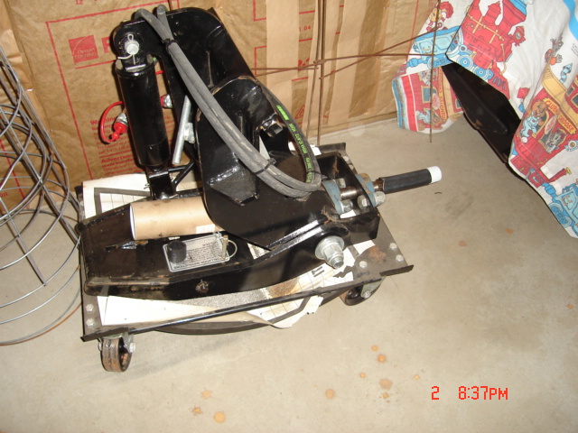

Here's some pics of the quick-hitch; Kubota's is slightly different, but the same idea. You'll love it when you get it.

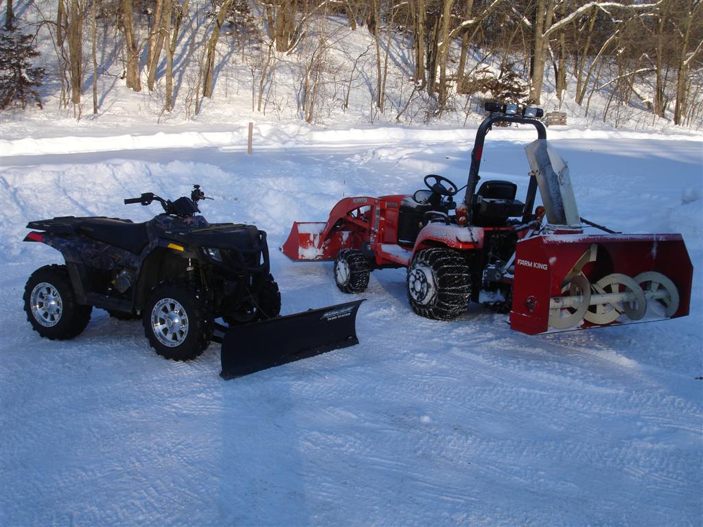

Have you considered a rear mount blower? They are not as comfortable to run but they allow the FEL to stay on and they are MUCH less money. Unlike with the front blower, there are numerous brands to choose from. I ended up with a 60" unit and am glad I didn't go any narrower.

fish6942, Yes that is a very good option, I will go for the front mounted one.

You will have to take off the front bumper to mount the quick hitch.
Please send us pictures when you get everything mounted.
