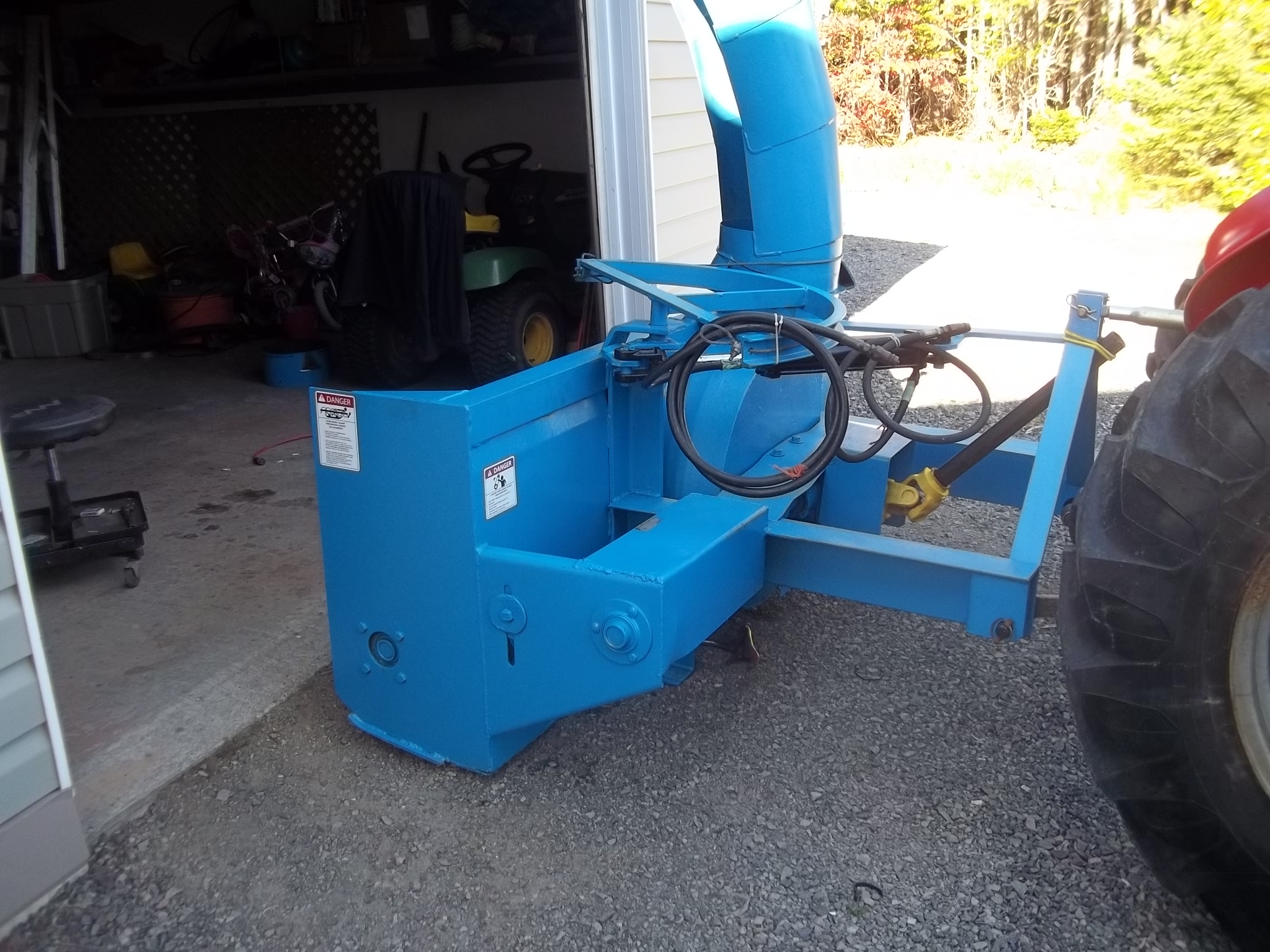

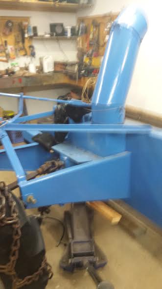

Hi Fellas,
I bought this snowblower last fall off a guy and did a few minor repairs and used it last winter.
It works fine, however their were no stickers , decals or company logos on it and I am wanting to find out so I can order parts later on.
Does anybody know who's company build it? I checked with Lucknow and Allied farm Equip. and they say its now theirs

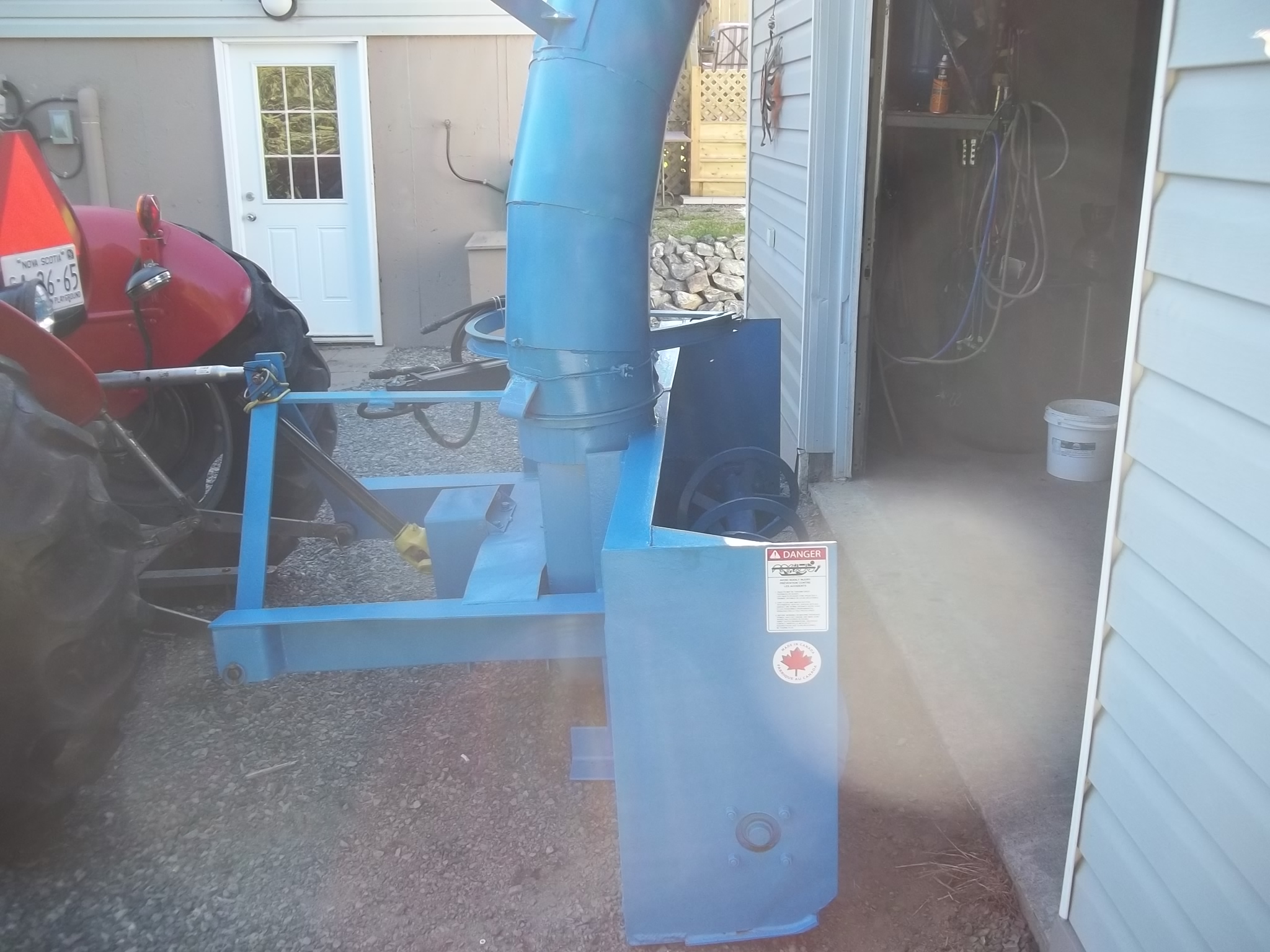

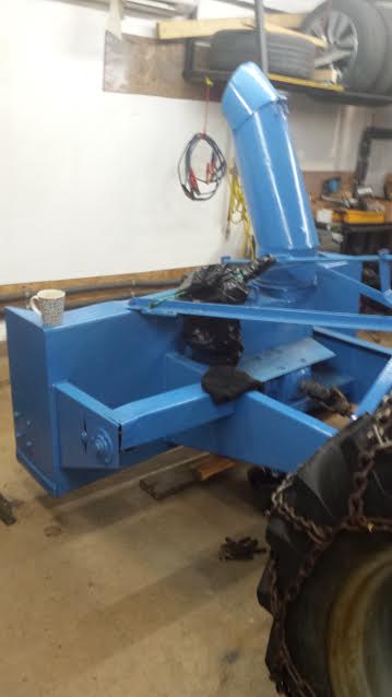

Hi Dave
Its a 6 ft. blower and the gear box is a italian company its the same one I had on a lucknow blower i used to own. 1 3/8 6 spline shaft. the pto shaft is not metric and does not have any shear pin or slip clutch. I'm replacing that before the winter. here are more pictures.

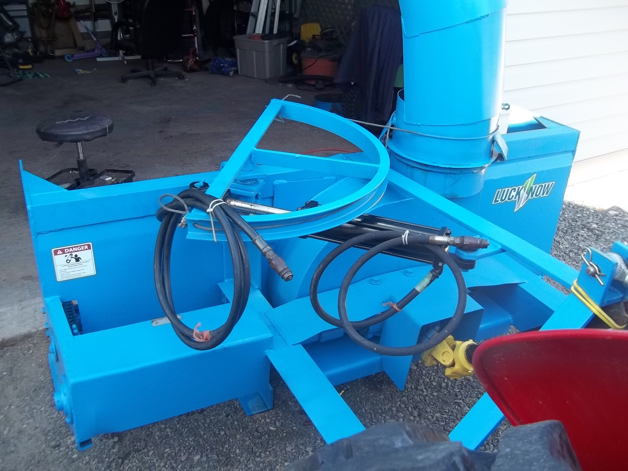

   / Snowblower I.D.
sorry wrong pictures. that was my old blower
