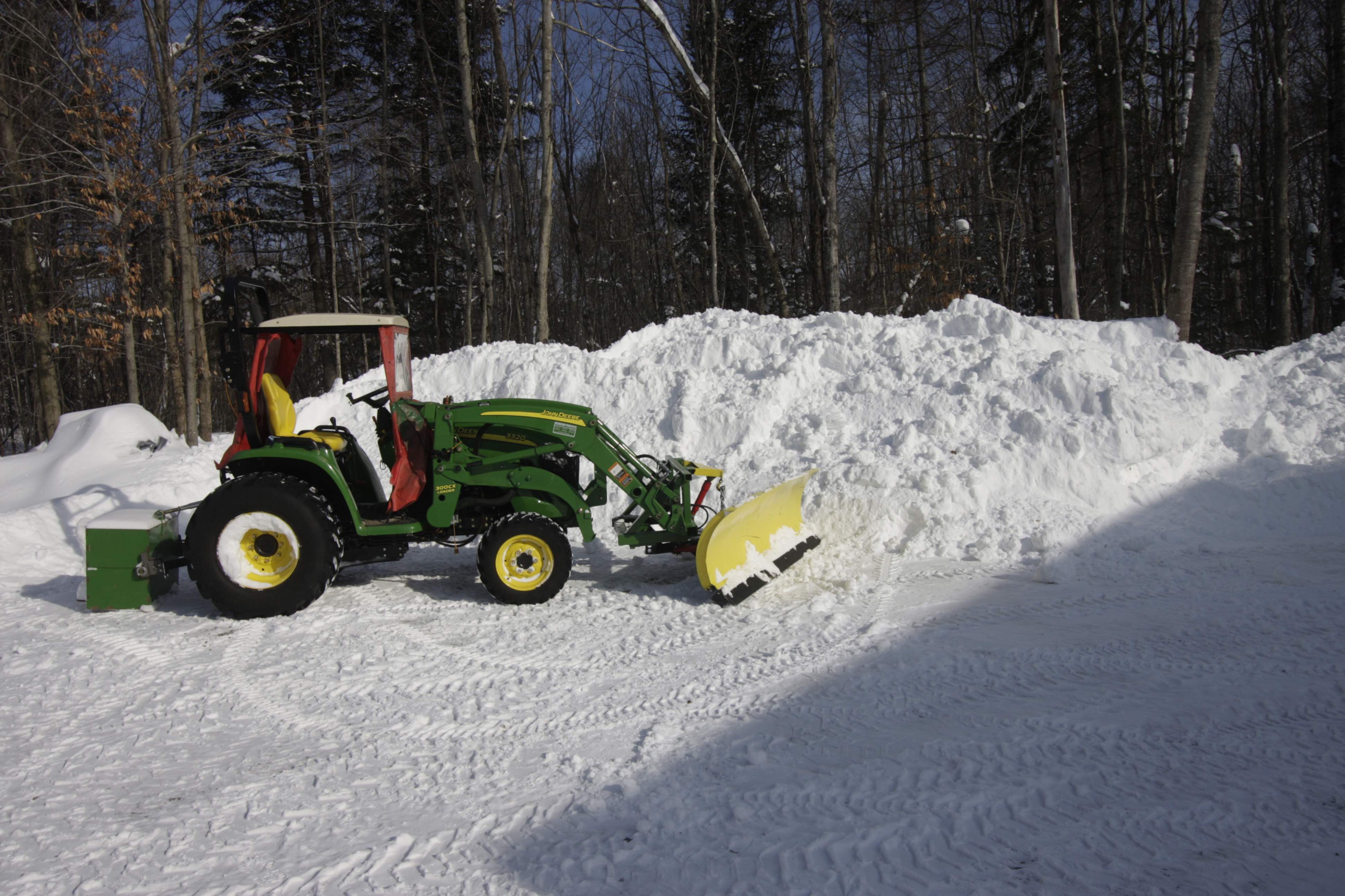

Hi Mike,
I push a 7 1/2foot Fisher with my JD3320 with no issues.
