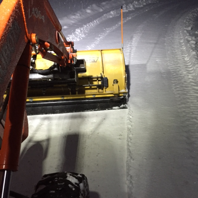

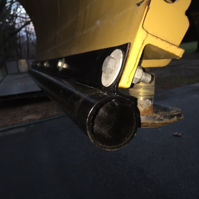

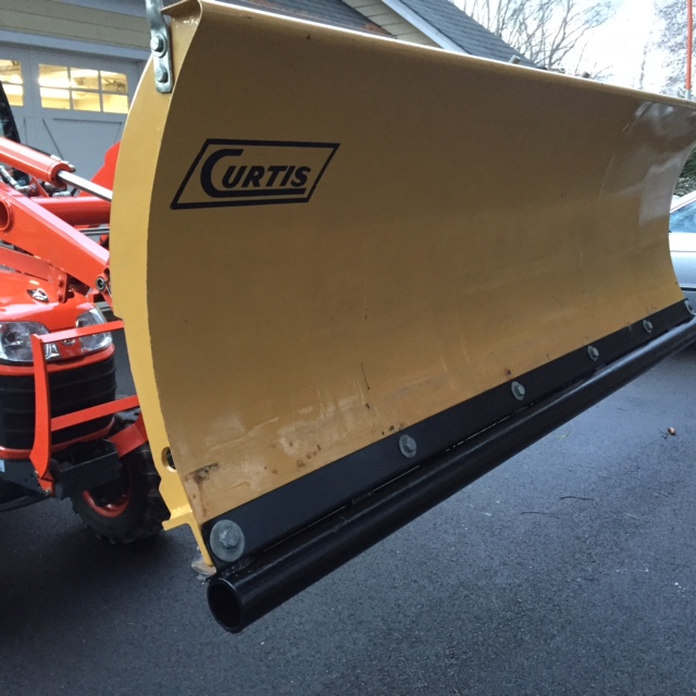

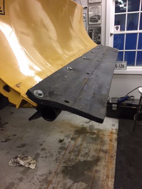

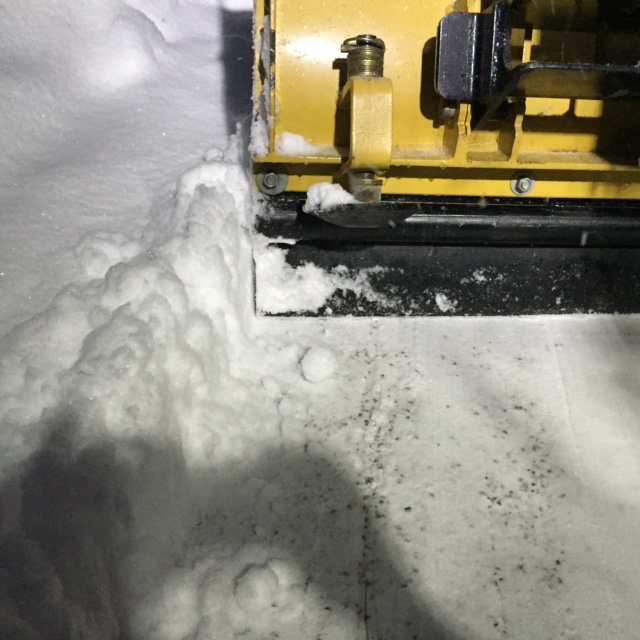

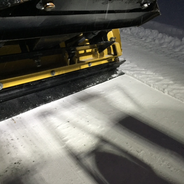

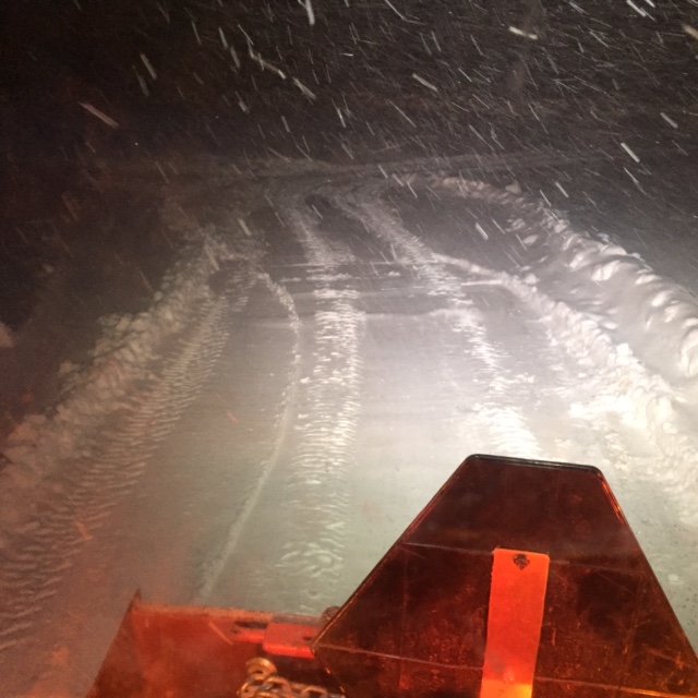

So we get about 12 inches today here in CT - if you listen to the newscaster you would think the world is about to end - just ridicules :laughing:. However - being the first snow fall of the year I was anxious to try out my new idea of using the round 2.5 inch steel pipe (tried plastic once and it didn't hold up) instead of the rubber horse mat that served me so well in the past (rear blade) and last year it was "just" ok with my front blade since I bolted the mat right against the cutting edge so there was a prominent 90 degree bend when the blade was touching the ground. So, this year I decided to try just a round pipe on my front blade (I read the round pipe also worked well) - well I was very very displeased with the results - I found the pipe dug in too much (even in the float position) and I tried different angles. So, out to the barn I go and bolt the horse mat up against the round pipe and WOW :thumbsup: - I am beginning to think this will be the bees knees since the mat folds around the pipe with less stress then when bolted to the cutting edge. It is just so much more forgiving.
I am doing the happy dance :cool2: - it works fantastic - it leaves what I can only describe is a beautiful skim coat of snow on the top of the gravel. Again - the horse mat is a home run. Read Blade and / or Front blade with about a 6 inch fold under the blades - I highly recommend. I honestly dont think there is anything better than using the mat on gravel let alone its cheap and wears like iron!

Did my first plowing with a piece of split 4" pvc slipped over the cutting edge today. Was very pleased with the results. We got around 8" but with all the wind, there were some drifts near 2'. I'm ready for spring.

what kind of plow is that and whatd it run ya? is it using the kubota pin-on QA?

Matt,
It is a 72 inch Curtis Front plow originally for a L series (another wonderful Craigslist find) - I had it modified by a welder to adapt to my Kubota Pin-On Quick-Hitch Adapter - works awesome.
Take a look at this previous post.
http://www.tractorbynet.com/forums/kubota-owning-operating/326523-b2920-curis-snow-front-blade.html
I just did a quick search and found this - not sure if this is of interest however I paid $900 for my blade (which sat brand new in a barn) and had to add hydraulics as well as some welding work to make it fit the width of my loader arms. In my estimation I think this is a excellent price :thumbsup: - not sure I understand the $3.00 shipping though :).
