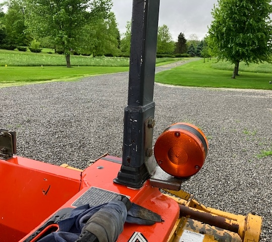

If you decide to cut the ROPS or modify it, thought you might want to take a look at the design of the early Kubota B series ROPS. Simple design with a flared-out socket that just drops over stubbed-up channel steel right above the fenders. Two big bolts on each side with easy access removes it or secures it back on. I've removed mine a number of times when working in an area where I didn't have enough headroom.
Easier to fabricate than a folding bracket setup. . . Will try to attach a pic.

If your ROPS is like these JD 790 photos I found, it looks easy to shorten the uprights without hurting the strength at all.

Could you take it to a welding shop and have them cut and install the metal tabs to make it a foldable ROPS? Pond look hardened, but rest of it just looks like 1/4” plates welded and drilled.
   / Smaller rear tires to lower tractor ROPS so I can fit into my trailer when hauling #48
Yes, I've been looking for a folding ROPS to swap out but didn't see one for the JD790.
Find a good fab man and have him design a folding ROPS and build it. It's not rocket science
   / Smaller rear tires to lower tractor ROPS so I can fit into my trailer when hauling #49
Don't overthink the problem or solution. if you have a welder and some basic skills you can fix this pretty easy. You need the tools, a section of square steel tube just big enough to fit over the current rops tube and some hardened pins .
Cut the current rops side tubes off about 8-10 inches from the top
Cut the new larger tube into two 8 inch pieces
Slip the large tube over the lower section of the rops so it overlaps by 4 inches and weld around the bottom edge, do this to both sides.
Insert the top section of the rops into the new tubes, make sure it is seated all the way down and drill holes for the pins.
Now you have a section rops that you can pull apart for transport.
