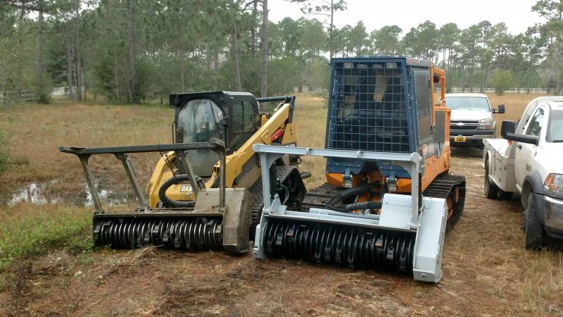

Can you rent a tracked machine with a forestry mulcher?
With that you would clear anything up to the capacity of the mulcher, around 4", then drop the big trees to pull out.

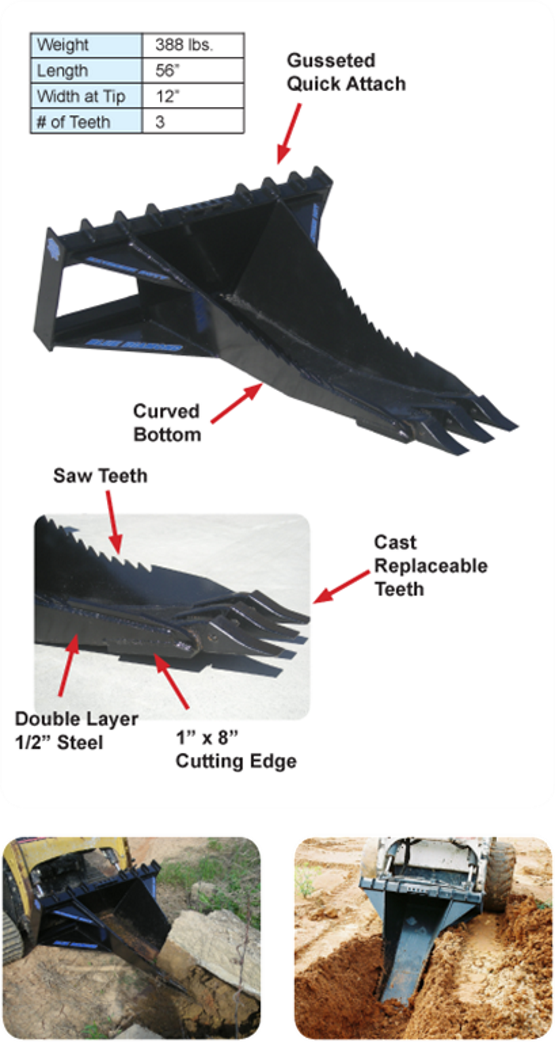

See if they have a stump bucket:

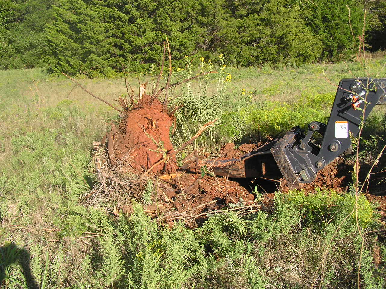

I use one for removing stumps:

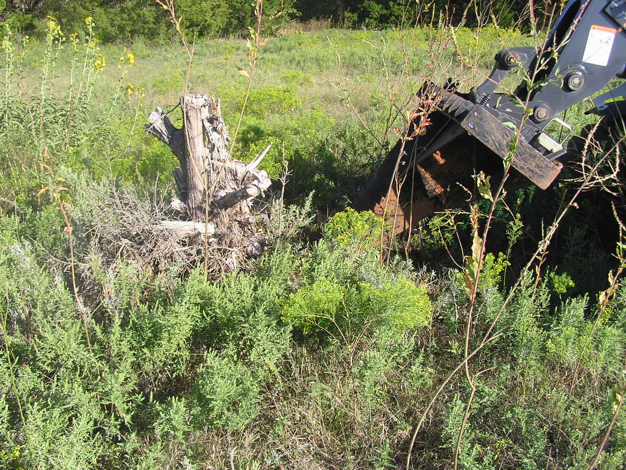

And cedar trees:

Buckets don’t do well for removing stumps. Been there.
I bought an excavator. People speak well about stump buckets, though.
the type of stump you are removing should help define the proper equipment. Tap roots are tough.

A skid steer with a stump bucket works pretty good if it’s got the traction to work. If it’s steep or muddy it’s not so good. A mini excavator would be way better. But as you mentioned renting is pretty expensive. You’d probably be better to just hire it done.
