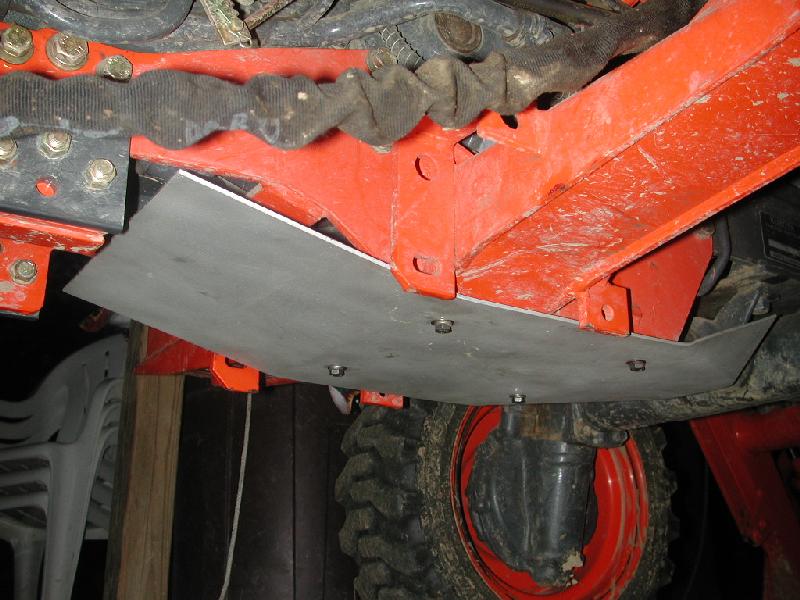

Hi,
Well today I got around to making a little skid plate to protect that plastic cover and a little more under the front of the tractor.
Made from 1/8 aluminum plate that I had, a piece that was 12x27 inches. Actually turned out pretty good. Held on by four 5/16 inch stainless bolts, upped from 1/4 inch per the suggestion earlier in this thread. Not as strong as steel, but certainly stronger than that flimsly plastic cover!
Here's a couple pictures: The first is the underside without any protection except for what the loader subframe provides...

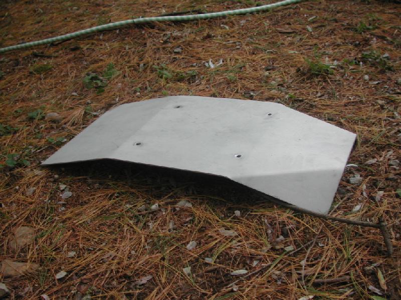

   / Skid Plates/Belly Pans Anyone?
#18
The second is the plate ready for installation.
I drilled four holes in the loader subframe and tapped them. On/off is about 2 minutes either way. Needs to come off to drain the oil...
#19
This one shows the plate installed....

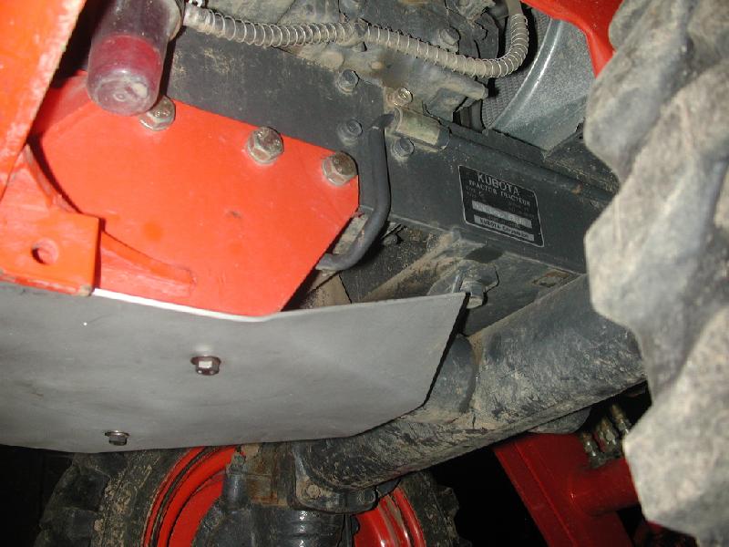

#20
Final shot, of the front that sort of wraps up behind the front axle, hopefully out of the way of most things that might want to grab on to it...
Plan to make something to protect the rear half as well. But that will need to be wider...probably about 20 to 22 inches, and will most likely be made of steel plate...in the end, but plywood in the interim I suspect.
Note also that the fuel filter is still out there and lacking much protection.../w3tcompact/icons/frown.gif
Bill
