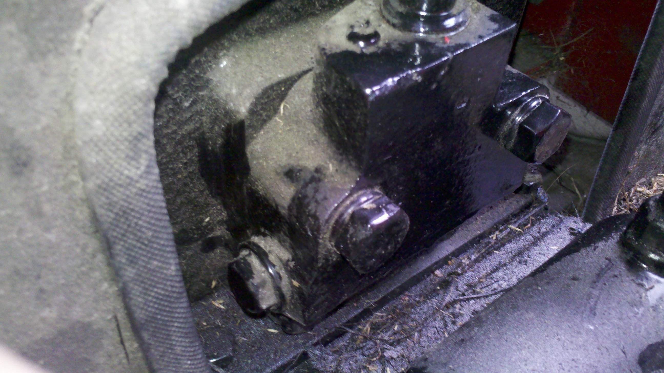

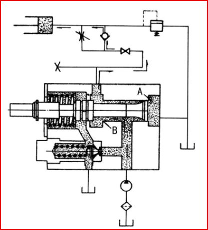

1. In the manual it explains the 'standard' set up will operate a tipping trailer. I think standard is without the double acting valve fitted. Instead it seems to operate from a valve that is used to operate the 3 point linkage. Picture of valve attached.
In the diagram I can see where I might connect (T leading to a x) but on the valve I can't see where I might connect to. I was hoping someone might have experience and be able to advise

Where exactly is this double acting valve fitted on your tractor? Do you have a picture of that?
The first drawing you show looks like the standard 3PH control valve, and the second is a picture of it:) To run a single acting dump trailer cylinder off the stock system, you need an additional pipe added. In the first diagram you posted, that pipe with a quick coupling fitting is plummed into the system where the "X" is shown on that diagram. The cylinder above the X is the 3PH cylinder, and the 2 valve diagrams to the right of the cylinder represent the speed regulating valve which controls the lowering speed of the 3PH to keep you from dropping a heavy 3PH impliment too quickly. That valve is located on the front of the hydraulic reservoir right down in front of the seat and has a round knob like a water faucet on the top. Can you take a pic like the second one of the valve, but zoomed out a little and panned to the right to show the area in front of the reservoir?

Your last reply confirmed quite a few points for me. In regards to the schematic, there was one thing throwing me a little. I understood about the restrictor to control the return of the oil flow but not the symbol that looks like 2 triangles facing each other. In my work (pneumatics) this can represent a ball valve. So I thought I can shut the restrictor but where's the ball valve. Probably a miss-understanding on my part.

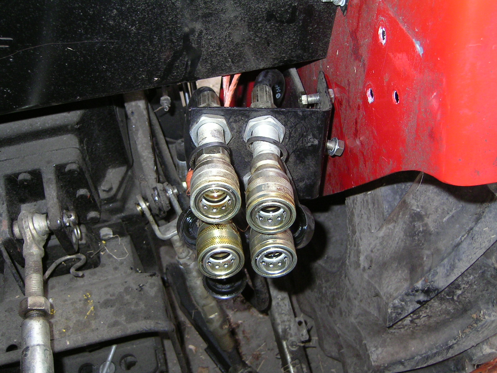

I was greately encouraged by your pictures. Your control valve looks similar to mine and I can relate to where you decribe the dump trailer feed pipe to be. This weekend I'll remove a few bits & pieces so I can get a clear view around the restrictor and take a picture. In regards to the double acting valve I'll take some more pictures this weekend also. In the mean time I have a shot of the quick release couplings (4). I think its actually to double acting valves side by side. They are positioned at the rear of the tractor in a similar position to the single quick release coupling shown in your picture.

Looks like you have two rear remotes, each a supply/return to control a double acting cylinder, each connected to a double acting spool control valve with a lever, or a joystick to control the two circuits.
If so, your dump trailer should work on the installed valve, unless it has some sort of load check internally and is too restrictive for the weight of the bed to force fluid back thru. IE the fluid has to be forced back thru, like the fluid being pushed back from the back side of a double acting cylinder...
Not sure about the dual triangle symbol, that also indicates a valve to me, but I know of no valve in the circuit between the control valve and the speed reg valve down in front of the seat.

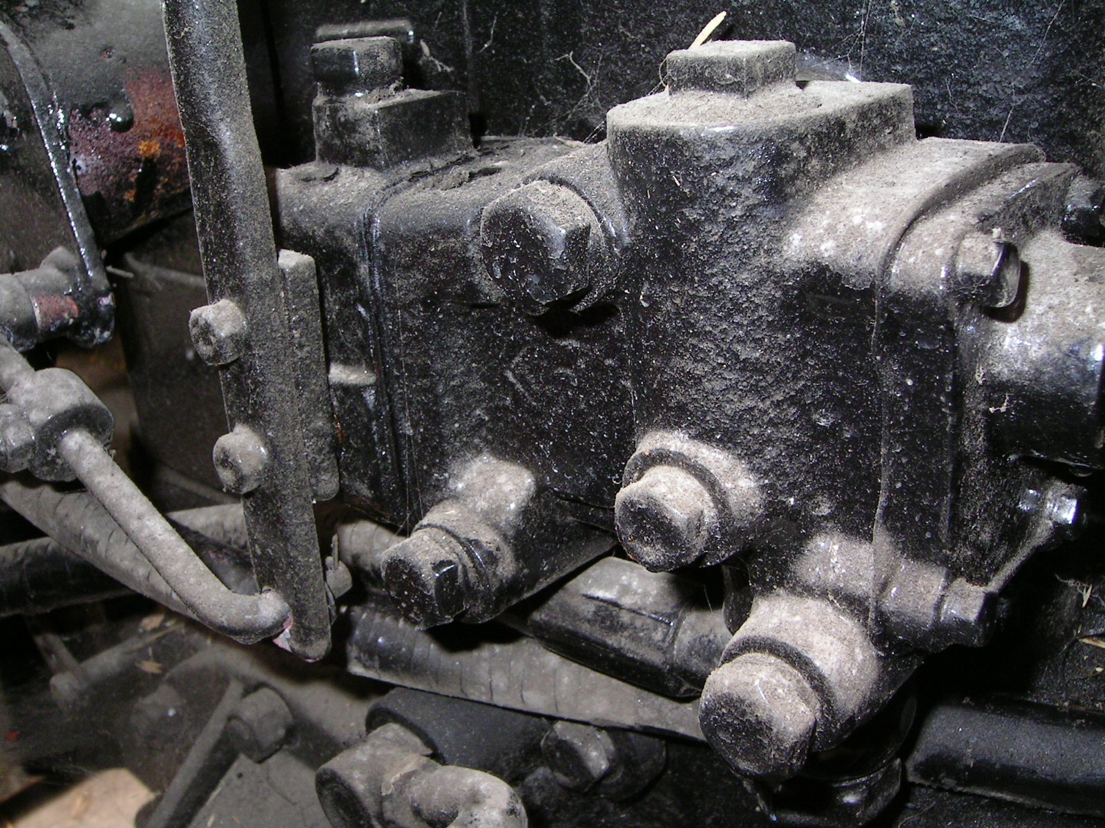

I'm fairly certain we have the same control valve. I took out the bolt you identified as feeding to the dump trailer and as expected it was just a blank.
So this is the plan. The 2 valves that go to the 4 quick release connectors can stay in place (not doing any harm as I can see). I'll get a pipe made up with a banjo fitting the same as yours and terminate it with a female quick release coupling that I can mount near the others (similar to yours).
In your picture it shows a solid pipe from the banjo fitting. Where does it change (assuming it does some where) to flexible?
One thing I didn't expect was the thread type on the blank. I measured it as M18 x 1.5.

SO that pic you just posted is of the speed regulating block on the front of the reservoir down in front of the seat?
M18X1.5 sounds about right, that is a typical metric banjo bolt fitting on these tractors. The pipe on mine is solid from banjo all the way to where the quick connect is attached to the pipe. It is about located where your 4 quick connects are seen in your pics. You could make a pipe and banjo, or some other type banjo adapter to get fromthat metric port to the QC connection. Once you do this, it should simply be a matter of screwing that speed reg valve closed, then the 3PH control will work the dump bed on the trailer. Also a good idea to make sure the hydraulic reservoir is topped off as the dump trailer will probably consume a lot of oil when fully extended...
