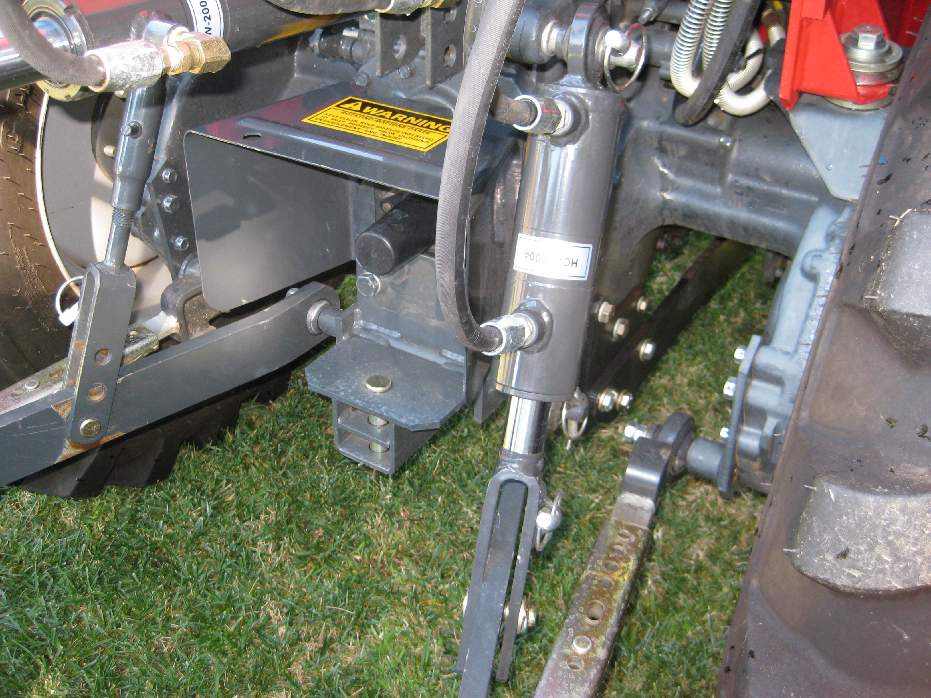

Put a hydraulic side link on it.
   / Side link arm replacement- MF 1433 #3
Like jerry said, a hydraulic side link. If you have rear remotes, it's pretty easy to do. If you don't then it will be a bit more effort and cost, but well worth it in the end. ;)
The side link, hose kit and flow restrictor would run you $300 + shipping.
