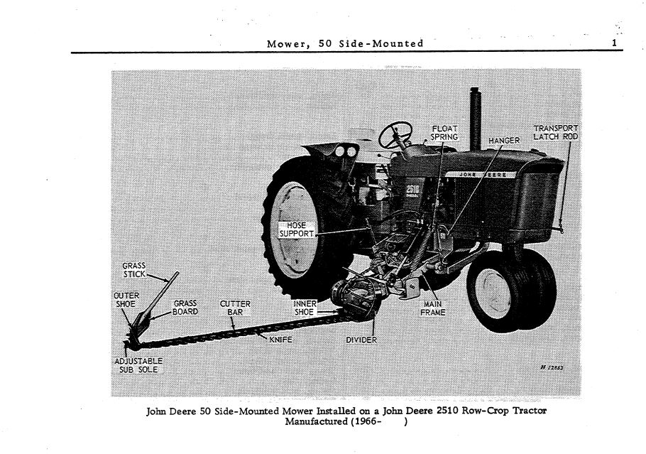

Does any one know if JD ever made a sickle mower that works on side hills?
   / Sickle mower #2
You mean where the sickle is at a different angle than the mower frame? Almost all mowers allow for some slight variation above or below a true flat angle.
If you are looking for a mower that the cutter bar will operate regardless of angle, then you need to get into one without a pitman stick. There may be others, but the number 10 belly mount mower is the first JD one to support this that I know of.
   / Sickle mower #3
Model 50, 350 or 450

Does the John Deere 350 sickle mower mount on a John Deere A Or is this meant for more of a 4010
   / Sickle mower #6
Ken
The JD 350 came with 3 point hitch and works on all tractors with that setup. The JD 450 is the same mower platform on hydraulic wheel carrier. The 450 is good if you don't have 3 point on your tractor. Ken Sweet
