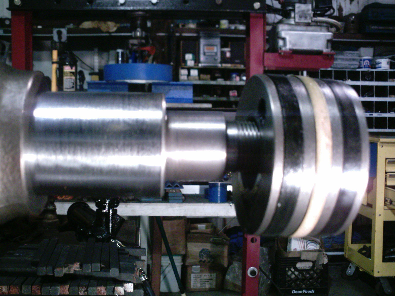

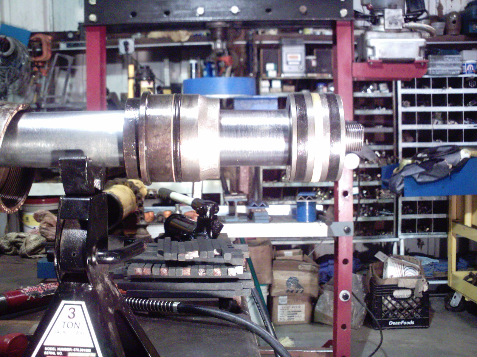

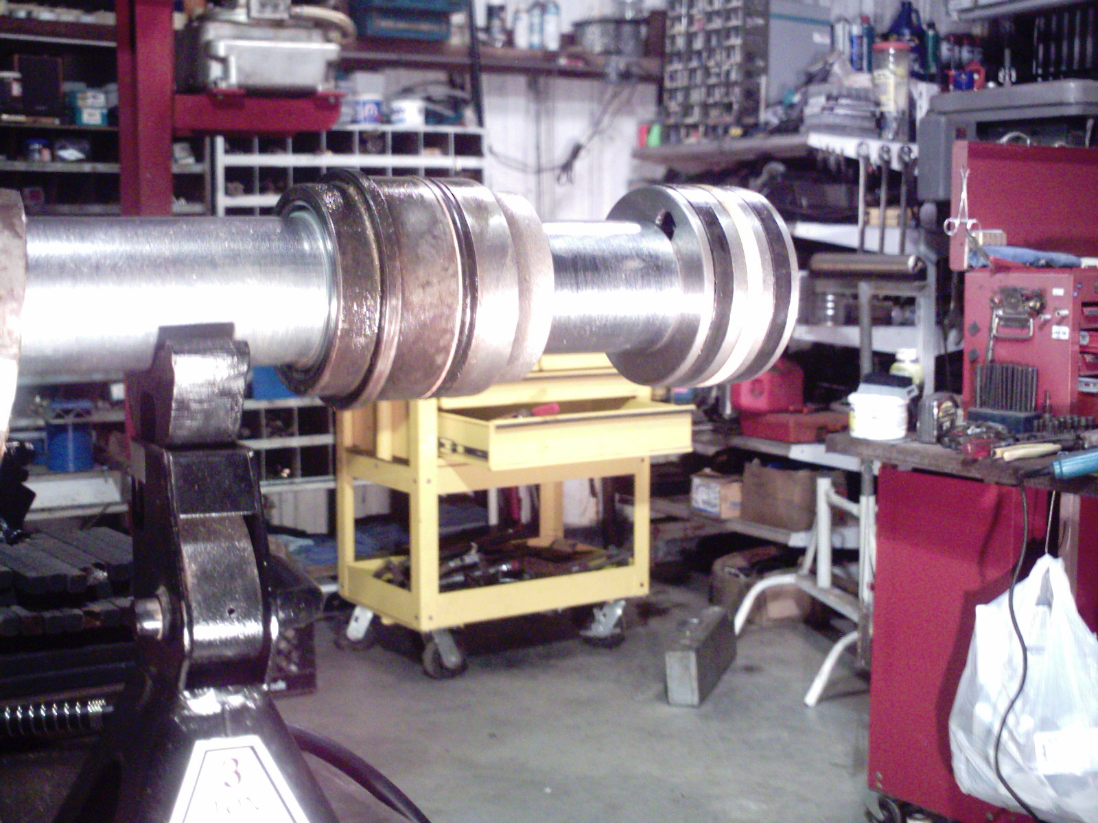

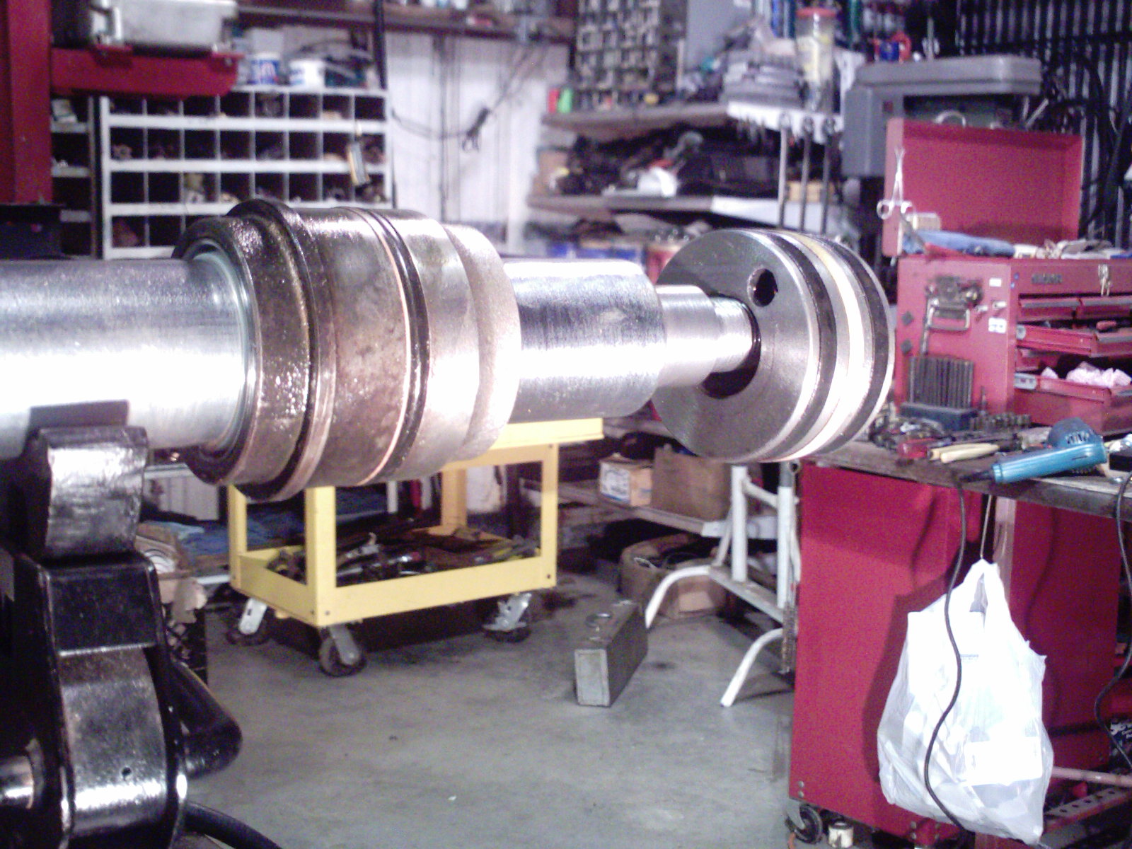

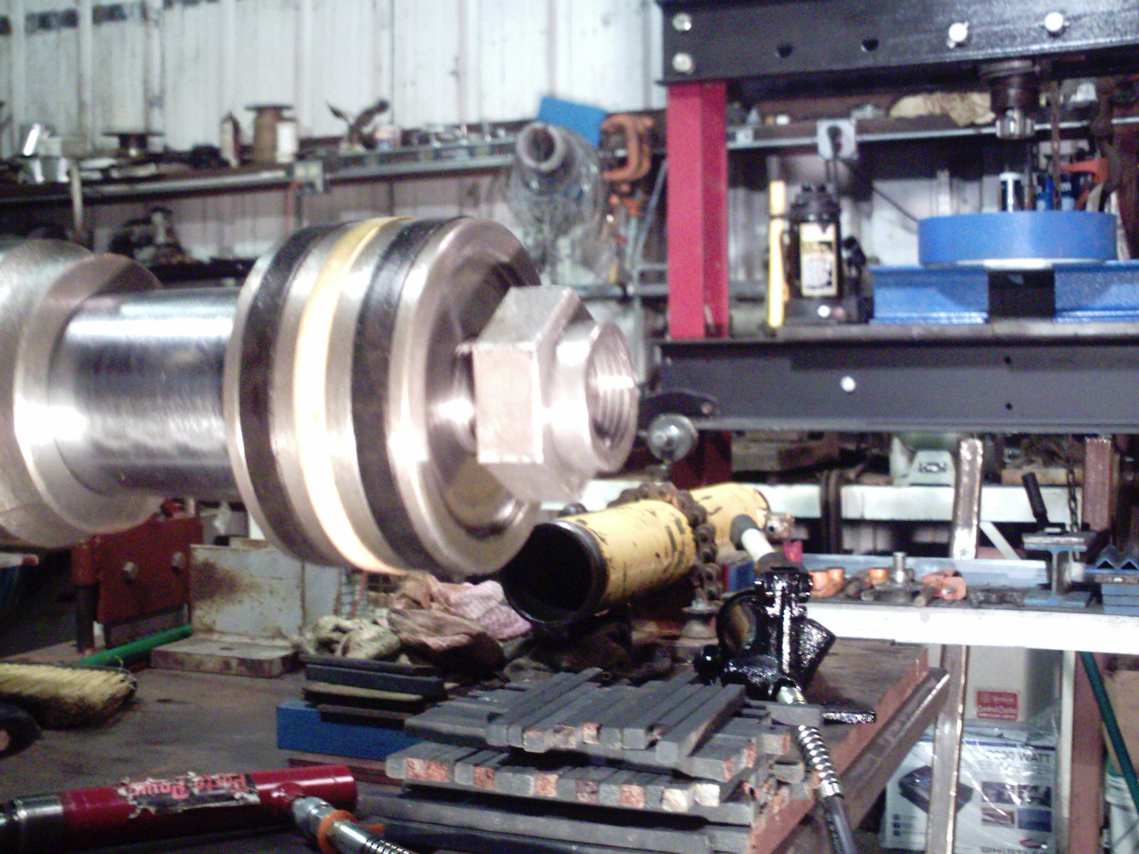

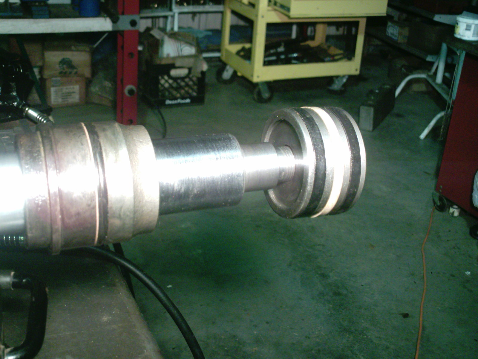

After the large nut on end of shaft has been tightened should the piston still be free to spin slightly?
The threads on the shaft are interference type threads and the nut will hold in place most anywhere
you quit tightening.
The pictures are not the best but you can see the machined shoulder on the shaft that holds the piston,
it appears the piston is made to be able to spin if it needs to inside the cylinder.
Should I allow it to slightly spin or tighten it tight.?
If it matters the cylinder is off my outrigger. International backhoe 1980 model.
I would appreciate any help.

Everyone I worked on did not, some even have a small o ring between the shaft and piston. Wait a little while and maybe WDCHYD well see this, he does this kind of work everyday. The way I look at it, if it well spin it well leak past the shaft and piston.

Why would you ever want a leak around the shaft and the piston. That nut is supposed to have Loctite red or blue on it and very tight.
The shaft and piston however, locked together, can turn in the cyl bore.

A piston should not be able to rotate on the rod, any amount of movement there is a place to leak past. Some designs use an O-ring on the shaft, some have O-ring inside the piston, and some seal with machine surface only. Not sure about this, but it looks to me like that piston is on backwards. That recessed face & shoulder facing the nut looks like it would fit tight over the end of the rod to increase seal affect.
Self locking nuts are used to help keep nut form working loose, but do use Loctite and torque to normal specs. for the thread size of the rod if you don't have actual torque spec. for the cylinder.
   / Should piston spin freely on shaft? #10
Quote:::they seem to think there is no o-ring needed there since there is no groove for it to rest in and would simply be smashed flat if placed in there.
They are right.. If piston face is flat as can be, No oring. If piston has little groove, then oring. Go for it!!!!
