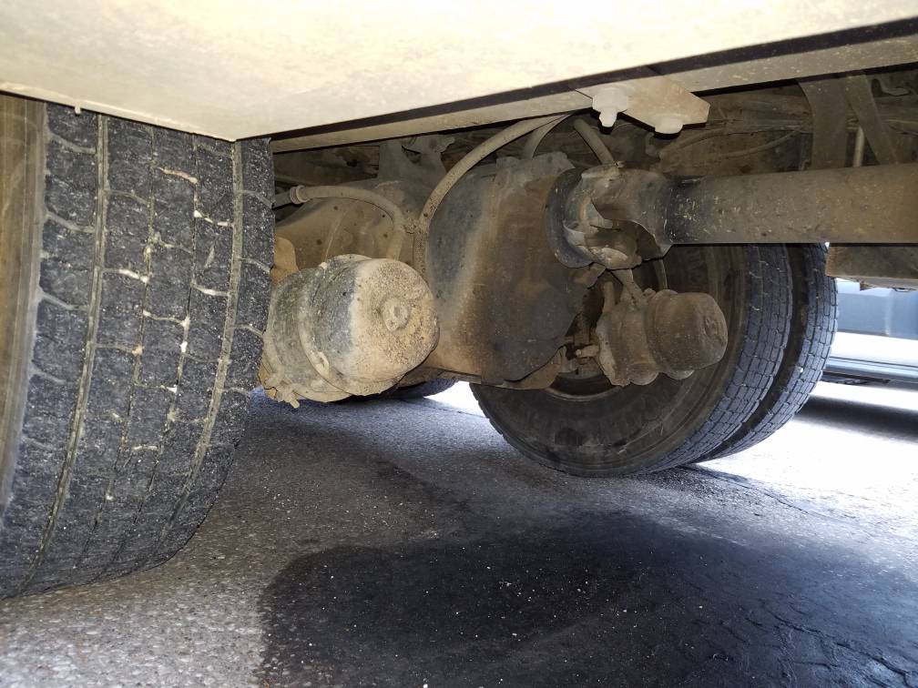

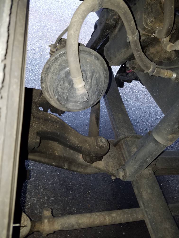

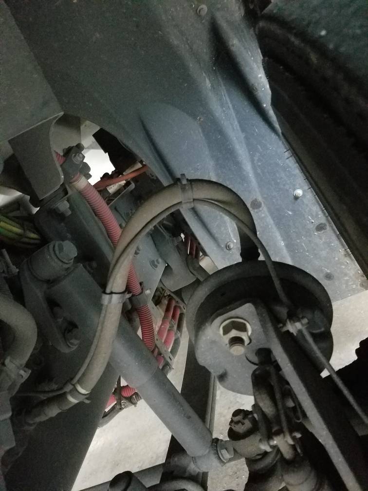

First picture is drive axle second and third are steer axle. On a late model freightliner. 20180926_173025.jpeg20180926_172918.jpeg20180926_173113.jpeg

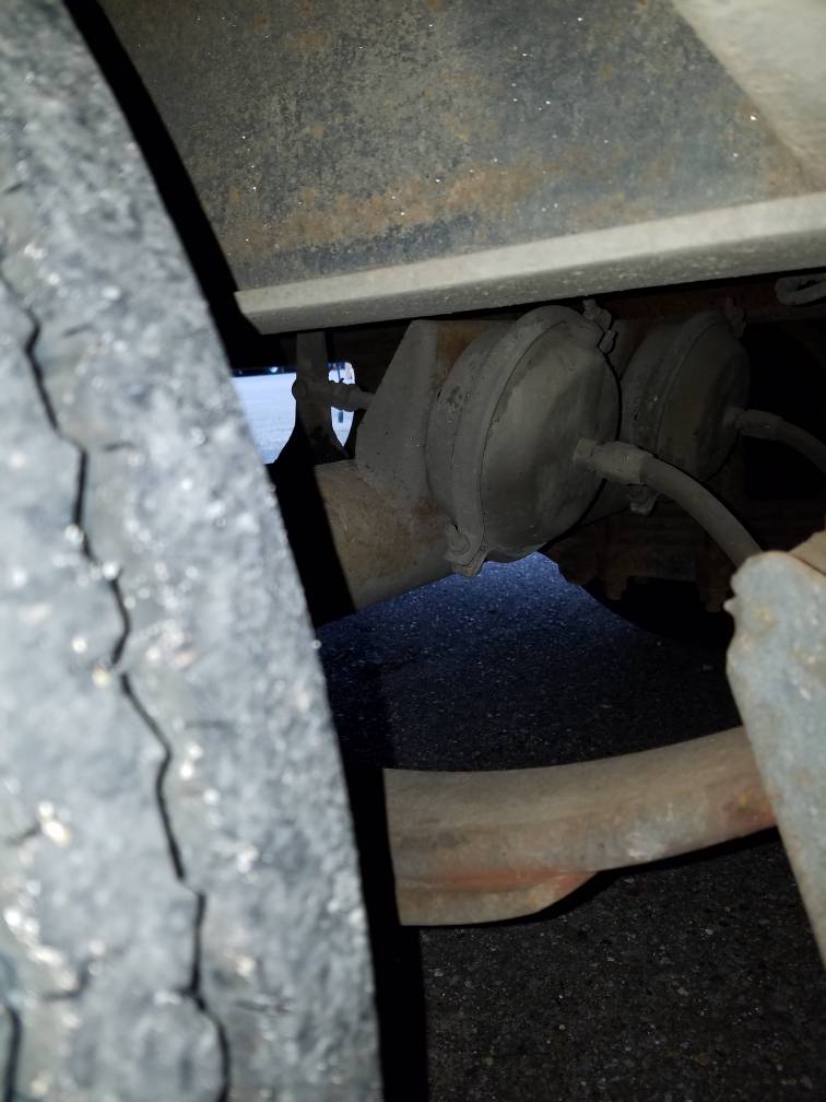

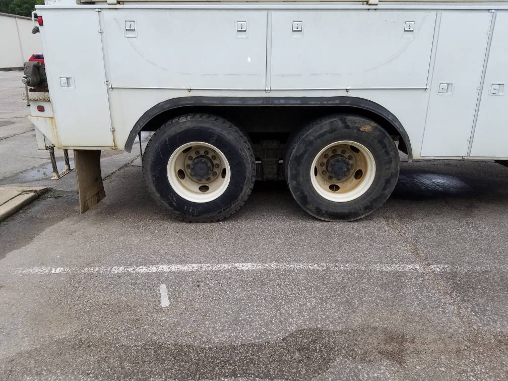

I was wrong this is a international with 2 rear axles it has spring brakes on both rear and just service brakes on front.20180926_173447.jpeg20180926_173510.jpeg20180926_173611.jpeg20180926_173637.jpeg

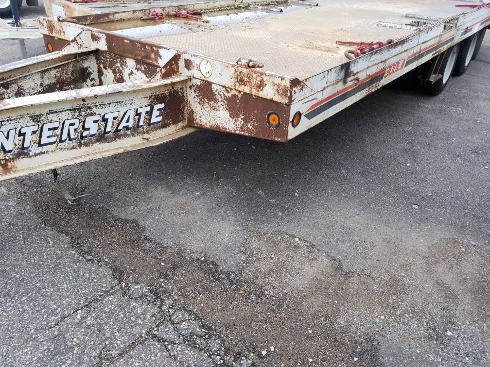

Double axle trailer has 1 axle with spring brakes20180926_173959.jpeg20180926_173944.jpeg20180926_174018.jpeg
