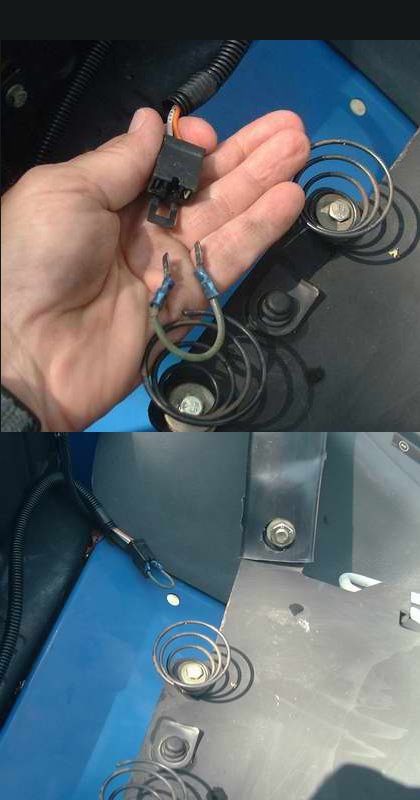

Robert, if your seat is the old type with the switch below the back of the seat, then the picture below is the way to bypass the switch. Just remove the plug and jumper between the sockets. A normal spade connector on each end of a wire works perfectly.

My seat switch went south on my TC35 as well. Actully the button switch closed the circuit so I could start the motor by depressing the button with my finger. The flange on the bottom of the seat apparently no longer put enough pressure on the button to close the circuit. Tried to bend the seat flange down for more pressure on the button but it broke off the seat. Looked like a couple of cheesy spot welds that holds the metal flange onto the bottom of the seat. No worries,I just jumped the plug with a wire as per Jinman. I really do not miss the seat safety switch.

JC, it appears that pins #1 and #3 may do the trick, but I'd like to know where the other white wire goes from pin #4. The function of the PTO safety is to say if the PTO is off and the tractor in neutral with the parking brake set, the operator can get out of the seat. The functions for this are in the operator safety module which must be on another page. Therefore, I would say that to be certain the seat switch is fully bypased, I would remove the connector from the seat and jumper 1 to 3 and also 2 to 4. That's what the switch does when it closes. We should replicate that as closely as possible.
In addition, I would try to make a jumper with pins similar to the ones in the plug like I did with my seat switch in the earlier picture. You want to bypass the switch, but make it so that all you have to do is disconnect the jumpers and plug the switch back in for normal operation. Being able to easily return to a normal configuration might be handy if you are taking your tractor in to have it serviced. If your dealer sees a bypass, he might consider that as putting himself at risk. Returning the switch to normal while the tractor is serviced would be my choice to remove any risk to the dealer's shop.

I try to stay away from making modifications to wiring if possible. I prefer to leave my wiring harnesses completely intact if I can do it. Many plugs fit onto spade style connectors and my preferred method for jumpers is to crimp on spades and insert them into the plug. Other people's preferences and skill levels might make them come up with another satisfactory solution, but I think mine wins the K-I-S-S principle contest.;)
