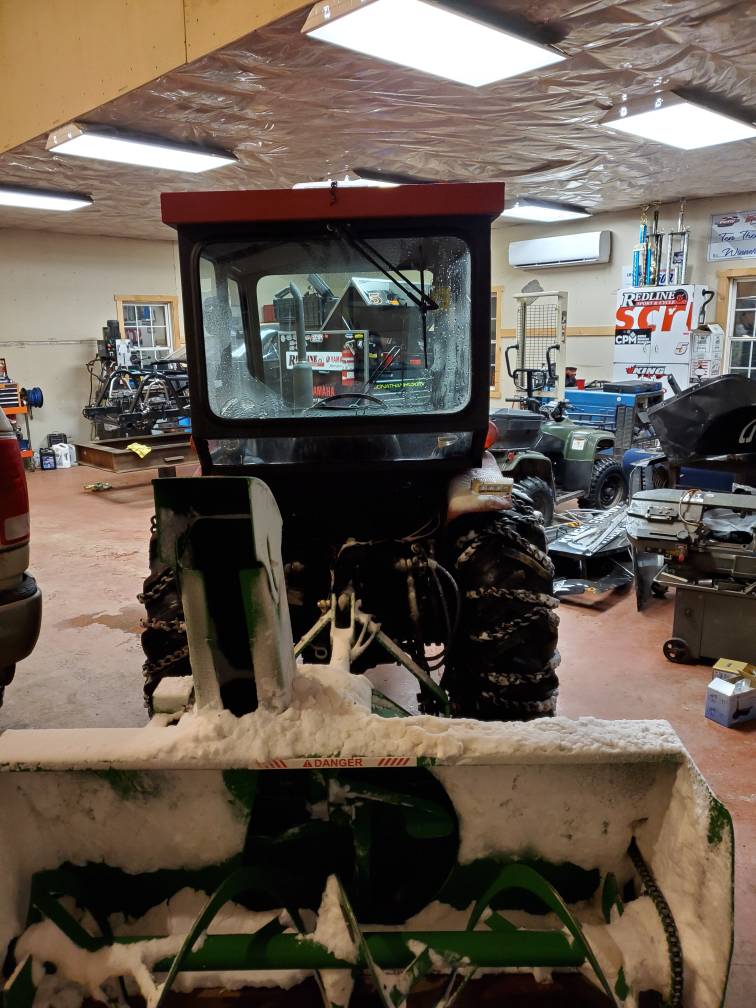

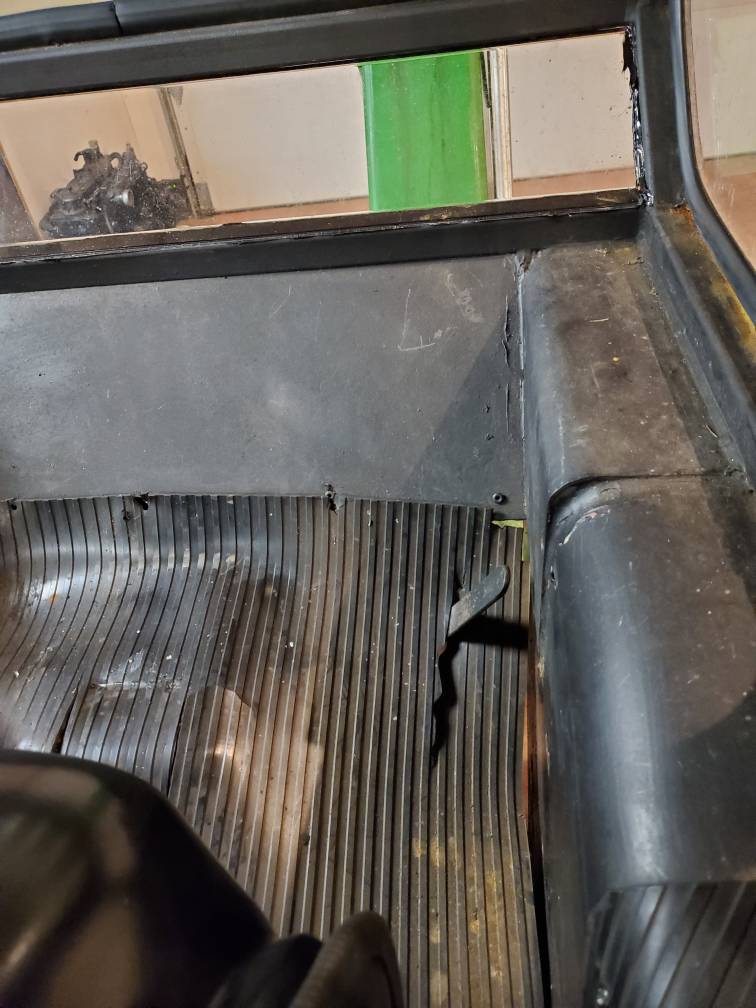

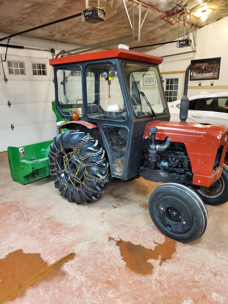

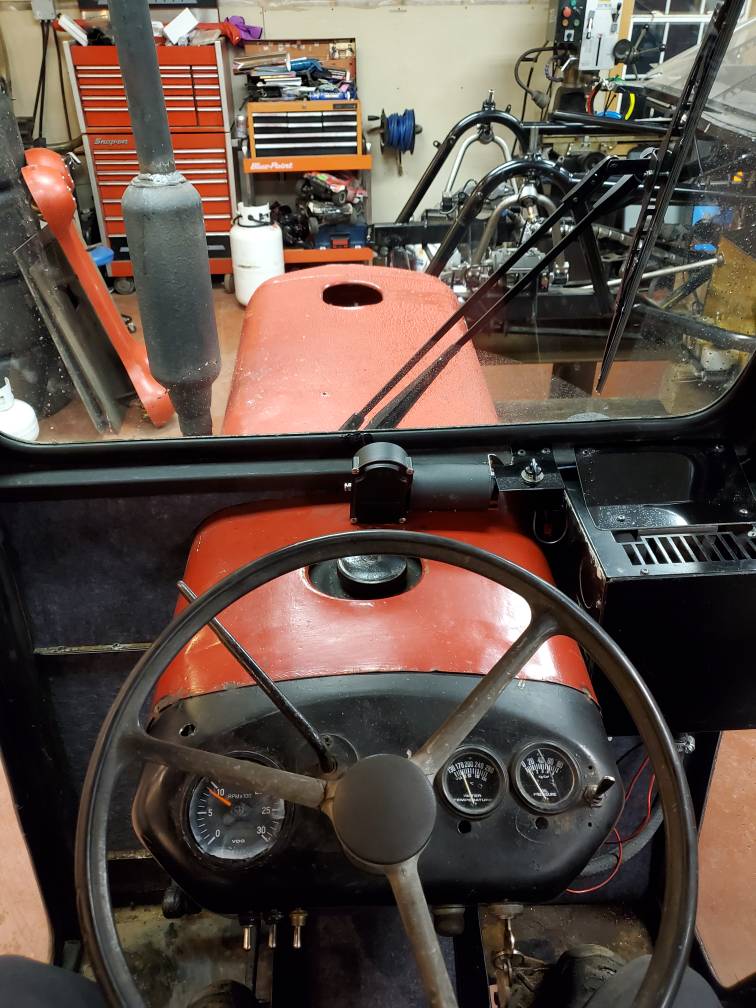

My side windows are made of 1/4" acrylic and the front and rear are safety glass so I can run wipers in it. I will take some pictures tonight and post them. Thanks for the intrest!!
   / satoh S650G engine changeablility ? #32

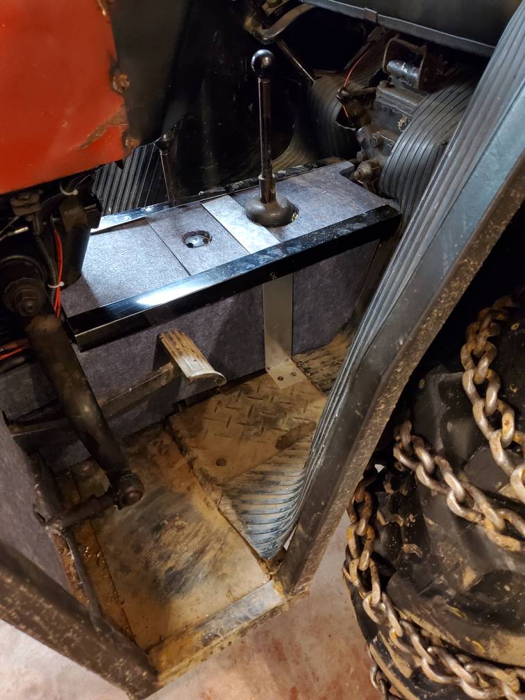

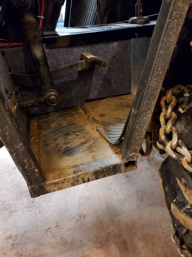

Took more pictures of my cab tonight. I built this myself over quite some time! I started this in December 2014 and just finished this winter. The mounting points are a bolt down through the top of each fender and if you look at the bottom of the cab down by the foot plate there is an open tube. This is bolted under the foot plate. I was going to slide a piece of 1" tube in this hole if I ever needed to remove the cab. I used 3/8 thick sound barrier that i got on Ebay to quiet things down a bit.the tubing is 1 1/4 × 1/8 and the roof is 1/8 plate. I didn't try to save any weight because I wanted to gain some traction anyway. Any other questions or measurements I will be glad to help you out. Screenshot_20200203-212628_Facebook.jpeg20200203_200348.jpeg20200203_210447.jpeg20200203_200511.jpeg20200203_200447.jpeg20200203_200416.jpeg20200203_210645.jpeg
