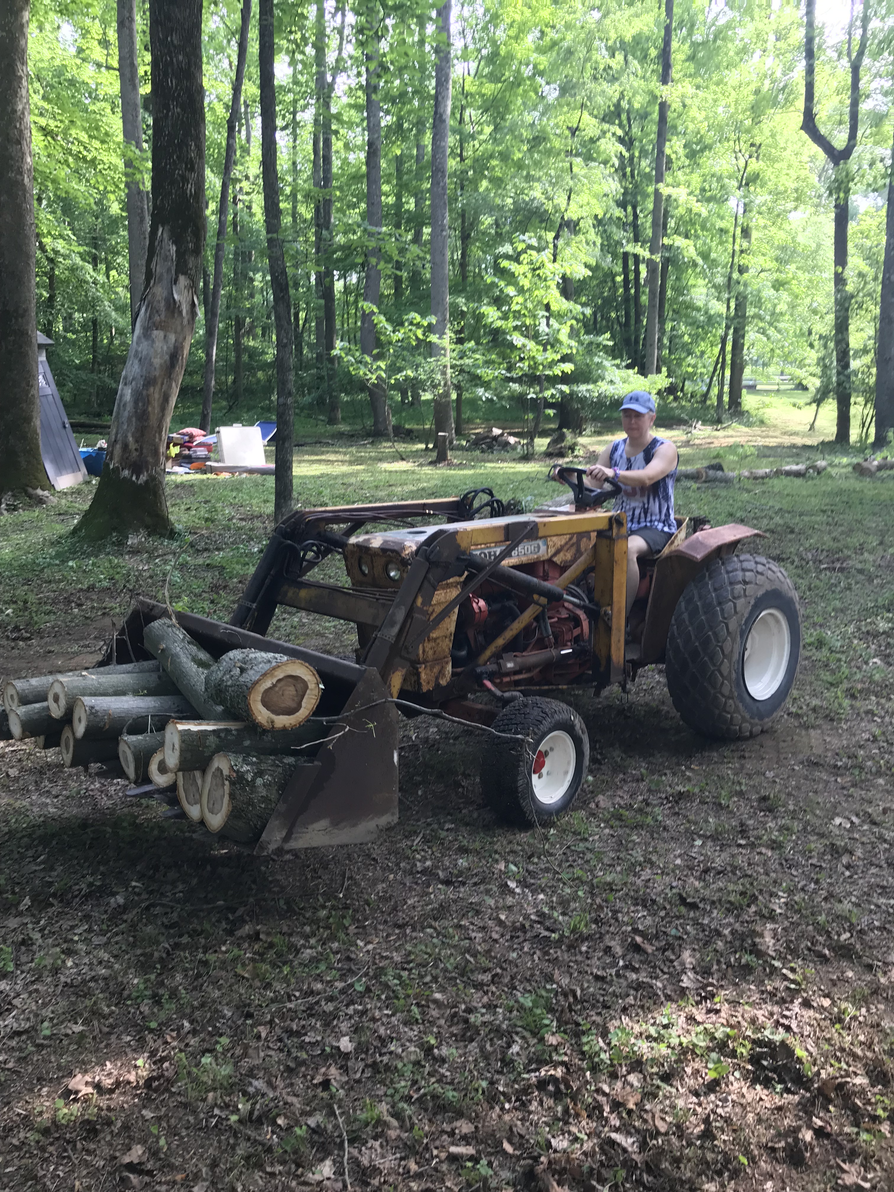

I think mine is mid to late 1970's, red and white, 25 hp engine, national front end loader and 16" rear turf tires. head lights are part of the hood and air-cleaner under the hood Serial number S-650G-400935.

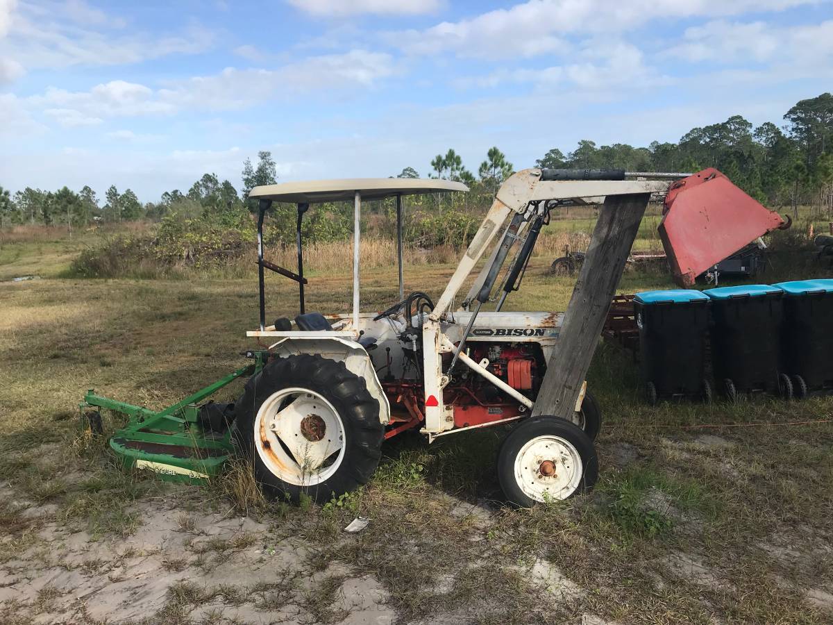

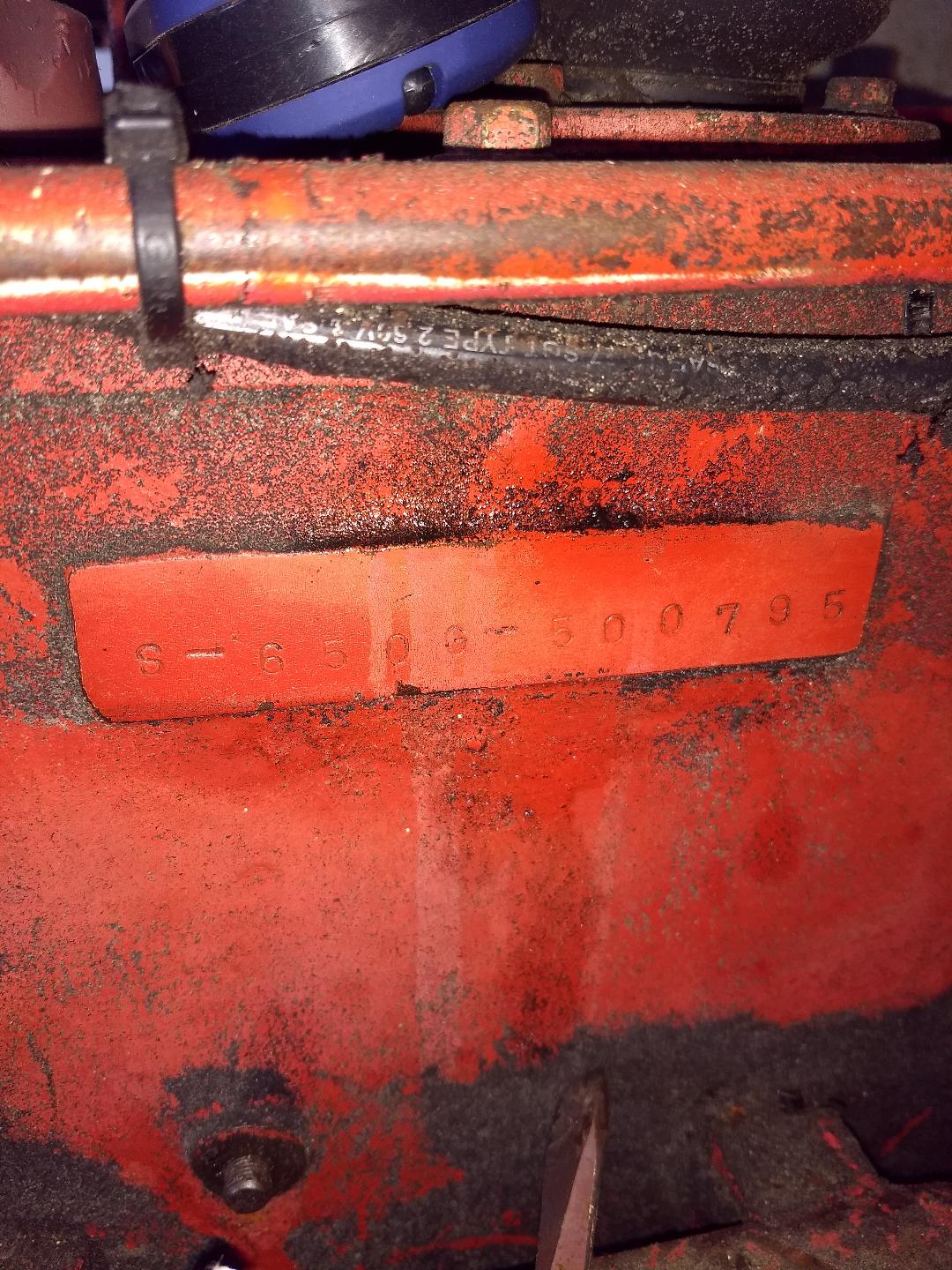

Thanks for the info. I haven't been on here in maybe 7-8 years but always enjoyed the info. I just bought my SatohS650G a couple days ago and it needs lots of work. The wiring harness needs to be replaced which will be a complete rewiring job and putting all new wires in a loom as I am not interested in fully restoring etc. I have about 3 acres of wooded and scrub brush acreage that I want to fiddle with, so I will be working this old beast. It has a heavily built 5' loader that still has part of the decal on it and I believe it is a Blackhawk loader.
My serial number is S-650G-500795 and do not know the age of this tractor.
Does not seem to be much info anywhere on serial numbers even on TractorData.com

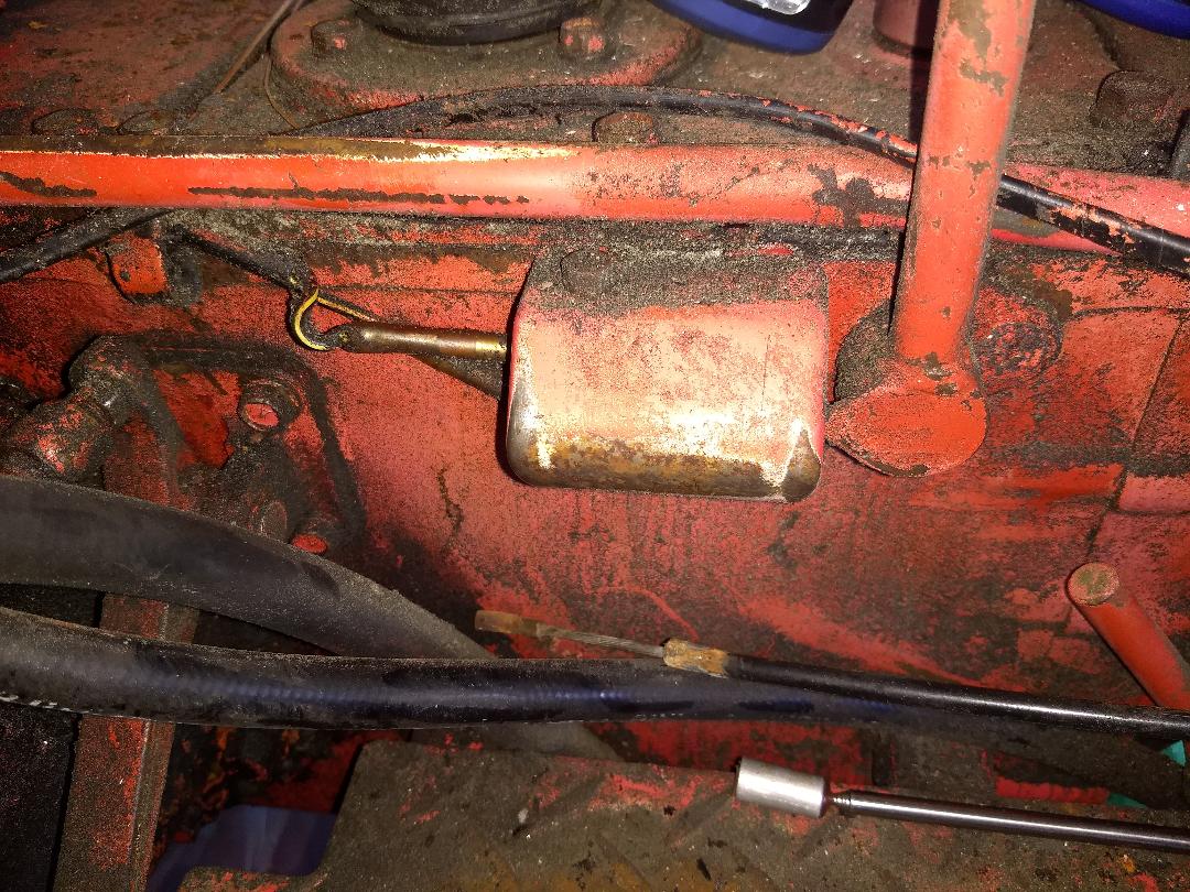

Anyone with a Satoh Bison S650G have a switch activated by the Hi-Low lever? I am rewiring my tractor and the wiring diagram does not show any reference to this switch?
If I cant find any reference to it I may just wire it to a couple indicator lamps to indicate the speed range.

I believe that is the safety lockout switch for the starter. The high/low lever has to be in the middle to start the tractor. Mine has been by-passed.

sharkman62, I believe you are right. I see the "safety starter switch" in the schematic, though I thought it might be referring to a push button starter switch. My tractor has a key switch but no key so they just added a push button to start the engine. Like I say, this tractor has a sloppy wiring job by someone and subsequently shorted out and burned the harness pretty good. But all that birds nest is getting eliminated. If the safety switch is still good, I may wire it back in just to be true to the wiring logic. Thanks for the info.
I am sort of redrawing the schematic to make it easier to wire and troubleshoot in the future. I never liked these line type of drawings and tend to lean toward the hard wired industrial electrical schematics that I apprenticed on years ago. I will post the drawing when I get it done. Thanks again for the info. If we post all our data and what all of us know about the tractors, we can build a data base for the future owners of these old rice burners.

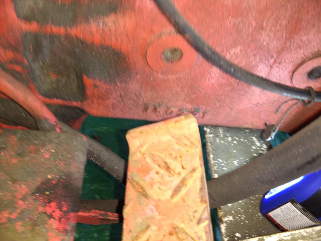

We have a Serial number (stamped on the side of the frame) S-650G-002242, year unknown, that has the side mounted headlights/rear tail light) previous owner painted the entire tractor red. For the last 10 years it's been the garden workhorse, and the garden is an acre and a half.
