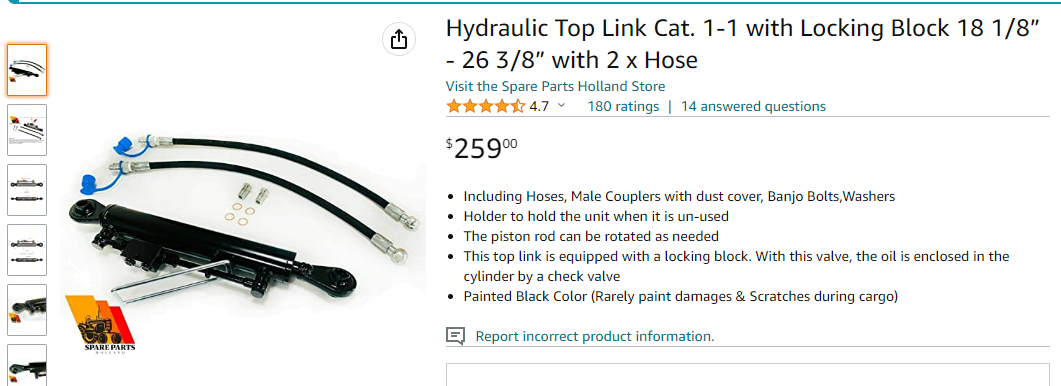

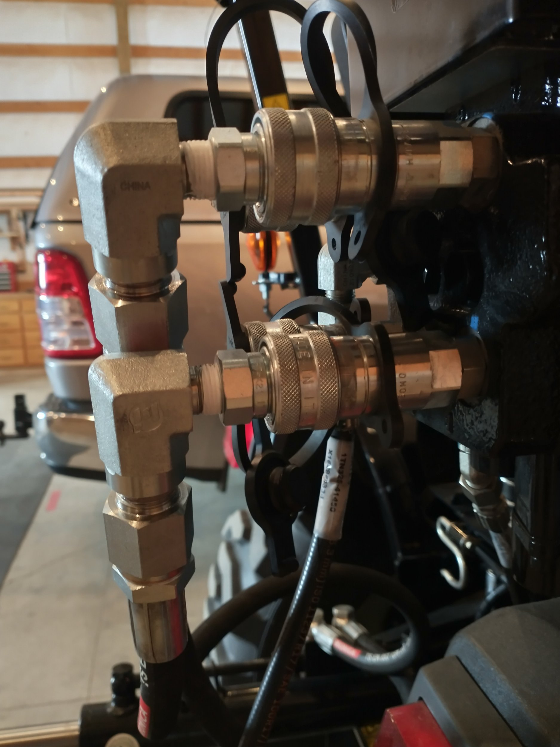

I ordered mine from Amazon...search here for the ones shown here. There are others also. These hose lengths are right for your 425 if you add a 90 degree elbow on the end that goes to the rear remotes.
These come from the Netherlands and it only takes about 3 days for delivery. One thing to know...the fittings are the wrong size for the 425. I had to go to a local hydraulics business to get the correct ones. JUst take one from the rear remote box and a hose with you and get 2 males that fit the new hoses. Its cheaper than changing the females on the rear remotes. You'll have to get a thread adapter to go from a brittish to us thread (the large hex piece below the elbow) and an elbow. Once that's done it works perfectly. Tighten fittings very tight. Good luck
Hydraulic Top Link Cat. 1-1 with Locking Block 20 7/8” - 31 7/8” with 2 x Hose

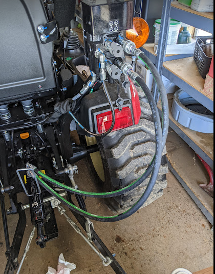

Got mine from https://haytools.com/TNT.htm
He has premade and custom orders, great quality & fast shipping.
I'm going to give them a call Monday.

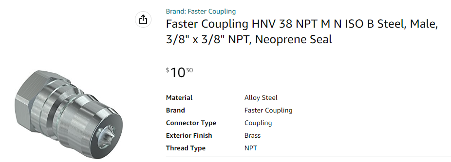

I measured straight line 24" from the middle of the toplink to the outside Female valve connector flat on the ground. Do you know what length hoses you went with? It looks like a HNV-38-12sae male is the correct fitting.

I took the measurement of my screw top link that came with my tractor. My Sc2450 Tractor 3 point hitch is Catagory 1
Measure it all the way in and the way out.
You can add a few inches to to if you think you might need it for different attchments, but I have a landscape rake, flail mower, back blade amd a weight box and everything works well with the lenght of my scew top link, It was never maxed out on either end, so the "BX Kubota" model fit those measurements.
I ordered: CAT I - 14-18" w/check valve- 2" cylinder- "BX Kubota"

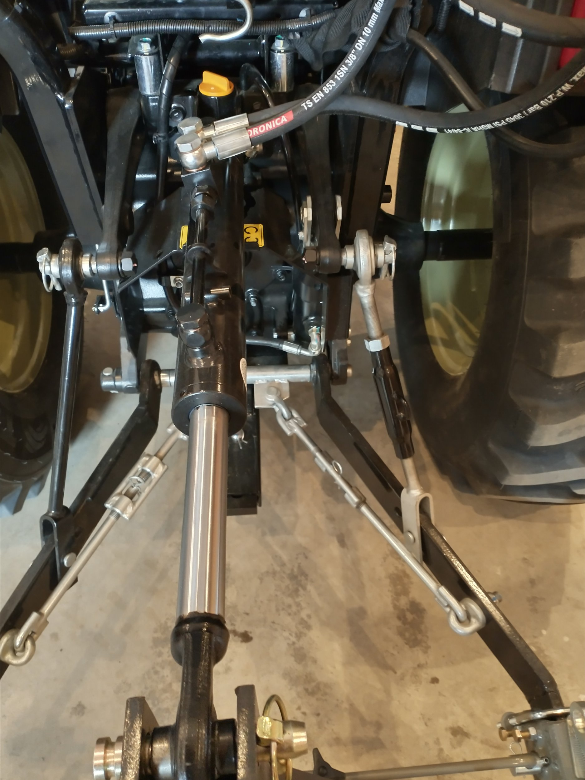

I bought this one and I like it but wish it were a couple inches longer. So far it works for my tiller, my disk, my plow and my land plane. I have not had my box blade on it but that is the tool I think I'm going to need a couple more inches. Also, the hoses on the one I bought are much too short and the fittings are too large.
The hoses are too short, I had to have new ones made up and that cost me $175 so I've got a bunch in it but I wouldn't be without one. The second pic is it installed on my SA425. SA425 has very long three point arms for the size of the tractor.
   / SA 425 Hydraulic Top Link info
My LINK level and on the ground is 26"...so I'd assume a Cat. 1-1 with Locking Block 20 7/8” - 31 7/8” is the correct size.
