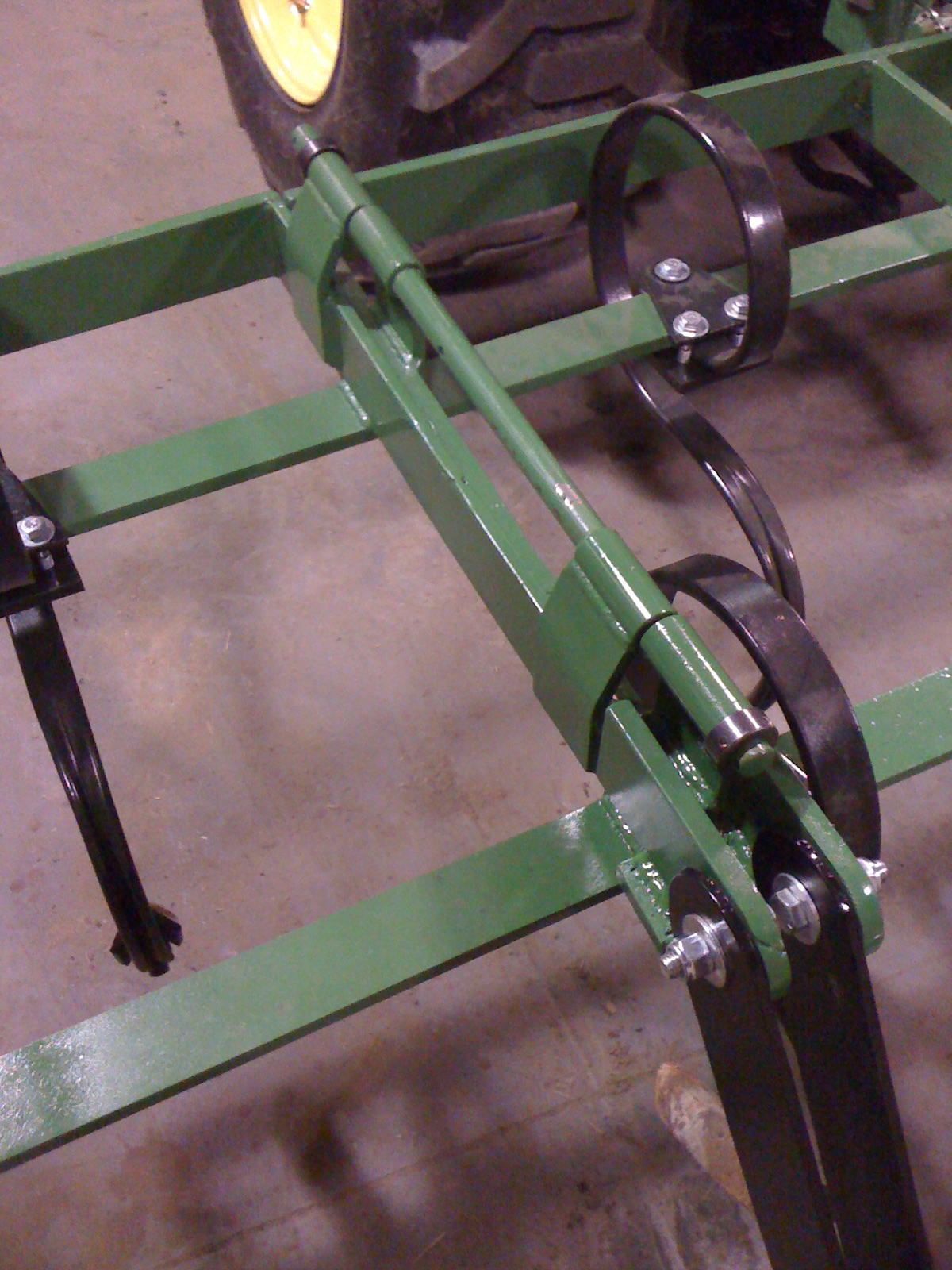

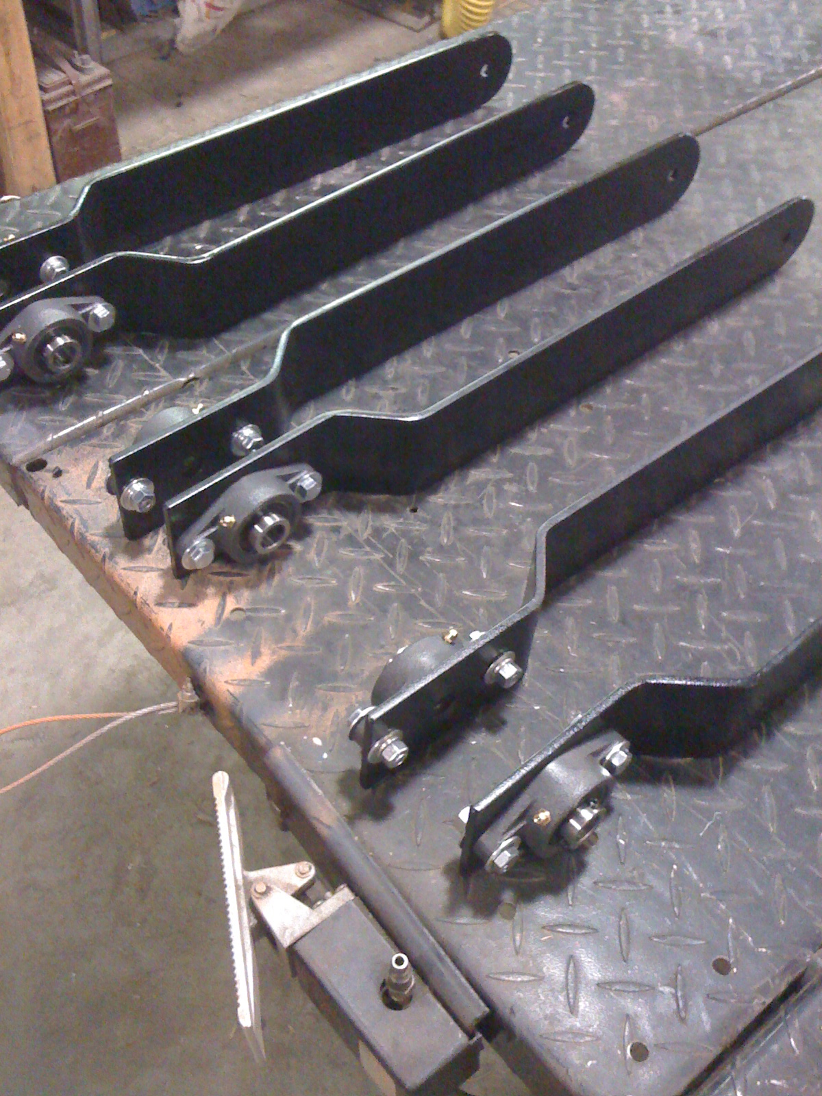

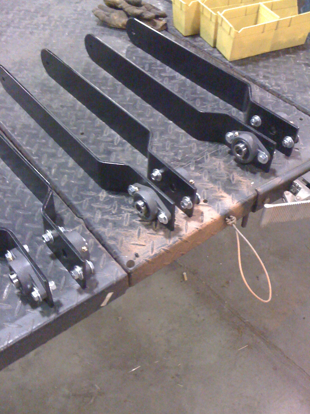

Started some assembly tonite... was almost done painting the rollers when I ran out of paint... figures just my luck, lol But got the bearings bolted on, note the orientation of the grease zerks... all pointing up;);)

   / S-tine cultivator build.... #13
looks good can i live in that shop. having built one similar to that i found that the roller bearing holderoner bars need some side ti side support. the flex in turns at the end of the arena popped the set screws on the pillowblocks. i ended up welding on a chunk of 2 inch angle iron the whole length of the arm .

donais... thanks for the heads up on the roller arms!!!!!
jeff77.... I had my local steel shop plasma torch them out for me, he has a circle cutter jig for his plasma. Works SLICK!!! I went with 1/8" plate at 9" circles.

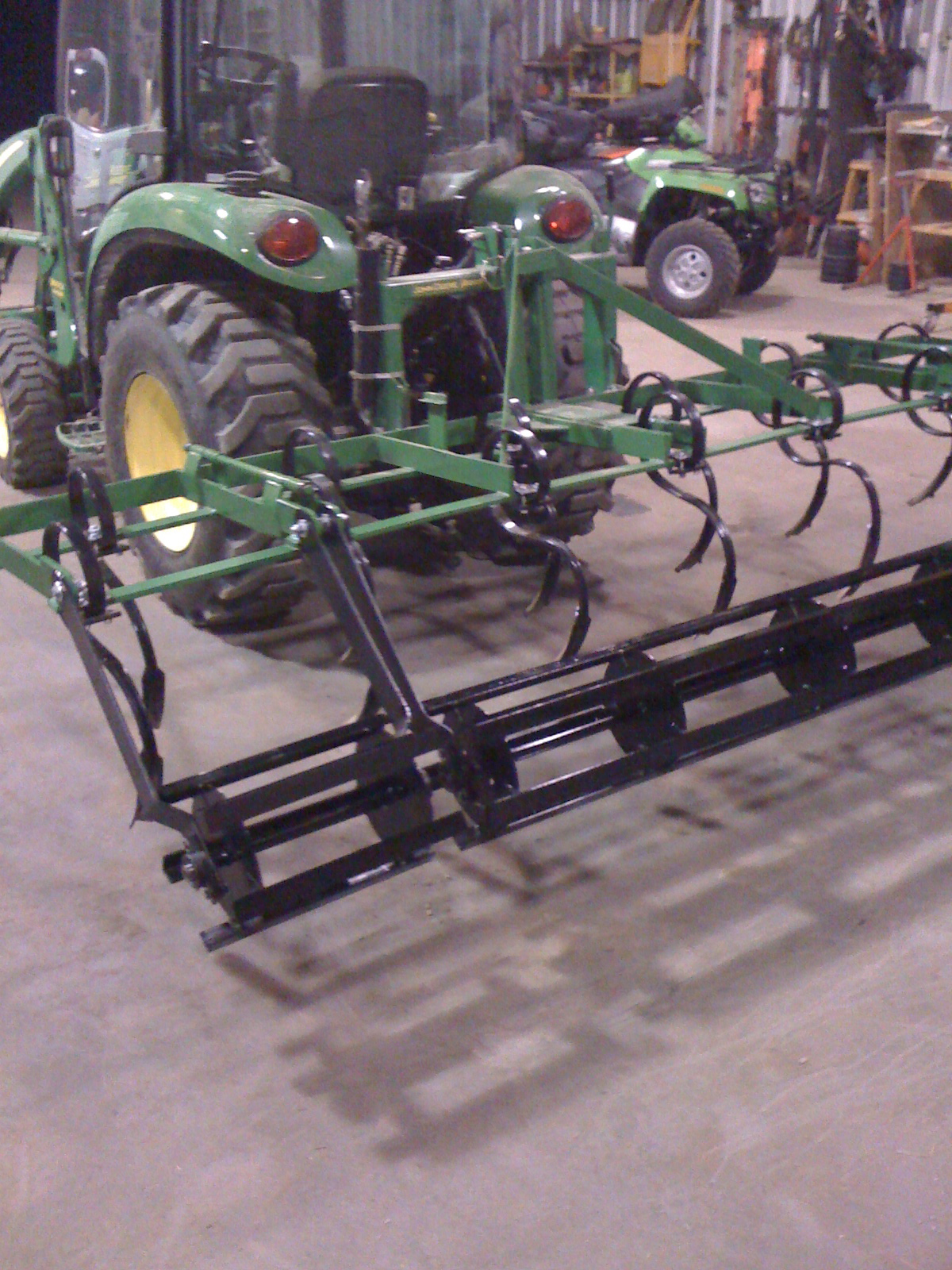

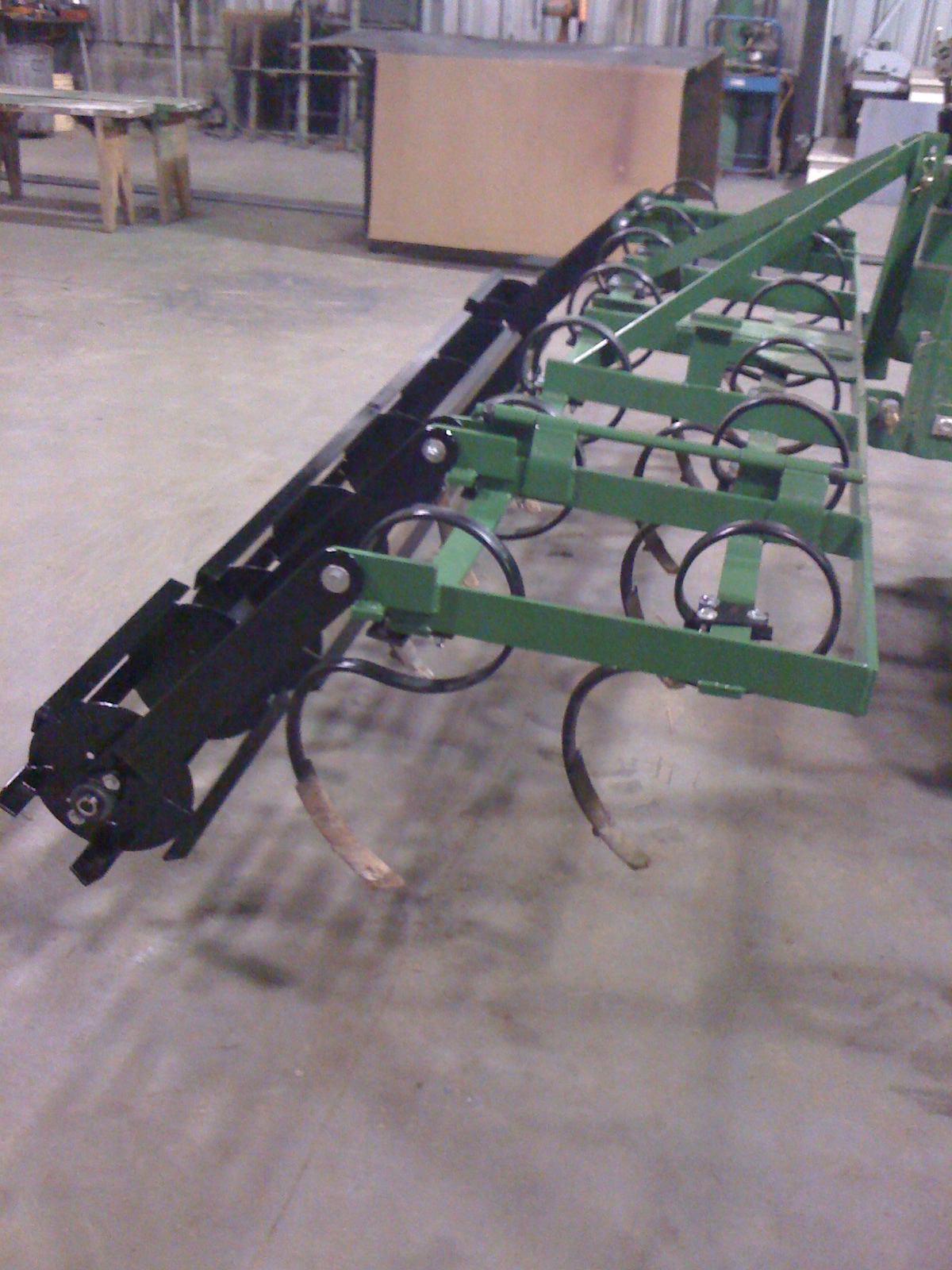

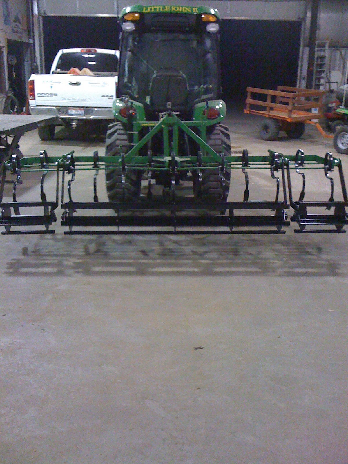

All DONE!!!! Or I hope;) lol...
All I can say is.... I am tickled pink errr "GREEN" over this build!!!!!!!!!! Can't wait to use it now!!
Note the last 2 pics of how I can remove the wings with a simple allen wrench and pull the lock collars and shaft;) That was another "build on the fly" design I came up with.
Thanks again for TBN and some folks for helping me out with the rollers and past pics!!!:drink::drink:

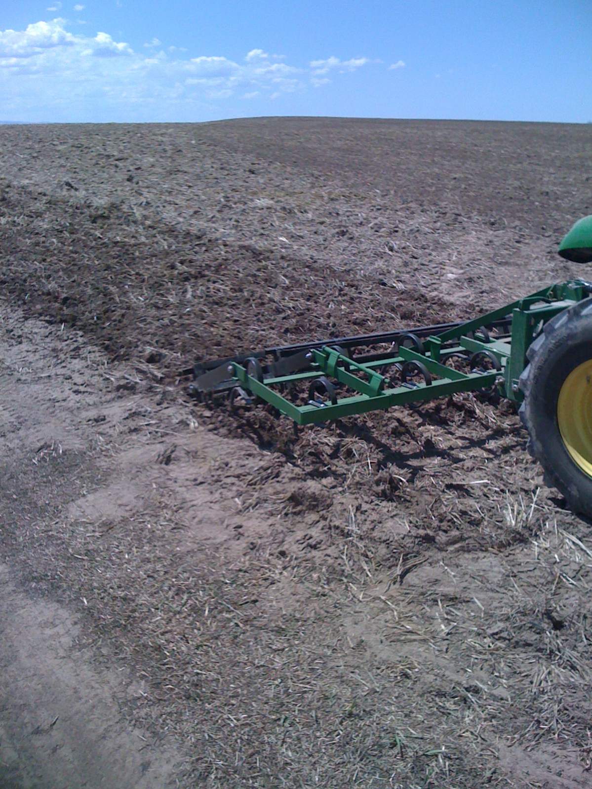

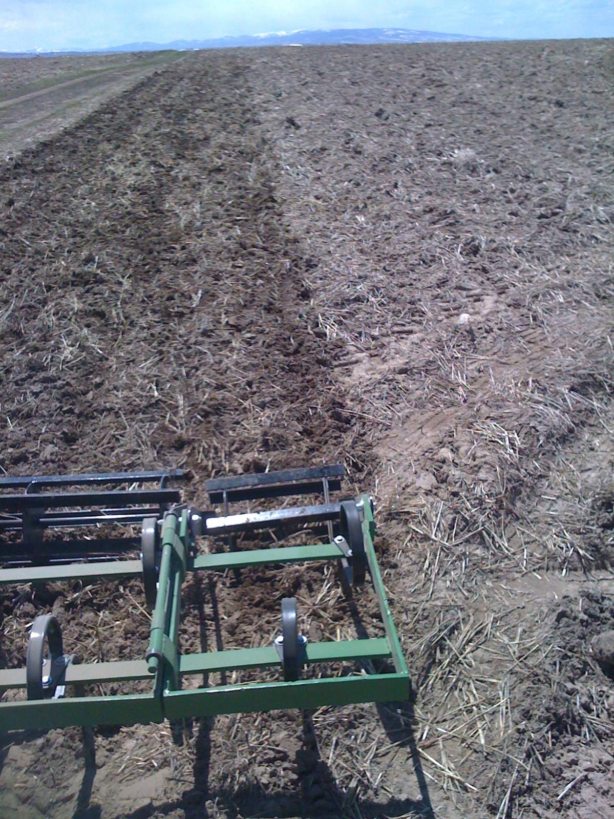

It works!!!!!! lol
