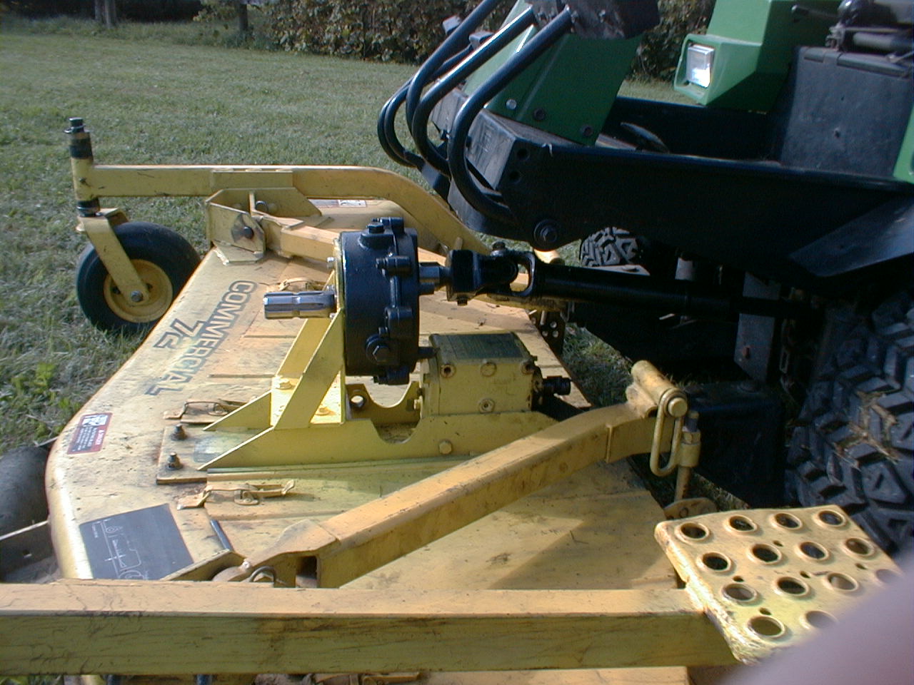

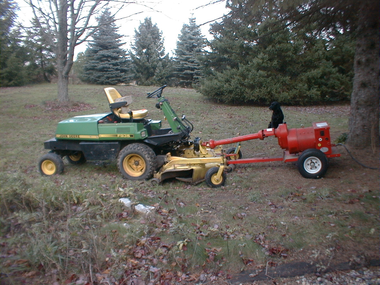

I've run my Winpower 540 pto genny off of my lawnmower's 2000 rpm pto with a gear reducer just fine. With 'direct connect' and the right prop shaft (2 Cardans or a CV joint in there.) it will do just fine. I used a Kill-A-Watt for frequency. Rotation direction didn't matter. Try it, you'll like it ! Hopefully it fits under the tractor so it can tag along to where it's needed.

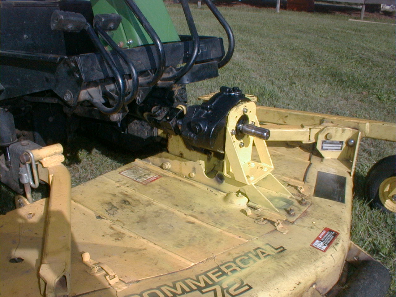

Got it via ebay smooth shaft input, 540 6 spline output, although they stated thast you could run it both ways [input or output]. PIC00016.JPGPIC00076.JPGPIC00077.JPG
   / Running a 1800RPM Generator off of Boomer 2000 RPM mid PTO ? #15
Nice clean set up you have put together!
Too bad you need to first slow the input down, only to again speed it up at the Winco.
But, It all makes sense and looks like it works a treat! I've seen those reducers/speeders as well. Never bought one though.

It looks like a Hub City model. This one had the 6 spline 540 shaft end on it already. I'd estimate it is good for 65 hp or more. Its a heavy unit. However in your case, you only need a 1:1 connection,eh ? 2000 --> 1800 is close enough. Just throttle down until you get 60 Hz.
Seems like some sort of flex coupling with the right bracket could be fabricated to mount your genny and shaft drive it.
