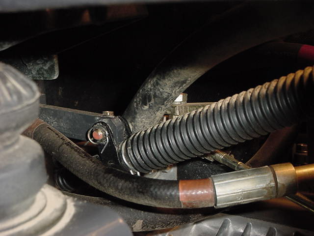

I am confused on the linkage with all the going back and forth on the old and new parts. Someone tell me if this is correct:
Old, abrupt stop - damper should be in top hole
New, smoother stop - damper should be in second hole

Sorry about the confusion.
Yes, Old = abrupt stop.
The speed control assembly part is the steel piece that has all the linkages attached.
The damper is the piece that goes rearward and bolts somewhere towards the back (sorry about the vague description but I haven't looked at it in awhile. It's pictured a couple times in this thread.
</font><font color="blue" class="small">( Old, abrupt stop - damper should be in top hole
New, smoother stop - damper should be in second hole)</font>
The damper (and all linkages) go in the same spot (holes) regardless of which speed control assembly is in place. For the "old" style assembly, the damper should be mounted above the mounting bracket where it attaches in the rear. For the new style damper, it should be slung under the rear mount.
Hope this makes sense...
Brian
PS. Attached is a pic of the rear mounting of the damper. Notice it's slung under the mounting bracket so this pic was taken when the "new" style (non-abrupt stop) assembly was in place.
