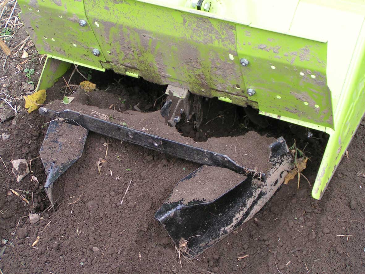

My garden is too small to use a tractor... Got 5 h.p. front tine tiller, and I'm thinking: If I add 2 angled disks on the shaft will it make rows? Anybody tried that? Hate to use a shovel and rake. Other options for building beds?

Hi! May be you can make a hoe for connect with the rear drag pin (deep control device). Here a pic of mine behind my Grillo tiller. Good Luck! Oldmech

I ended up by mounting a furrower (from middlebuster) to the rear drug pin and made it adjustable. It works!
   / Row bedder for small garden #5
Our front tine tiller came with a furrow attachment that mounted the same way.

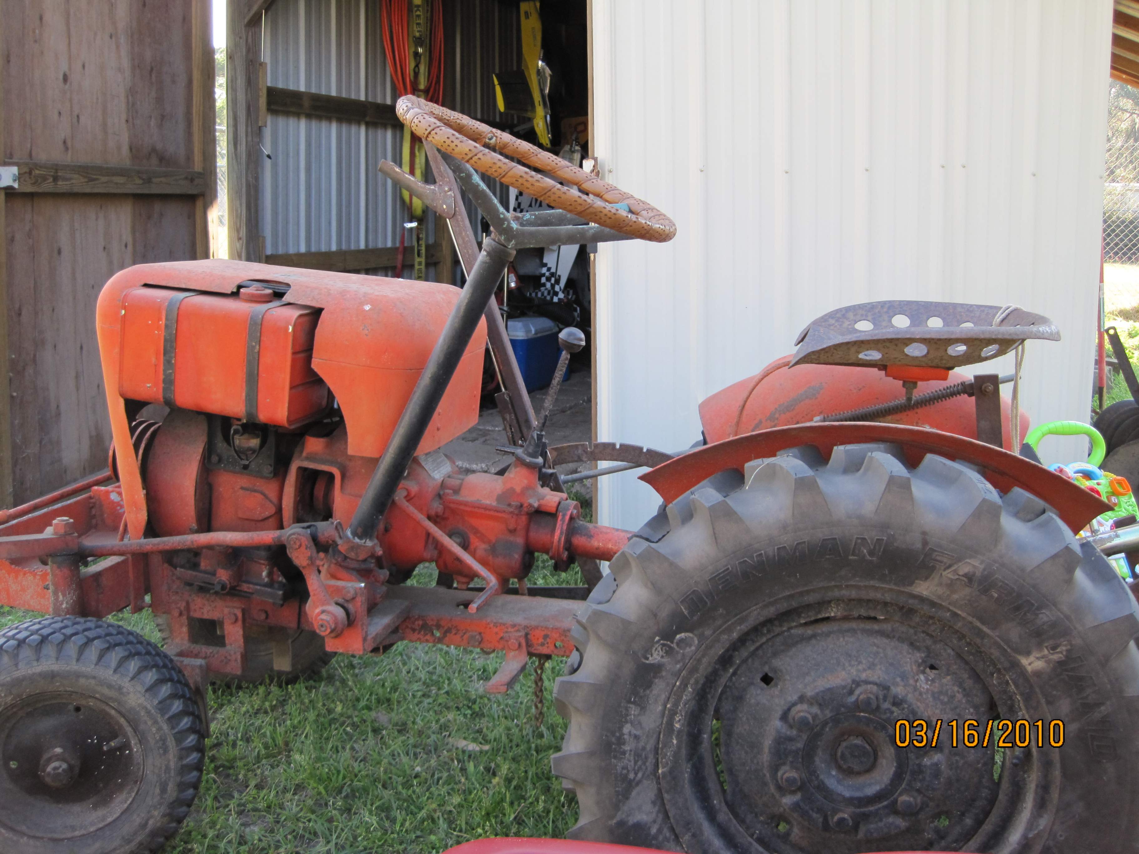

you just need a smaller tractor...:D
